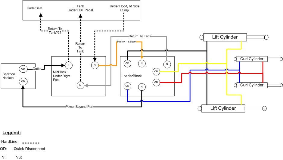

Ok, here is the deal. I can't decide on the new Woods 80x or just putting a subframe on my existing 7500. Is the pump a better way to go or figure out a way to plumb it in to the tractor? Nobody even the dealers seem to know how to do it around here! What do I have to do to run hyd. to the backhoe out back. Price is 6K no pump with subframe, 12", good deal? Is it hard to do myself? I need help, pics and drawings!

Kubota has the hydraulic kit that runs from the loader valve (power beyond) to the top of the back axle then there's a hose that runs from the hydraulic block under the R/H step to same spot on axle.
One of the hoses will have a male QD and the other will be female, they connect together when BH is not connected so the rest of the hydraulics on tractor will function.
Here is a thread with pictures of my set up.
http://www.tractorbynet.com/forums/.../111393-anybody-have-l2800-l3400-remotes.html

Got to this thread there is a drawing Bigballer posted.
   / L2800 backhoe hook ups- 80X or 7500 #5
this picture will show you exactly how the ports are connected for the backhoe which the dealer installed.
this is an updated copy i put together yesterday (updates thanks to wushaws feedback) - I am still unclear about the first dotted line (hard line) that runs from the block under the r/h foot rest.. i need to look a bit closer at the tractor to make sure that line is represented correctly on the drawing..
