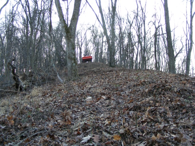

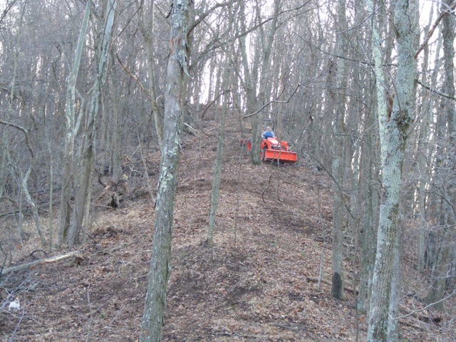

I have a L4400 HST with a703A FEL and my property sounds a lot like yours. I have the rear Ag tires loaded and set out as far as they will go(72" outside of the tire to outside of the other tire). I have a tooth bar on the FEL and I have been satisfied with the performance of the tractor so far. I do not have a BH.I have attached a few pics of some hill work.
