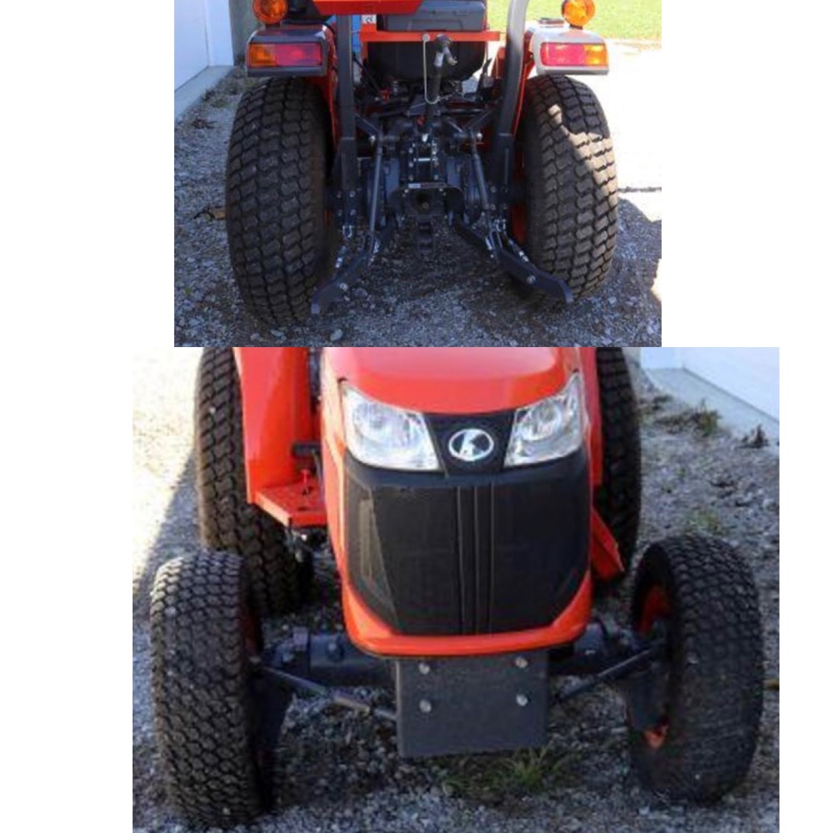

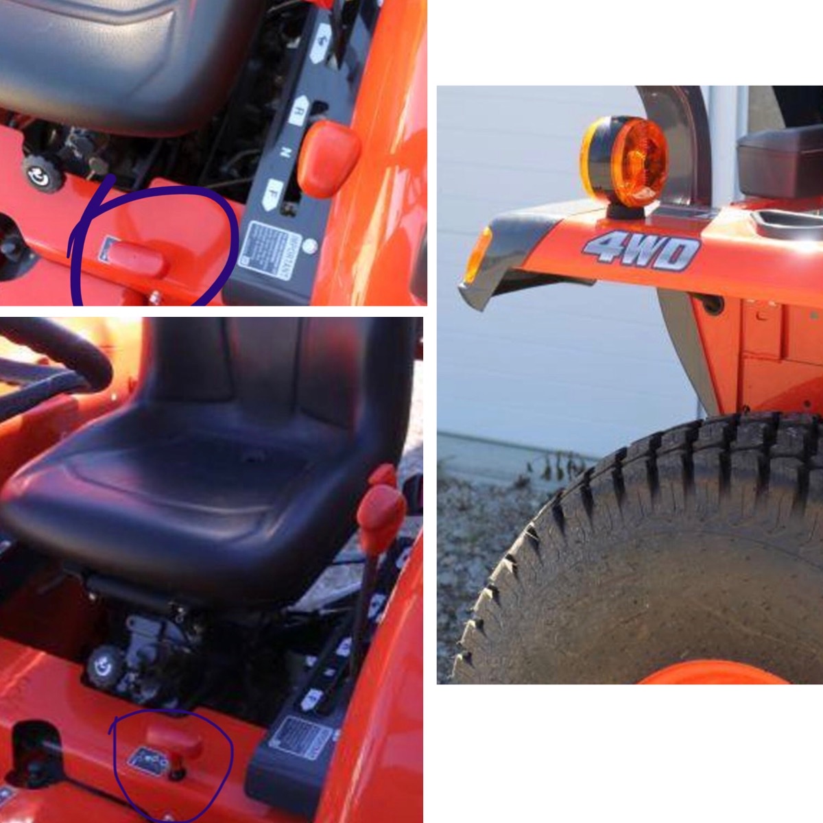

FYI: I had to crop the pics together in order to post pictures here.
It shows all the signs of being 4wd. I haven’t looked at it yet but there is chance I’ll get it cheap enough that I could buy a loader from a dealer and still be better off vs buying new. I’ll just have to see. Being it has no loader, has turf tires and is a gear tractor, I would think that will slow a lot of buyers. If I do buy it, I’ll use 3pt until it’s paid off and I can buy a loader.

When you look at it see if it has the front suitcase bracket. You’ll need weight on the front for heavy 3pt lifts.

Looks like a negatory on front brackets or guard, also I see no rear remote and looks like it has the cheaper turnbuckles.

It’s the economy model Kubota. No bells or whistles. I had an L3400 and an L2501. Both tractors were geared and bulletproof.
Too bad your so far away, I have the bracket and 7) 55# suitcase weights piled up outside my shop.

Seems to be 4wd, but that is definitely a syncro-shuttle shifter in the photo....nice fingertip forward/reverse shuttle. Excellent transmission; bulletproof and convenient. Turf tires are the more expensive tire/wheel option. You probably won't have any problem swapping them as they are premium....but I'd give them a try first. I like the way they work myself, and like the extra side-hill stability.

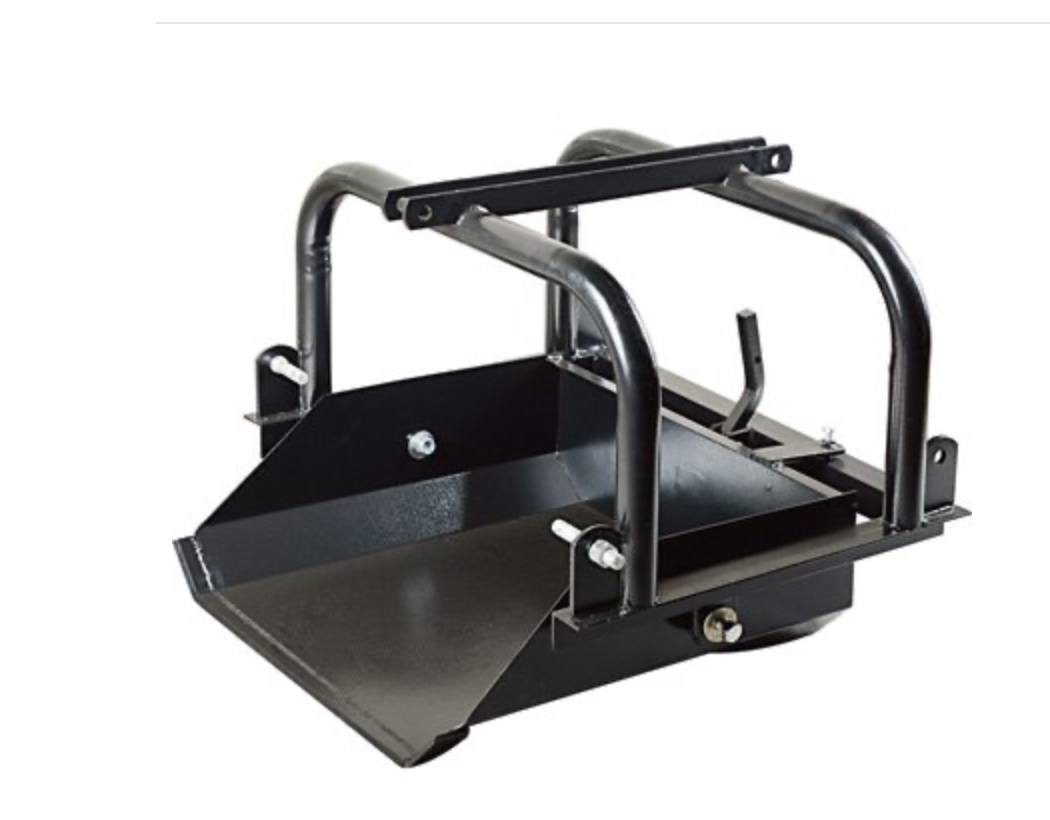

Several companies still make a three point dump&loader for that size tractor. They used to be more common. Should be able to find a good used one, as nobody uses them now that FELs are so popular. They aren't expensive. Here's a photo.

I just sold my old dirt scoop for $100.

I found that the L2501 is a regular gear transmission. The L3301, L3901 & L4701 is synchronized shuttle.
L2501 is 8 forward and 4 reverse gears.
L3301-L4701 is 8 forward and 8 reverse gears.
I saw a video of a geared L2501 and it was totally different lay out which got me looking into it deeper.
