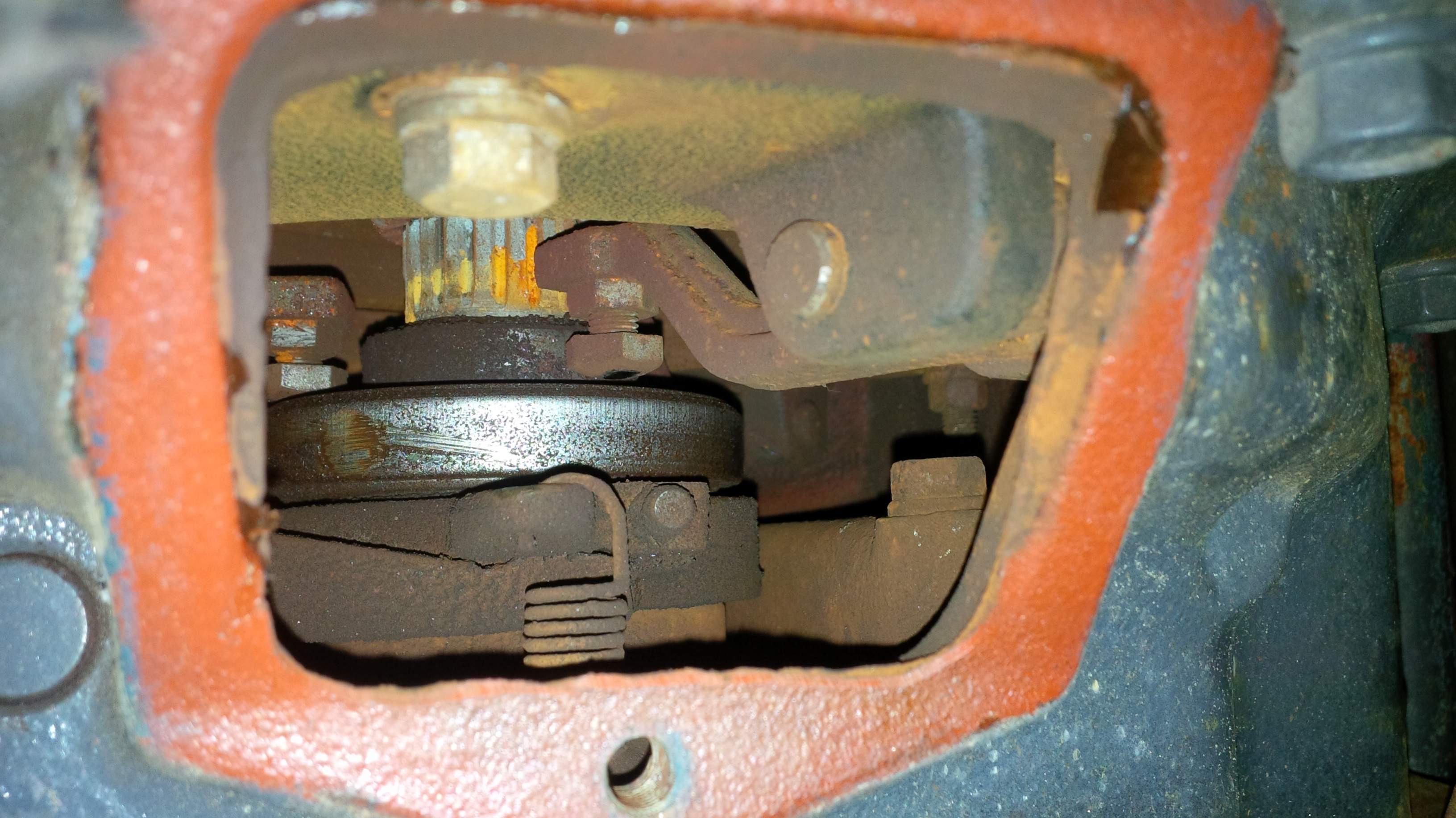

   / l235dt, all fluids changed now clutch pedal won't engage for pto
OK, my sight plate is not hidden by the mounts. I removed it, and here is what I see.
Btw, the picture needs to be rotated clockwise 90 to be the correct orientation.
Any thoughts/comments on what you see?
   / l235dt, all fluids changed now clutch pedal won't engage for pto #9
It looks like the pedal linkage is adjusted too far out. Two of the 3 release levers show in the picture - the bolt heads should be nearly in contact with the release bearing (the shiny ring) but there's a big gap. First thing to do is adjust the pedal linkage so the gap is small - like 1/16". That should make about 1" of pedal travel before the bolt heads contact the bearing.
If the PTO still won't disengage, reduce the clearance even more - until it's the thickness of paper. See if the pto will release then. Watch what's moving in there while the clutch pedal moves - you'll see what's needed.

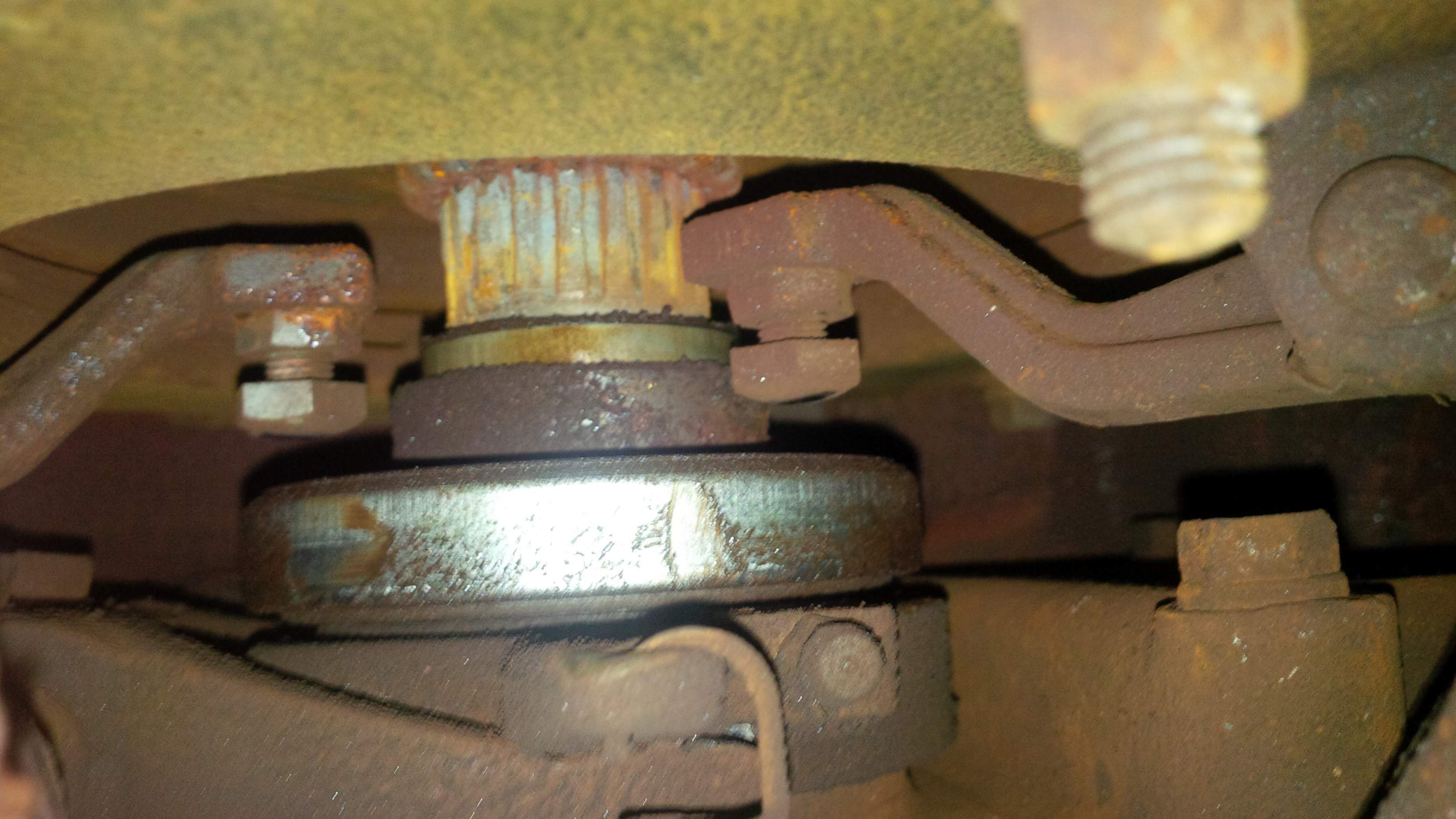

I adjusted the clutch play, it is now less than one inch.
The gap is much smaller, but it is not close to touching.
I'm beginning to think that the clutch never worked...and when I tested the pto, I didn't put a load on it..
Any ways, I will continue the adjustment to see if I can get it working.IMG_20140617_164912.jpg
