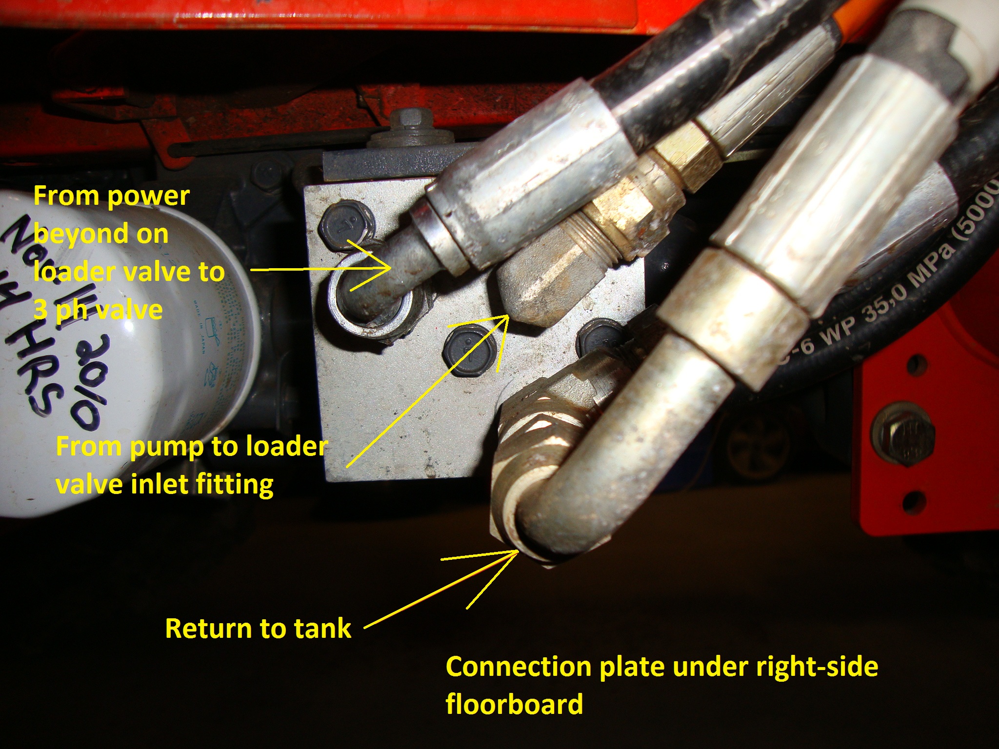

You could call the pump flow through the hyd block PB as it can handle the pressure and feeds other valves downstream.
Different tractors do it differently, On some tractors, the pump directly feeds the loader valve.
On others, the pump fluid goes to a hyd block and then to the loader valve, and then the PB out from the loader valve will feed back to the hyd block.
On some hyd blocks, you have to replace the blank cover plate with an adapter plate that will feed the fluid to the remote or 3pt.
If you have a 4 in 1 bucket, that just uses another spool for the operation.
As long as all the valves are in series, you should have flow. The first valve to get the fluid has priority.
This is a pic of a Kubotahyd block.
