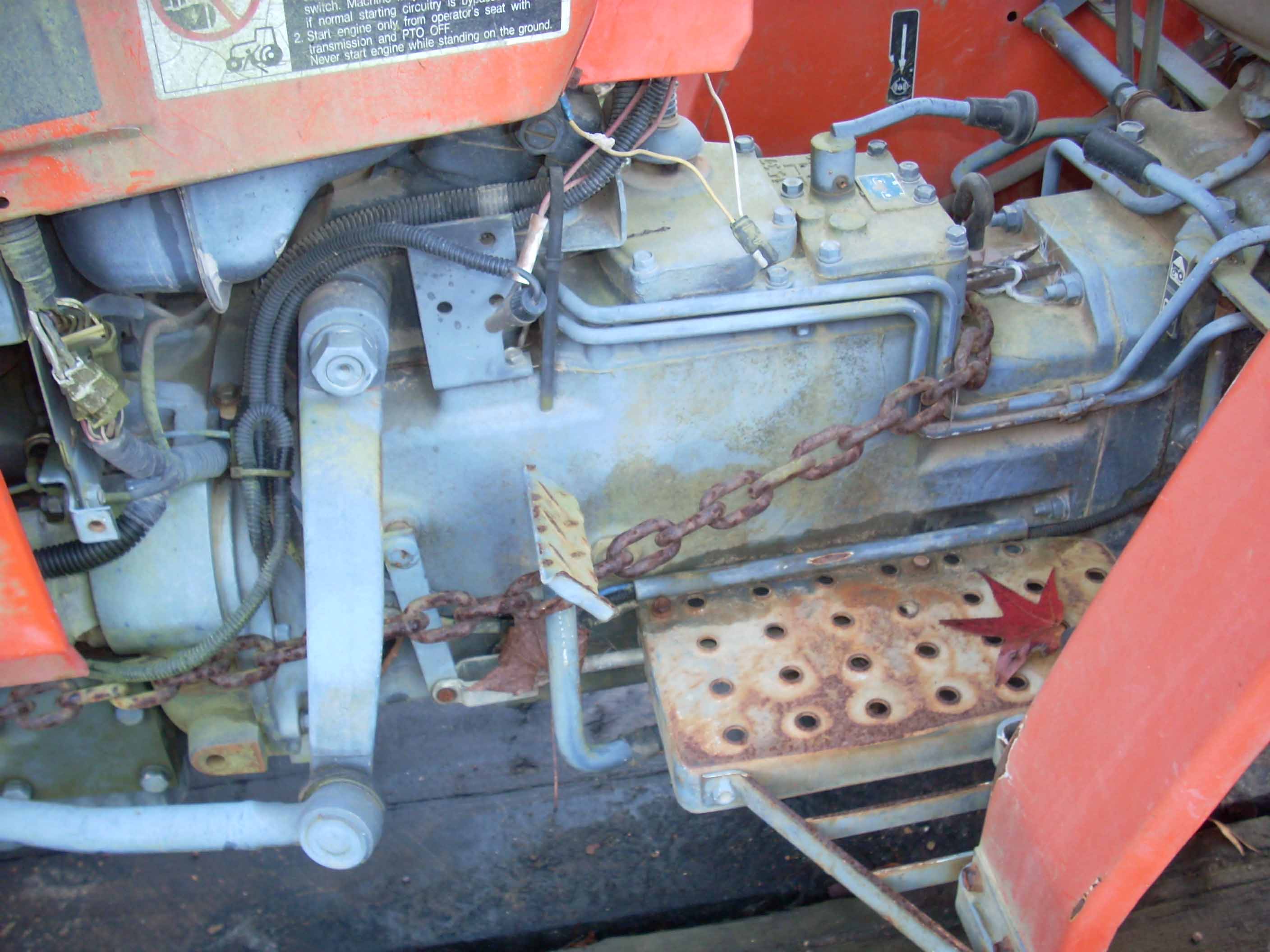

The crack is complete - 360 degrees - a vertical ring spaced about 2 inches from the front face of the bell housing/tranny. Pic later. The solution is another case with or without the guts inside. Nothing else wrong with the tranny - about 540 hours on the beastie.
Weld is not considered viable with the tranny also being the structure and being a 4 wheel drive and add the bucket to boot.
   / L2350 BROKEN BELL HOUSING
ok - pics
LEFT SIDE has a steering arm dropping down that covers the crack area except where the chain passes under you can see a hole.
RIGHT SIDE has the crack also covered mostly - but an area just forward of a visible access hole is where the crack is. The chain passes near the oil filter with the filter covering the crack area.
The crack is forward of the "wet" or oil filled tranny and is actually through the bell housing area. The chain keeps the structure together at this time.
Looking for forward half of tranny or the case.:(

   / L2350 BROKEN BELL HOUSING #8
Here's a Tractor House Listing for L2350 - Mid-South Salvage and West Kentucky Tractor Parts both list this model. Several other models should interchange.
When you put it back together pay extra attention to how the loader frame is attached - the reinforcement through the middle is very important on these Kubota models.
