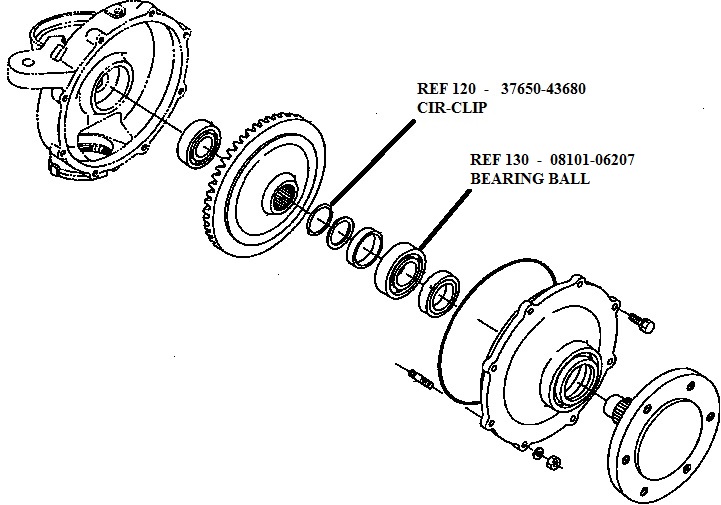

Need help with the removal of the bearing in the front axle on a Kubota L2250DL. I had to remove both right and left axle assembles, and am now trying to remove the bearing (REF #130), form the axel housing. It is held in with a split circular ring (REF#120). I can't figure out to get the split ring out, short of getting my dremel out and cutting it. Any ideas on what tools needed or how to get it out?

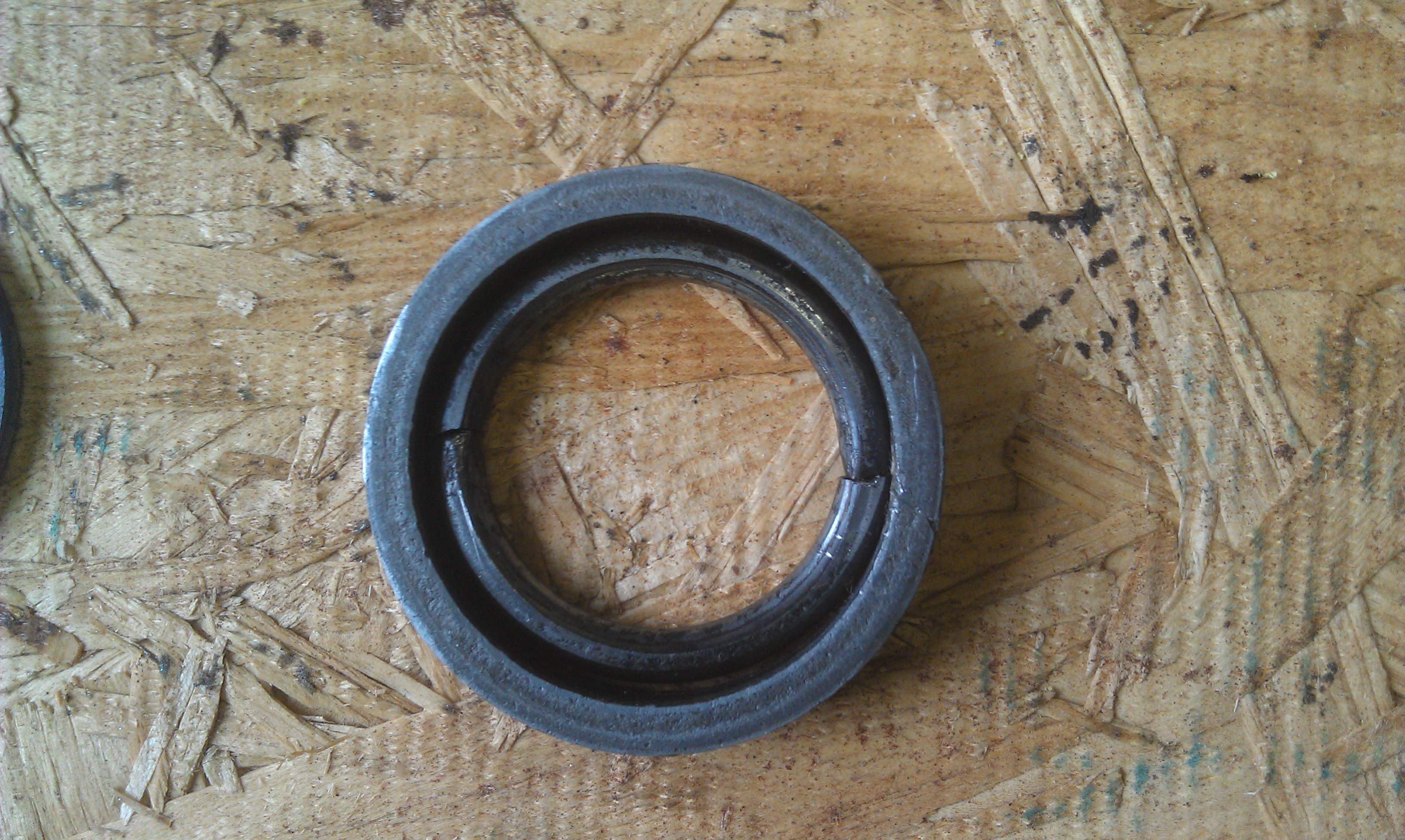

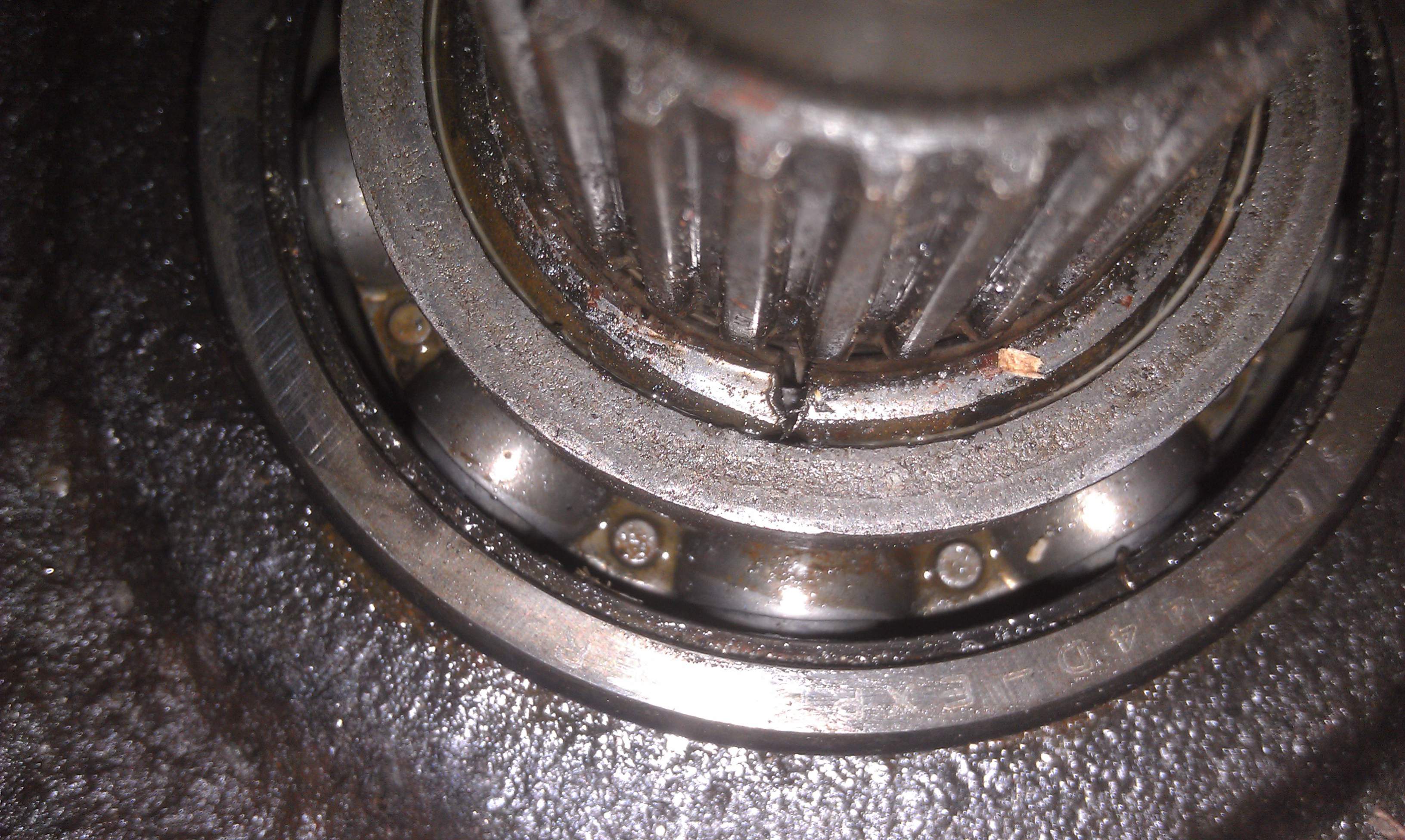

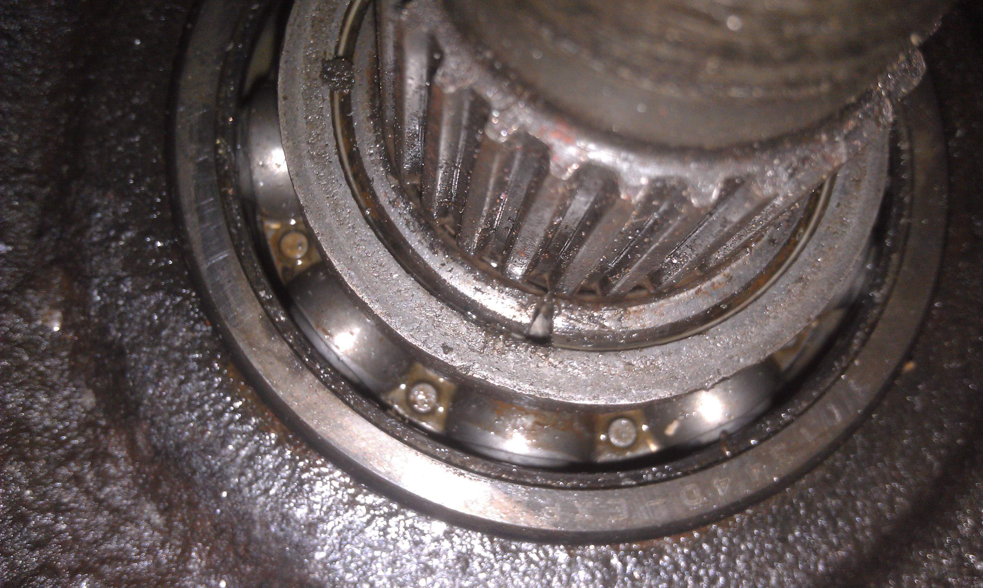

There is a gap of about 1/32 between the split ring halves. I have already broken two small screwdriver tips trying to pry it out. I tried to open up one of the gaps to try to use something a bit bigger but the ring won't budge. I'm at a loss. The dremel is looking better and better the more I work on this thing.

Put the dremel down............... It can be disassembled.
The pic looks like you may have to press the bearing on to free it.

You never did answer if the gear was counter bored to retain the clips????
Something is counter bored to retain them. I am assuming you are doing this due to failed bearings????
Oh, cutting it will not help as it is already in 2 pieces...........

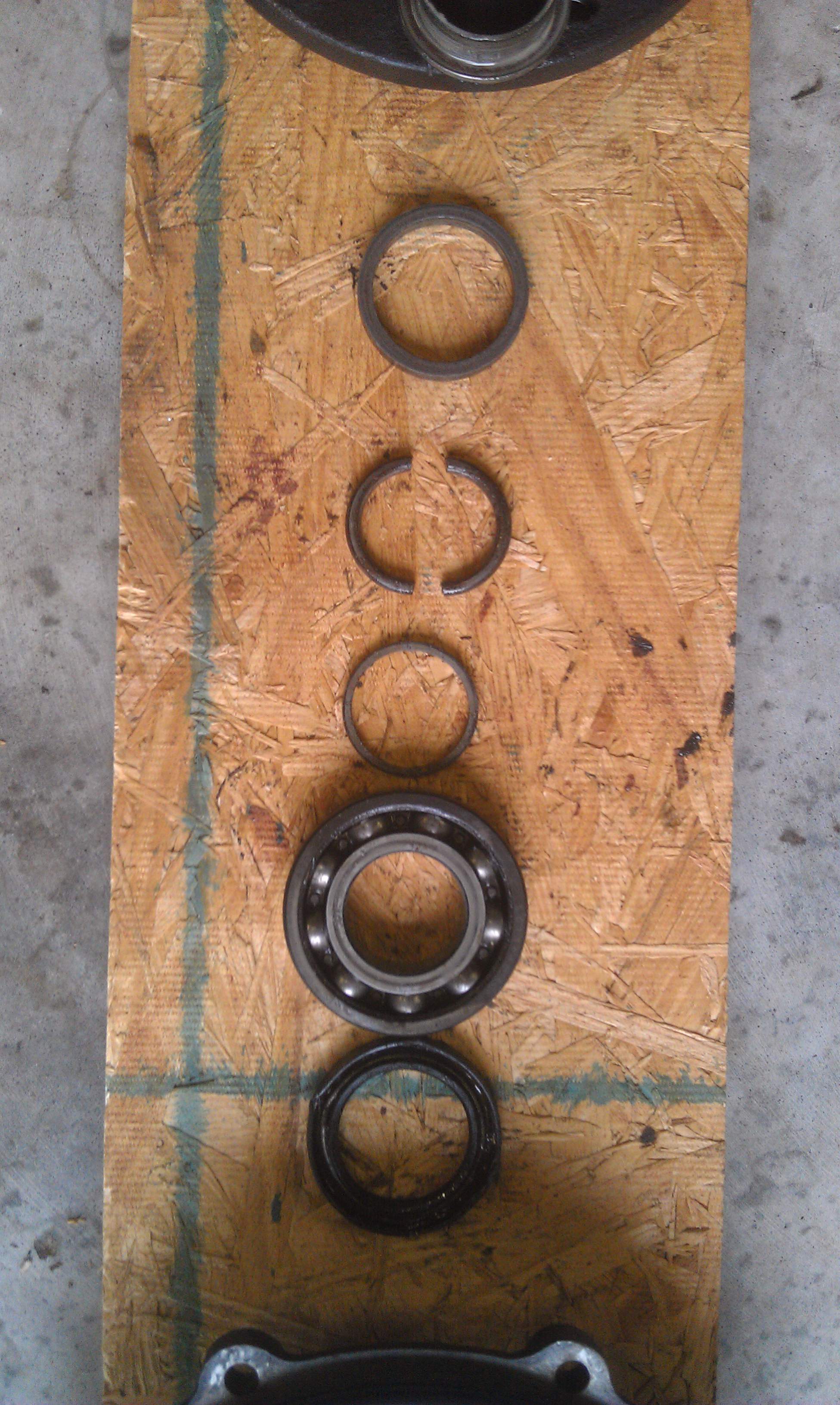

Ok, for those of you that ever run into this problem, here is the way to get the split ring out.
First a little rant. I have been using IPB's (Illustrated Parts Breakdown), for a large number of years, and normally the way the parts are shown is the way the come apart or go back together. NOT this time. The only way to remove the split ring (REF #120) is to remove the collar (REF #110). End of rant.
All you need to do is slip a screwdriver under the collar and pry or twist and the collar slips right off the split rings. Everything else just sort of falls apart except the oil seal, and it just takes a few taps with a punch and out it comes also.
