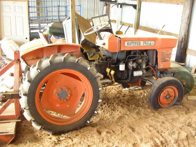

   / L175 tranny repair? #5
If you need a parts manual PM or email me and I'll email it to you. This one does run when you need it to. :)
