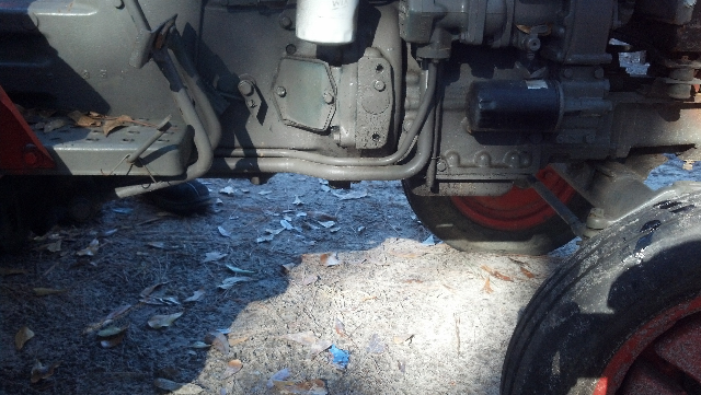

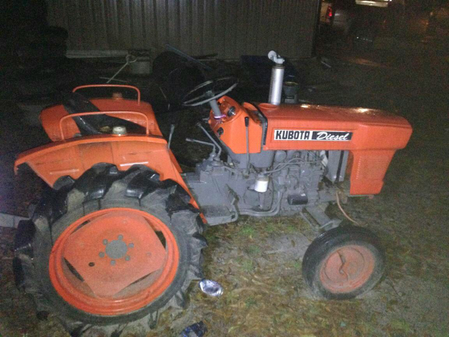

I snagged this tractor up real quick
The good:
New radiator , new starter, engine runs like a top with a grunt over 1000 hrs.
The bad:

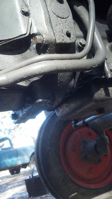

Horrible tranny leak , as you can easily see where it comes from.
I will have to split the tractor in half and replace the gasket.
I havent done this before, but pretty sure i will just need some, jack stands
Regular hand tools, and time.
How long would this repair take and what tractor cross references with this one. Its grey market. L175?

   / L1501 Kubota 650.00 cash #4
Yep, its splitting time. Don't do it yourself make sure you have help.
I figure for 650.00 the engine and everything else is worth it. I mean a little work and i will have another to add to my list.
What gasket do you think that is, and how rough of a job is it. Removing hydraulic lines and basic mechanic stuff? I havent split one before.

   / L1501 Kubota 650.00 cash #6
1st thing to do is find a Manual for it.

   / L1501 Kubota 650.00 cash #8
Looks like you got a pretty good deal - regardless of the oil leak.
