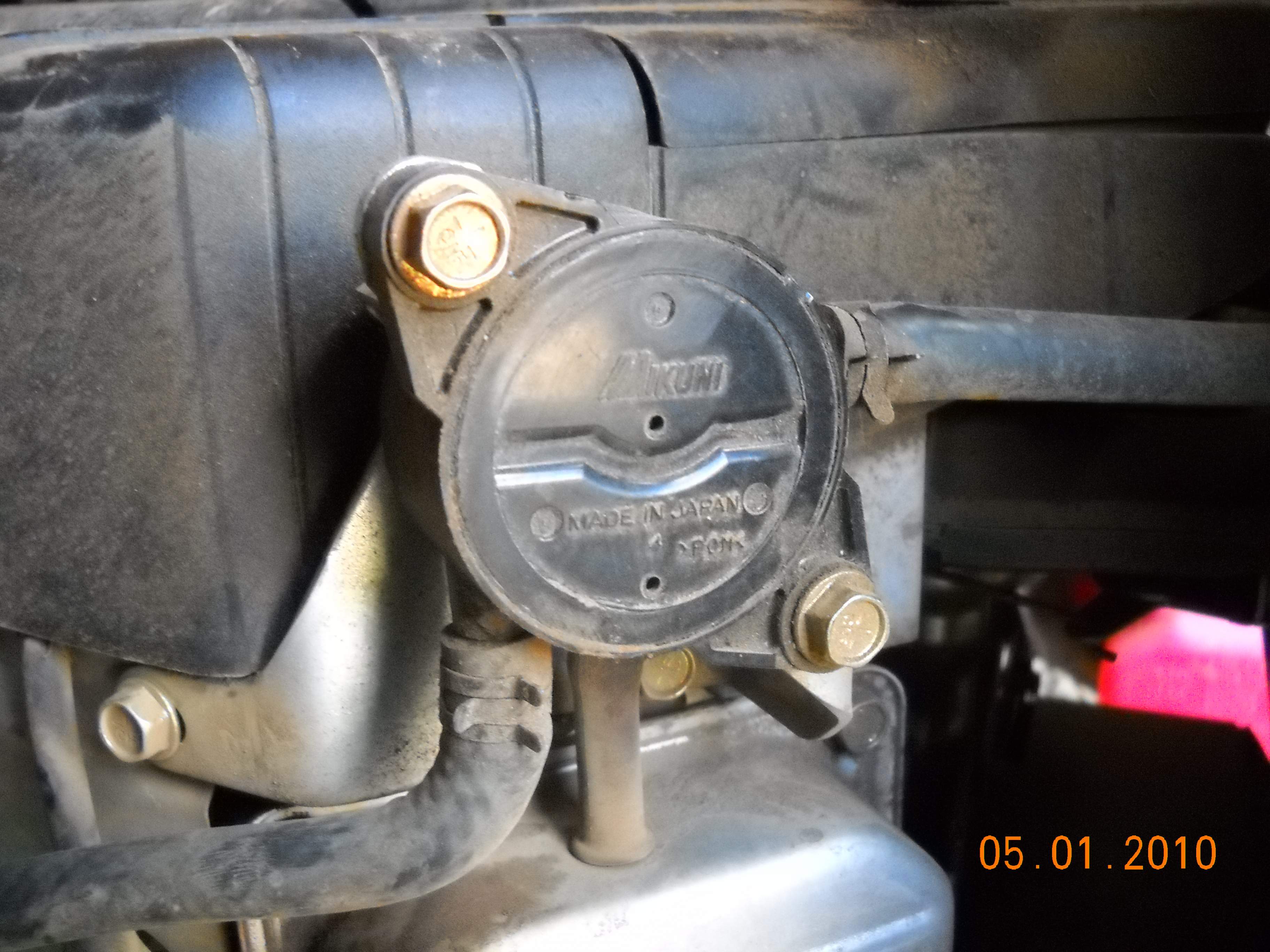

My L118 did the same thing. I took the hose from the fuel filter and filled a cup with gasoline. Put the hose in the cup and watched. Then since it wasnt pumping, i thought i might as well give it a tap with the screw driver before i took it off and went down to Deere to go buy another. Now it seems to work just fine.:D

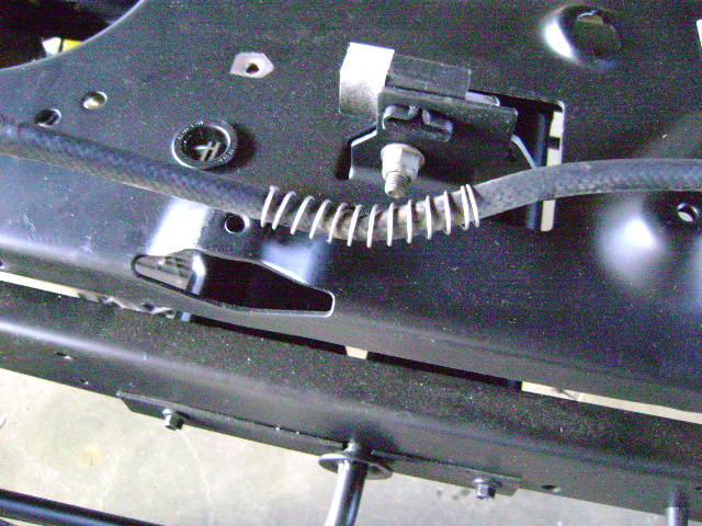

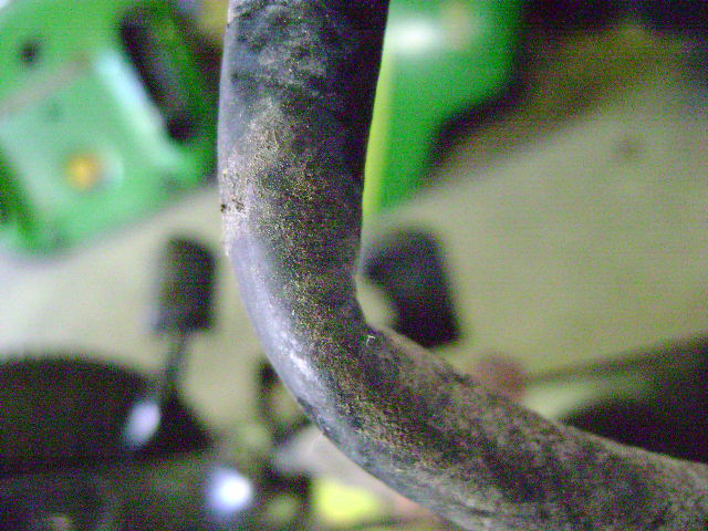

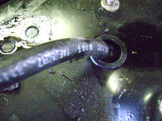

This is what I forund when I took my L130 apart. The fuel line just as it passes through the frame near the engine. I put a spring around it before I reinstalled it hopefully it will keep the line open.
