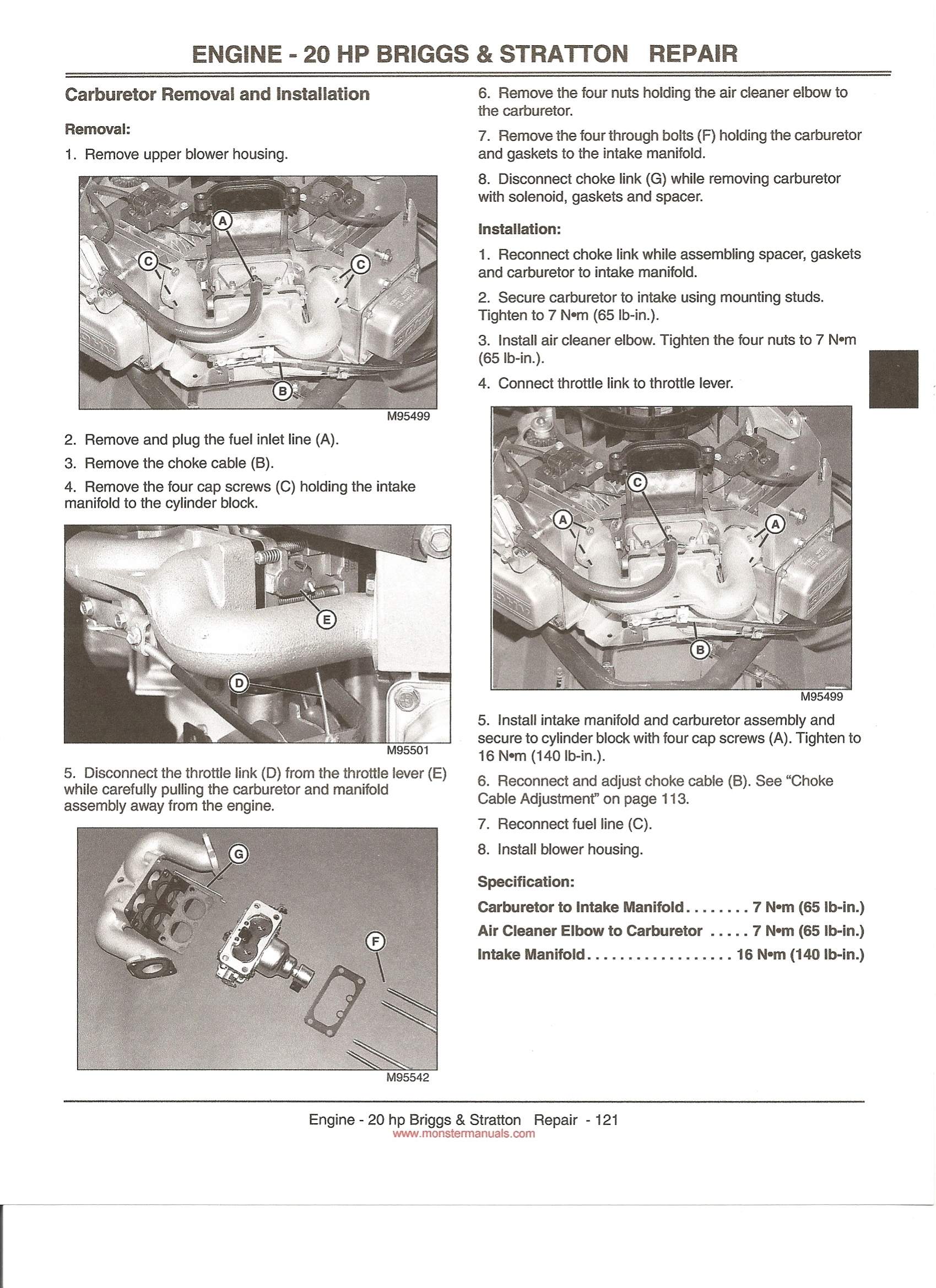

I fixed the problem. :)
The nut inside the fuel float assembly that holds the fuel shutoff soleniod (bolt) in place has a small jet in the side of the nut as well as a jet in the middle of the nut. The side jet was an area that could not be reached with the carburator spray tube (spray can). I removed the fuel soleniod and cleaned both of the jets, then reassembled. Worked perfectly. It's amazing how a little dirt or varnish can impact things.
I also noticed that the air vent on the gas tank cap was starting to get clogged. Also noticed that the air intake on the fuel pump was dirty. Cleaned both of these items as well.

   / L120 Fuel Problem and Technical Manual #9
Any chance you might have a photo or two that indicates where I might locate: "The nut inside the fuel float assembly that holds the fuel shutoff soleniod (bolt) in place has a small jet in the side of the nut as well as a jet in the middle of the nut. The side jet was an area that could not be reached with the carburator spray tube (spray can). I removed the fuel soleniod and cleaned both of the jets, then reassembled."
Thank you very much a picture would help me greatly.
See attached. The fuel shutoff solenoid is located at the front/middle of the mower. There are two wires going to it. The carburator assembly needs to be removed (4 bolts). The bowl can then be removed by taking out two screws. Then you will see the nut I was talking about at the bottom of the bowl that holds the fuel shutoff solenoid. Good luck.
