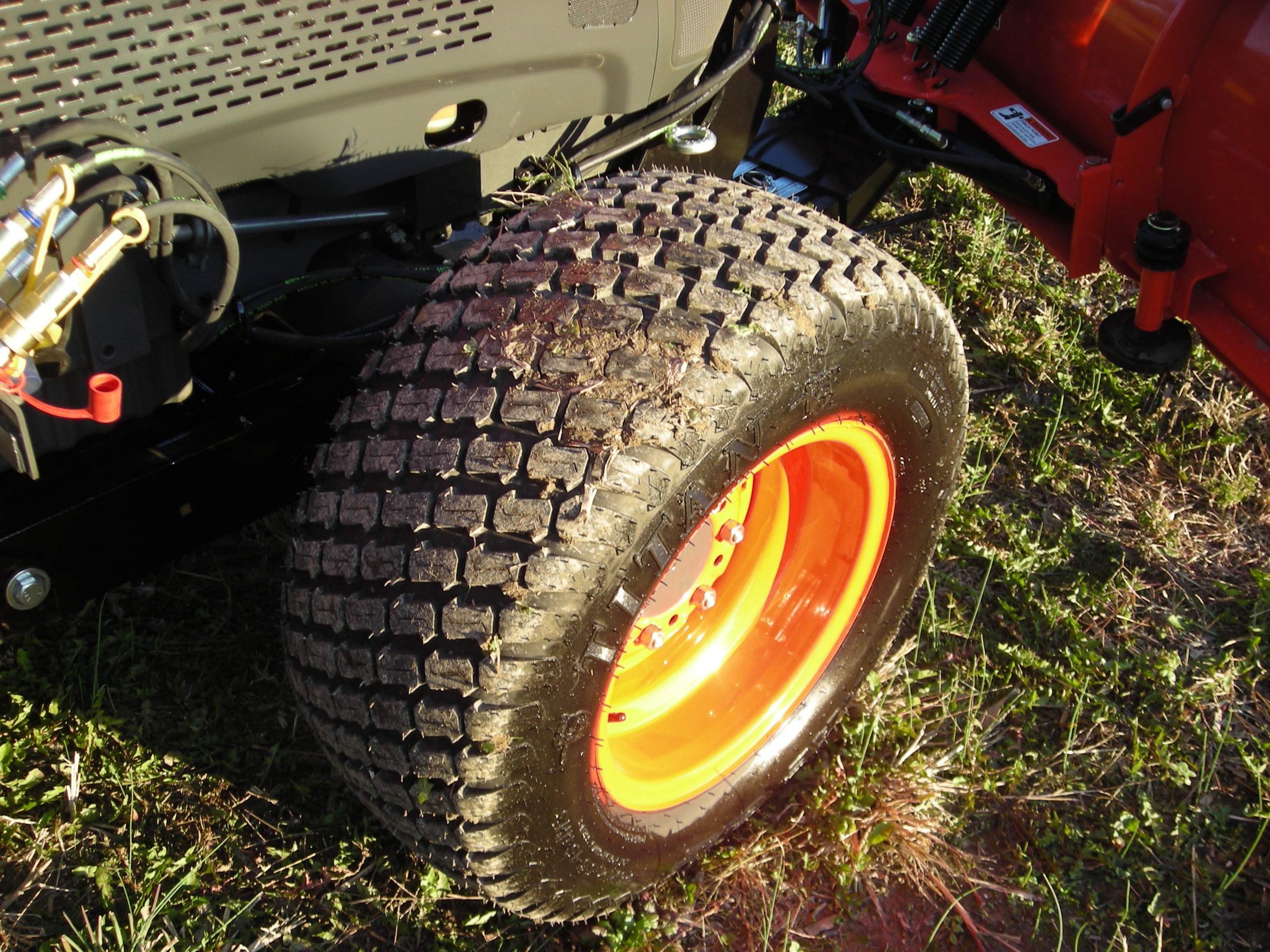

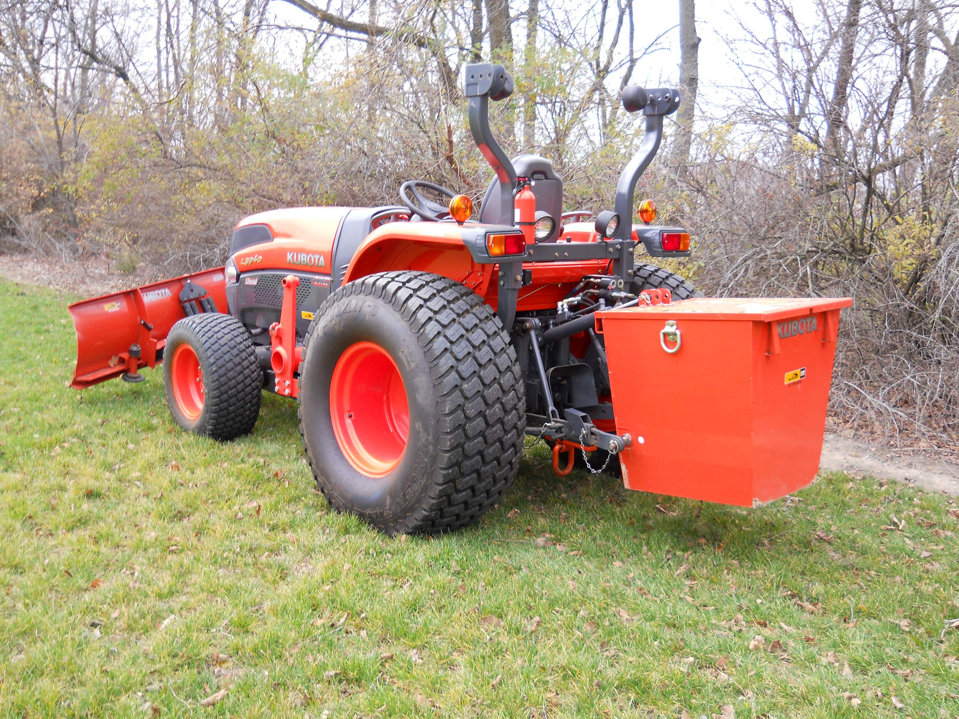

Here is what I special ordered with my L3940. Had to wait a few weeks for them. Great all around tire. Philip.

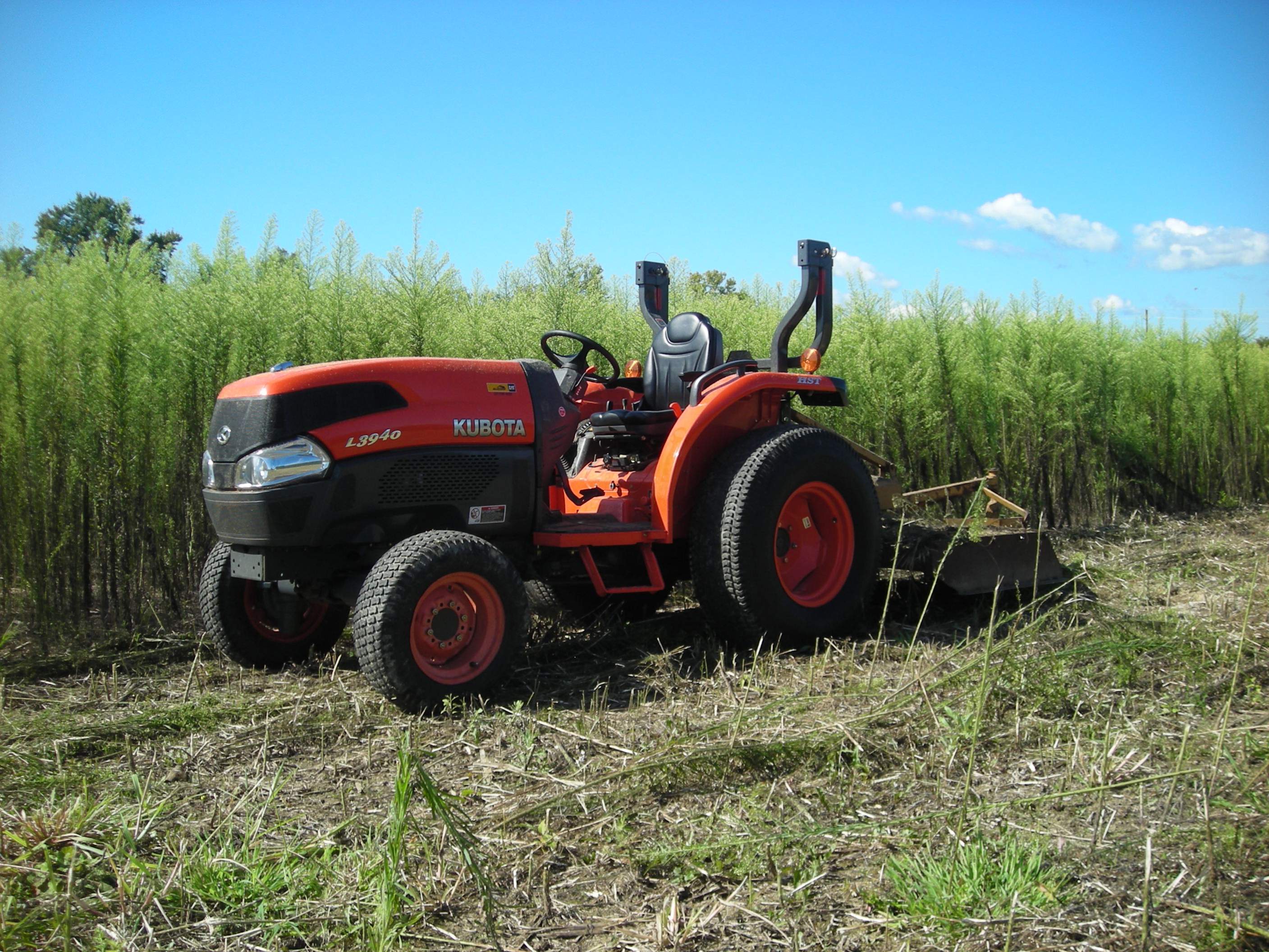

When they delivered tractor, they put this used set on until my special order above came in. I think this is what you are talking about. These really do not offer much traction. Philip.
These are the good ones, had them on my L4330 and loved them!
I have these on my 3540, they have been very good tires. I have 1000 commercial hours on the machine, the fronts are just about done, the rears probably have 40% tread left.
Hey there we go, those were the others I was considering. First I seen them on an actual L series.
I thought they might be better than the multitrac as far as (reasonable) traction goes because it's more tractor weight on less surface area. But maybe these are too much weight for those tires
Have a neighbor with an 80's l series that's like a modern sized B series size with those same tread and a hoe, that doesn't have any trouble. But it's all probably just a ton in weight
Thanks for the pics phil

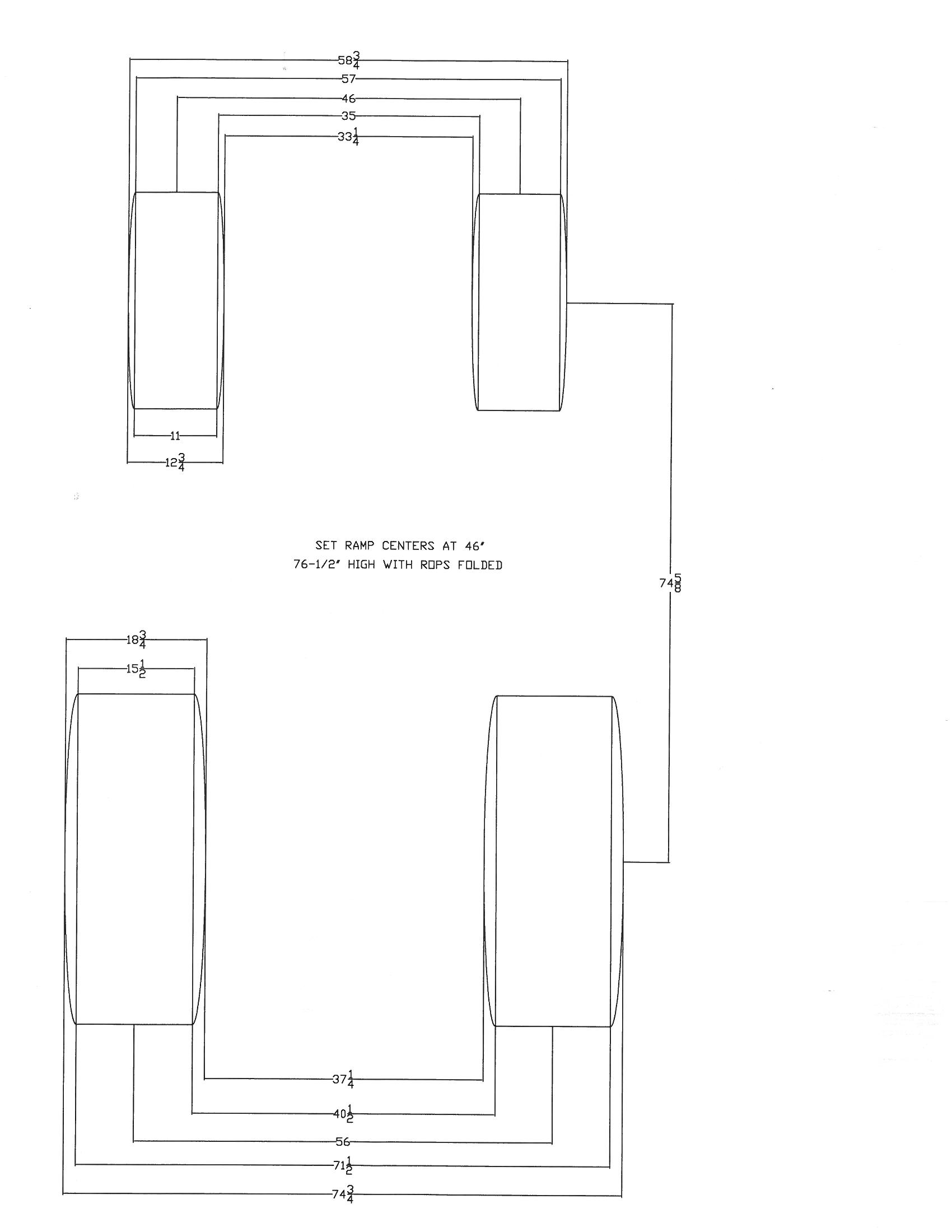

Are those wider than the R4's? What width does it make the tractor from outside to outside on the rear tires?
   / L series turf options, can't find info on one set #9
I cannot compare to the R4's. See attached pic for dimensions. Philip.

It would look to me as if they may be a little wider.
