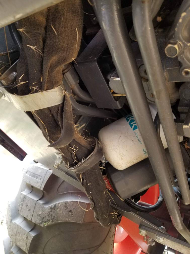

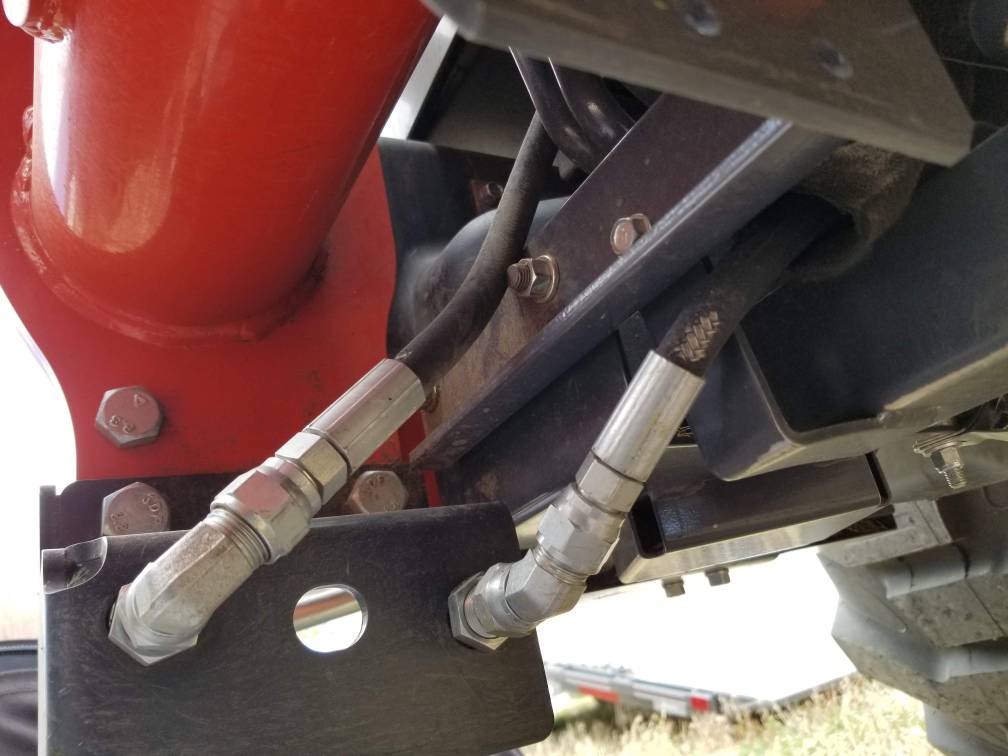

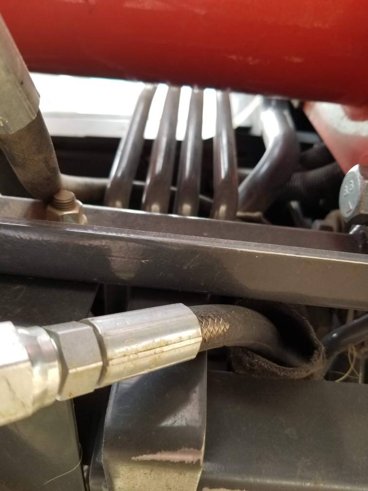

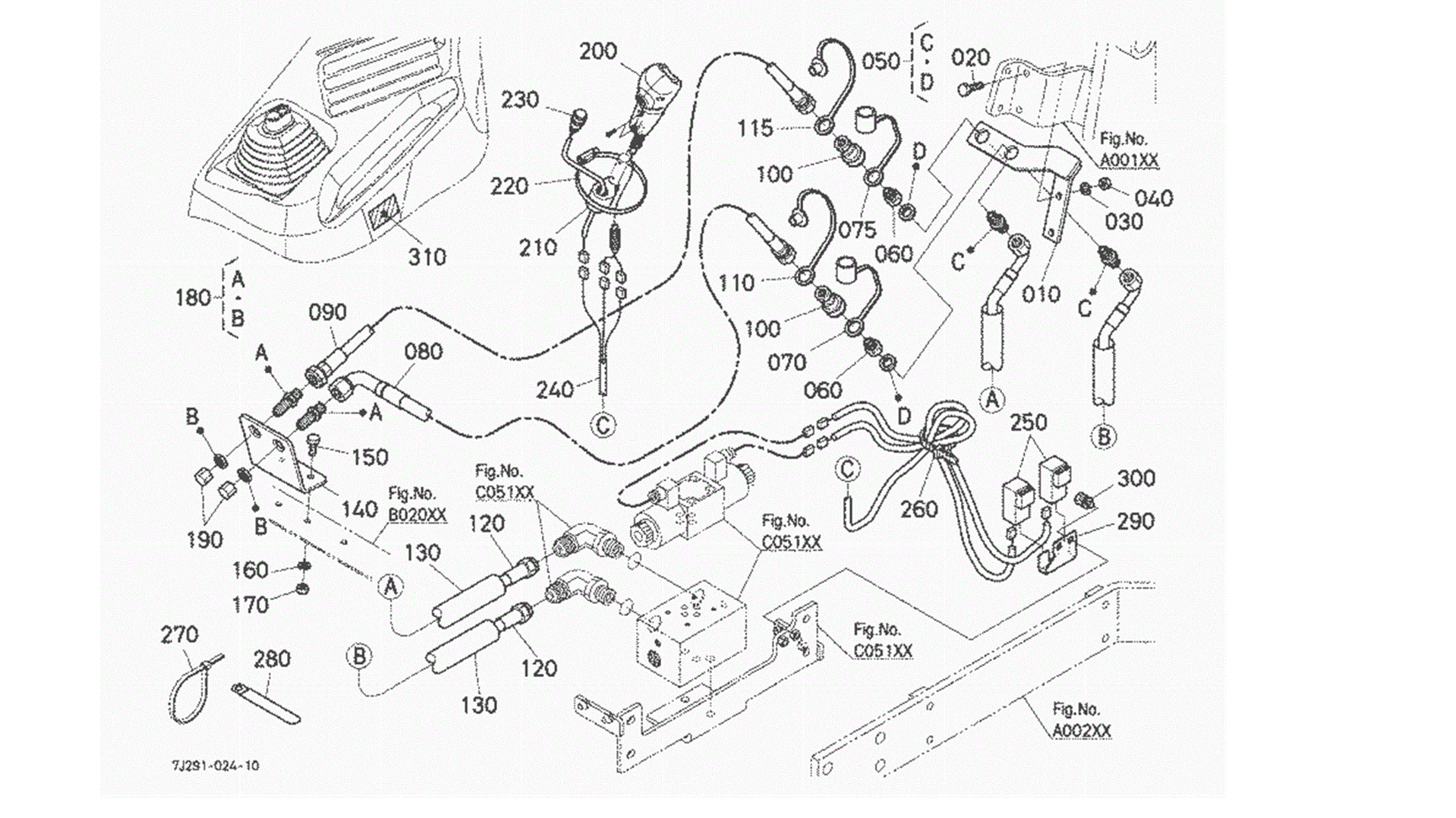

Hey Guys
I'm currently installing a third remote on my L 6060, the kit is a L2265 from Kubota. Unfortunately it didn't come with directions or a schematic of the hydraulic lines. Would anyone have any information on where the lines hook to the tractor ?

More of a photo set on why Kubota needs a skid plate there than where the go. But here's photos off my L4060. They run back to the rear remote valves just above the rear axle. 20180622_125802.jpeg20180622_125849.jpeg20180622_130007.jpeg

Here is a diagram:
