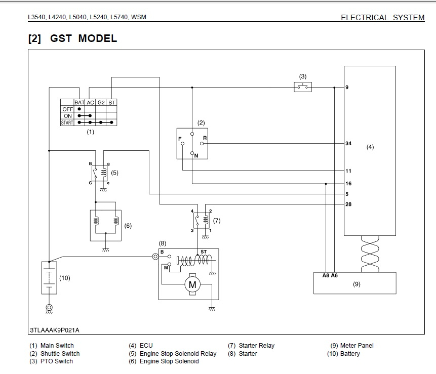

It is the tractor's safety systems which are shutting the engine down.
In your GST model two possible switches are out of adjustment or have failed (or wiring). #2 or #3.

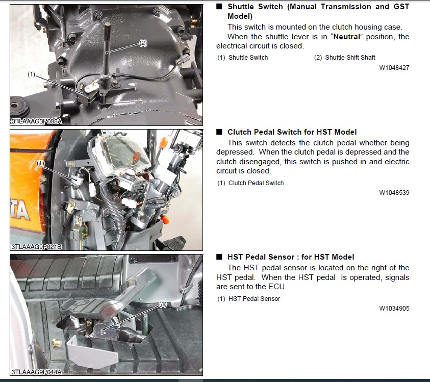

Thanks for the info. Do you know the location of the shuttle switch by chance? And the tractor hasn't left me stranded and it always starts in neutral. It only has the dying issue when you put go to let the clutch out to move is when it dies instantly.
   / L-5040 GST Dies when trying to go forward #8
The WSM page showing the switches
Dave M7040
