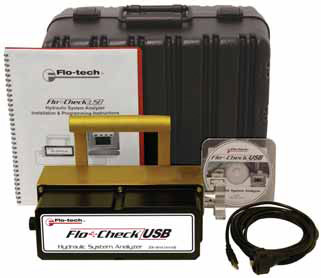

Thanks J J for the input. I will check to see if there are any restrictions. The specs for the hoe (Woods BH-90X) show 9gpm the lowest flow necessary for operation. I can test pressures but I have no way to test flows. Anyone know of a source for inexpensive flow meters?

...I have no way to test flows. Anyone know of a source for inexpensive flow meters?
Check what kind of flow you have with the supply hose running open into a 5 gallon pail
... how many seconds will it take to fill the pail?
Are you able to operate your BH at full engine operating rpm? most do not, and run the engines at lower rpm just to 'reduce' gallons per min flow rates... KennyV

With a flow of 9 GPM, your flow test should produce about 3 gal per 20 sec. Or 1 gal for 6.6 sec.
