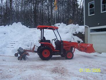

After a frustrating day at TSC & 3 local tractor dealers, I need some help in finding the proper male connector to plug into the aux. hydro valve kit for my L-39. It appears that the generic "pioneer type" male coupler will not work.
The female couplers off the valve body are fixed, and do not have the sliding collar common on a quick connect coupler.
The female coupler is marked "PARKER 0312-001".
I checked Parker's website, but that model is not listed.
I have e-mailed Parker & Kubota, and am waiting for a reply.
This valve kit is Kubota part#32781-9630-0, and mounts on the right rear FOPS bar above the fender. The Kubota parts manual lists the coupler as part#3A111-8201-0.
Since mounting the valve kit, this is my 1st. use of the aux hydro valves. I fabricated 2 brackets to make use of a hydraulic cylinder to angle my Woods LR-106 rake. The CCM Top-N-Tilt set up will be next.

I have found the Parker couplers at TSC to work perfectly.
Post a close up of your female couplers… they have to have something that releases the parts.
On my Kubota you pull the hydraulic lines toward you (to the rear)… that is what allows the insertion of the male coupling. KennyV.

Hey Walt, I'm sorry that I do not have the answer for you at this time, I have not utilized my rear remotes as of yet. However I do see what you mean, the female connectors do have the ball bearings lining the inside but there is no slip release for a quick discoonect on them? The male 1/2" connector slips in, but apparently no external release around the female end rim?
I'd like to know what you find out though.
When I installed the ANBO grapple on the front electronic remotes OEM from Kubota, they put 1/2" male Pioneer connectors onto the end of the two hydraulic lines. However I could not find any females that would fit them from Skid Steer Solutions or TSC. I finally just got a matched set of Pioneer Male-Female 1/2" connectors at TSC, removed the OEM Kubota connectors, and installed the new matched male-female 1/2" set I got at TSC in place of the OEM Kubota units. /forums/images/graemlins/crazy.gif
It only cost about $20 so no big deal, but I never did find out what was the proper match up for the OEM Kubota front remotes.
If I cannot figure out the correct setup for the OEM Kubota rear remotes, I'll remove them too and install something I know that works!

Most of the new large AG tractors do not have any type of release on the couplers. You just insert the hose into the coupler and push until the hose snaps in. To release you just pull hard on the hose and it will pop out of the remote. These type of remotes are common on John Deere and New Holland tractors. Maybe Kubota has started using them also. They are so much easier to use when you are changing different implements during the day. We had one tractor on the hay farm that still had the collar type release remotes and it was a pain in the butt to get the hoses off once it had built up pressure when change the fluffer to the rake. I am not sure of the size or type of connector you need.

If they are under pressure they are hard to pull apart. It there is no pressure they pull apart pretty easy. They are made that way so that if you come up hitched or forget to unhook a hose they will unhook. They seal when they unhook. Most or should I say allot of Ag equipment use 4200 series Parker connectors. When you get use to this kind, you will detest the others. If you down load the Parker connector catalog you can check out what they offer.
