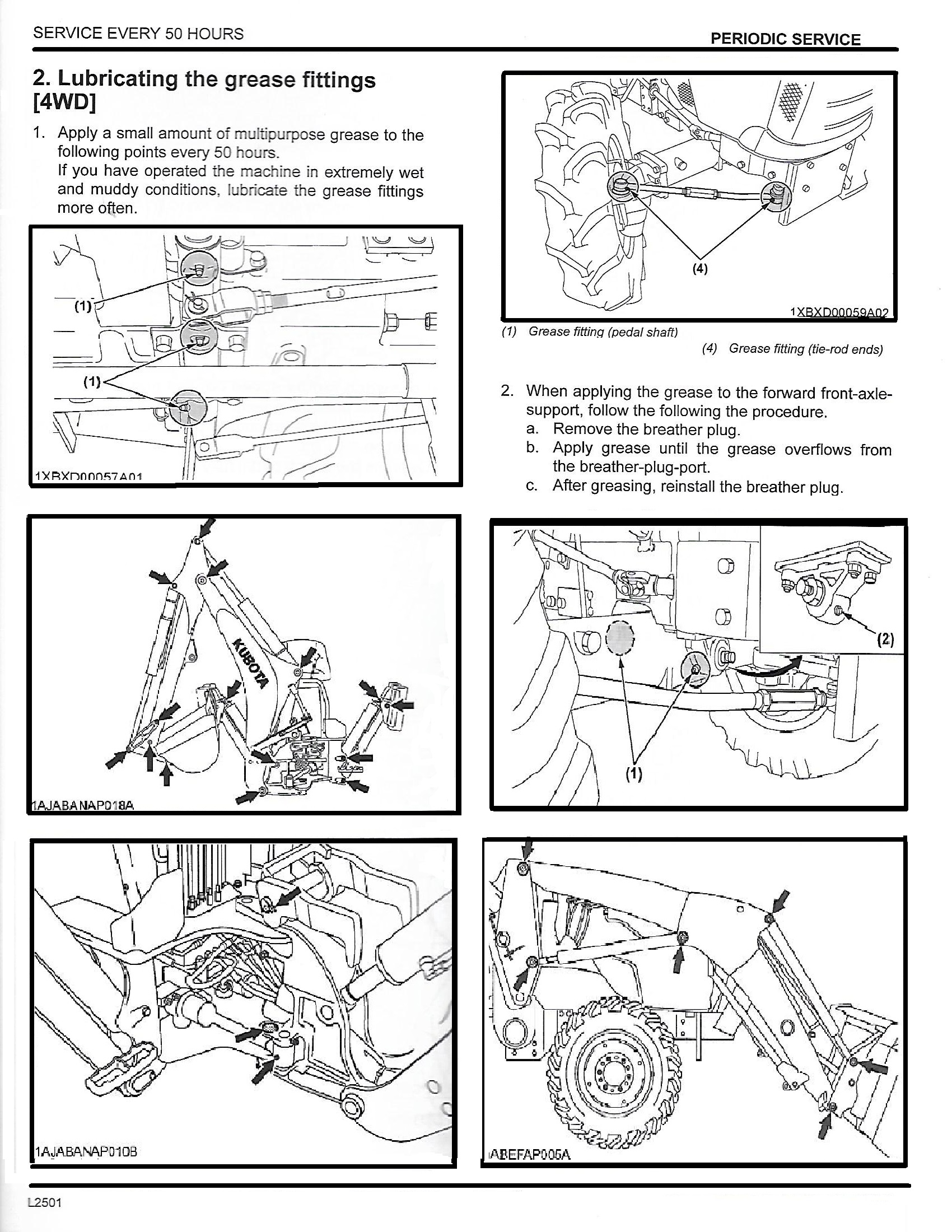

This may make it easier for you guys. In my opinion the manuals stink

I agree that Kubota Manuals are not that helpful.
Lubrication is pretty straight forward in most cases, pretty much hit the pivot points or at least the ones that have zerk fittings. Include pivot points on brake and clutch pedals. Also u-joints and wheels on attachments.

The diagram may simplify things for some people. I just find greasing somewhat intuitive as Chewwy says.

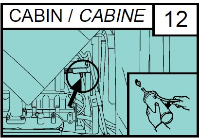

If your Kubota has a cab, it may have a non intuitive grease fitting on a sliding joint in the steering shaft.
Locally, some owners have had the joint seize up.
