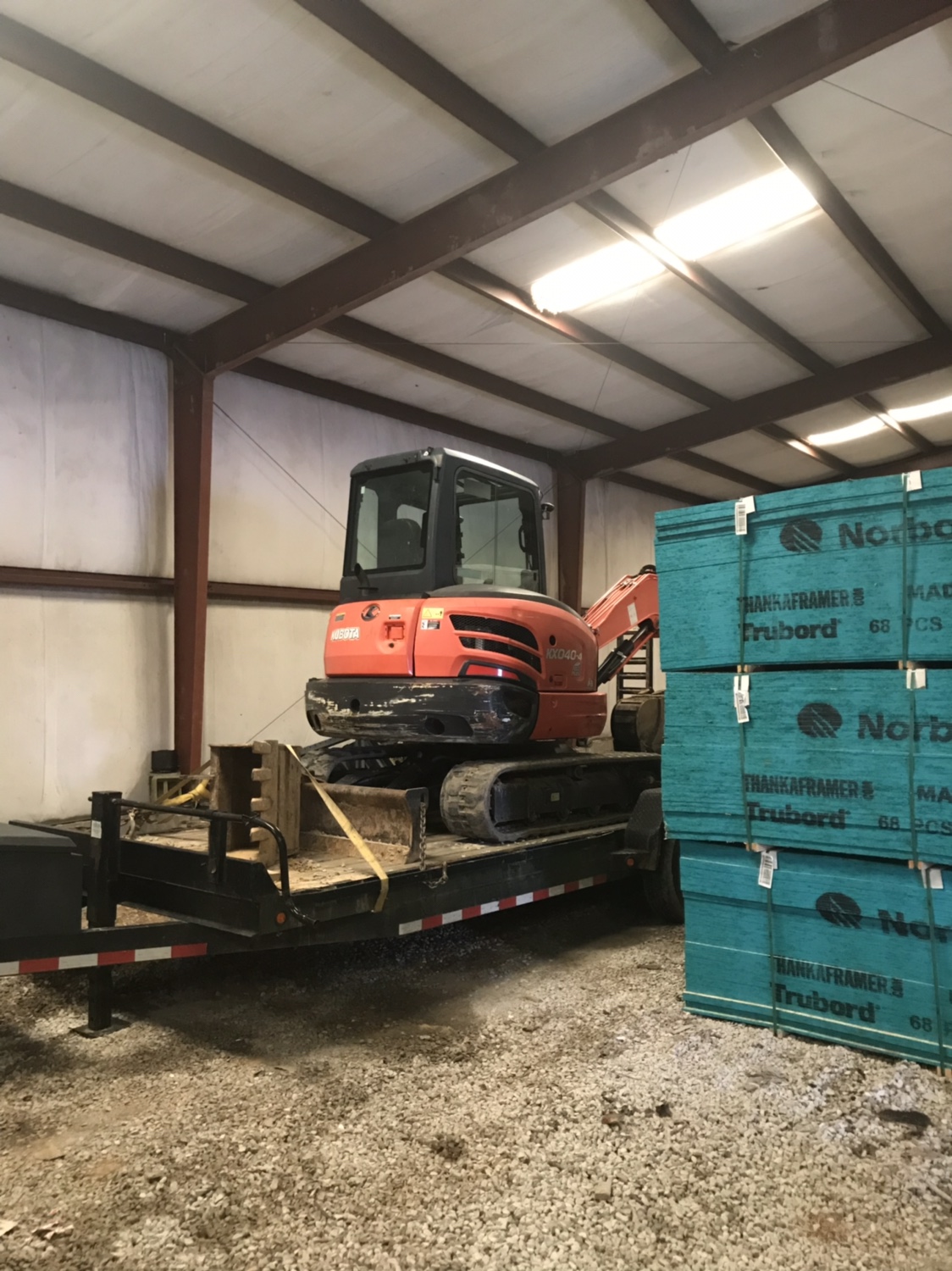

I just bought a Kubota 40. I’d have rather had a 57 but the cost difference was more than I could swing. IMG_9436.JPG

Should have sold off some of your OSB to cover the difference!
I bought all that when it just started going up. I think I have $16 a sheet in it and I think there’s 12 bundles. I was hoping to have a 5000 square foot build started already but it’s been held up for permanent issues. It’s finally approved now and the footer is going in next week. Lumber is still higher than what I have in that. I was going to try to buy some more if it came down any over the winter. But my customer paid for that. I don’t have any money in that stack.

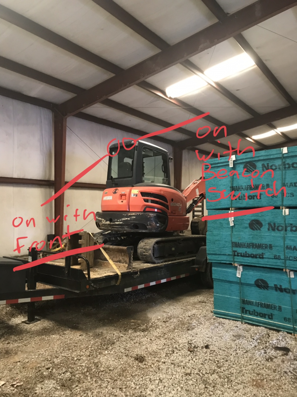

I got a 40. FYI you have wires read for lights under those grommets above rear window. Just take the speakers out, easy access. Hot and ground for each. The left turns on with the front light and the other turns on with the beacon switch. 2 mounting bolts for each also.
I’m probably going to put a light bar on the front but rear excavator lights aren’t much of an assist IMO but thanks for the tip. I have some 45 degree side lights on my M59 that proved pretty useful.
