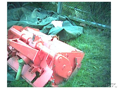

I have recently come across a Kuhn EL 35 tiller for sale.
I am told it was manufactured in 1997 and only used for preparing seed beds in a market garden.
The tiller is 1.2m wide (4ft) with an adjustable offset of 150mm (6").
From the attached photographs it appears genuine and in very good shape. (It is too far away for me to view personally).
My questions are;
1) is the width and offset sufficient to cover at least one tyre on a 5' wheelbase, or should I keep looking for a 5' tiller. My tractor is an Iseki TL2500F with 27hp PTO. Would a 5' be too much for it. I recently viewed a 60" Howard and the weight of it scared me. I had no confidence that the tractor would be stable with the weight (out of the ground), or capable of operating it satisfactorily.
2) From the pictures, can anyone highlight any possible areas of concern, or questions to ask the seller.
3) The selling price is £550 ($873). The current Kuhn model is listed at $2050 on Kuhn Is this a good price for a 5-6yr old machine?
Any advice would be much appreciated.
Nigel

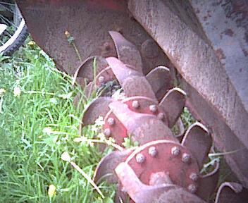

Second picture showinf rotor shaft.
The original paint is still intact, and there appears to be no wear on the blades themselves.

   / Kuhn Tiller #3
Actually, I thought the blades looked quite worn. A good price and a budget for a new set of future blades and you may have a great deal. I think the Kuhns are the finest made from the research I've done. Rat...
   / Kuhn Tiller #4
You don't have enough offset to cover the tire track unless your lift arms on the three point can be slewed to the side enough to make up part of the other 6". You might also be able to install the lift pins so they point in the same direction. That might give you a couple of inches of offset.
See if you can get the other 6" and stay within the max angle for running the pto shaft. check the weight of the tiller against your lift capacity. If every thing looks good, go for it. That's a deal that won't last long. Kuhns are the Mack truck of tillers.
