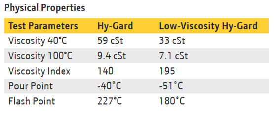

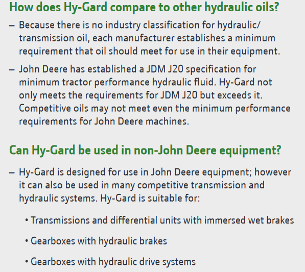

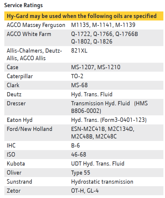

Kubota UTC and CAT TO-2 and Deere Hygard and Yanmar TF500A are all the same specification of J20C. In some regions if one of these are not available, we tend to find one in the group to purchase and use. This happens a good deal in the EU and eastern EU countries along with Canada. In the USA, not too often are you hard pressed using one of the others in the intern.
ONLY use fluids stating 'meets' Kubota UTC and never 'compatible' nor 'recommends'.
