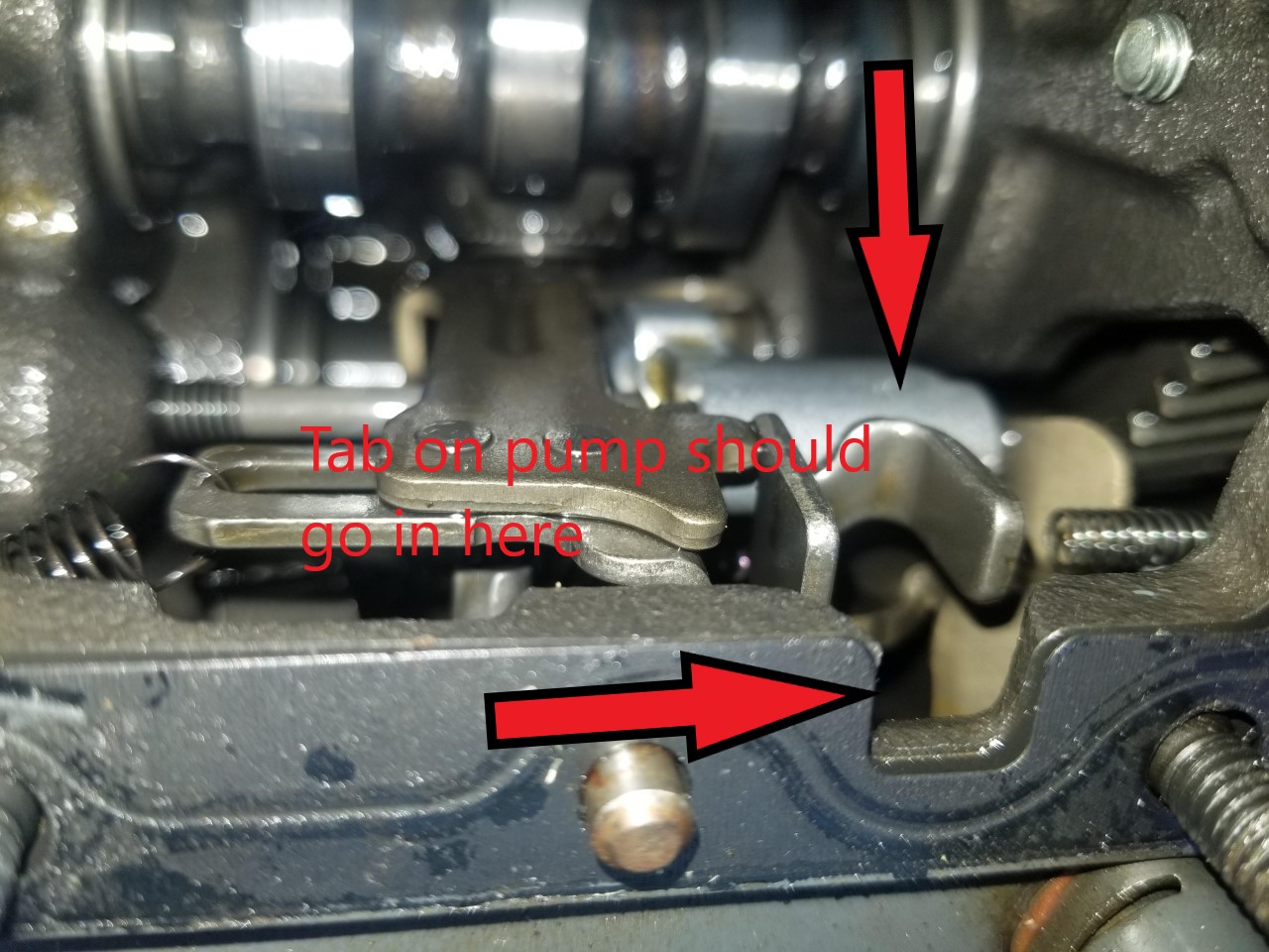

I have a ZD25 mower with the D1005 E2 engine. I was having problems with the engine losing power while mowing and read one of the things to check is the injector pump. I took the injector pump off and removed the push rods and springs (sorry, I don't know the official names of these parts) checking for broken parts. All appeared fine and when I put everything back together and started the engine it only runs wide open and smokes a lot. It didn't want to turn off right away but will after about 5 to 8 seconds with the key off.
I took the injector pump back off and checked everything. I cannot see that there is a specific orientation to anything. Put it all back together and same problem.
Can some please tell me what I may have done wrong with this either putting it back together or putting it back on (or maybe both)?

There is a governor that somehow ties the engine into the injection pump. As the engine slows down it makes the injection pump put more fuel in. I’d guess whatever ties the governor into the injection pump is not being put back together correctly or there is broken parts. The problem is I have no idea what any of this stuff looks like. For me pictures and/or diagrams help. I’d google it and see if you can find any.

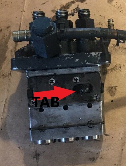

Here are pics of the pump and the slot it goes in. I have watched several videos on youtube that show this or similar pumps being removed and replaced but none say anything special. I know the tab has to align with the slot and then should go into the slotted area shown in the pic. When i removed the pump it came straight out with no issues. I used a flashlight and see nothing on the inside the looks lose or broken. The pump itself it working great with plenty of pressure just runs wide open and blows lots of gray smoke.

Sometimes the last thing folks want to hear is the truth. The kind of info you need does not exist here. If you want that pump to work properly you are going to need a lot more information, some special tools and a dose of beginners luck. Or somebody qualified and equipped to do the job.
You asked what you did wrong, I told you. If you had someone watching everything you did you might have gotten a different answer.
