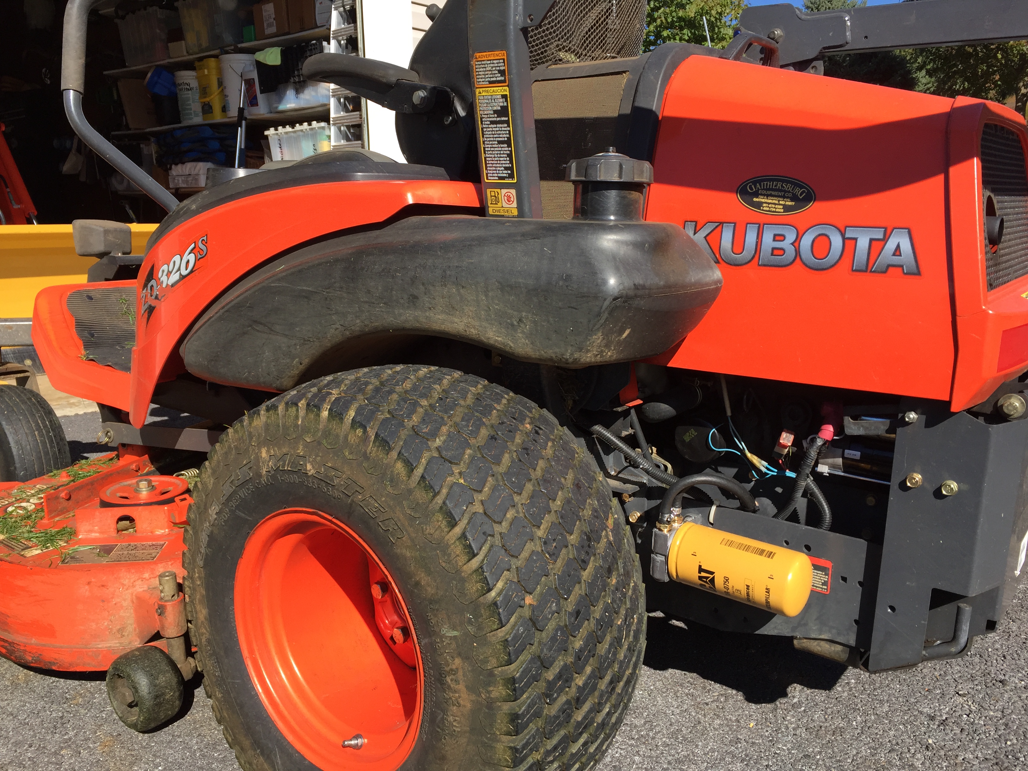

Mower would not run on right tank. had it flushed out last fall. Found oil looking substance clogging line and filter. First run this spring, same thing.

Can't imagine any other cause other than bad fuel... Water or algae.
I had 2 episodes of bad fuel a while back, one of which was totally my fault. Even before that I was sick of the in series low capacity fuel filters. Once you get squared away fuel wise, I highly recommend replacing the first in line filter with a large canister type. I used a Cat 1r-0750 2 micron filter with a Napa 4770 head, mounted sideways on the frame.
