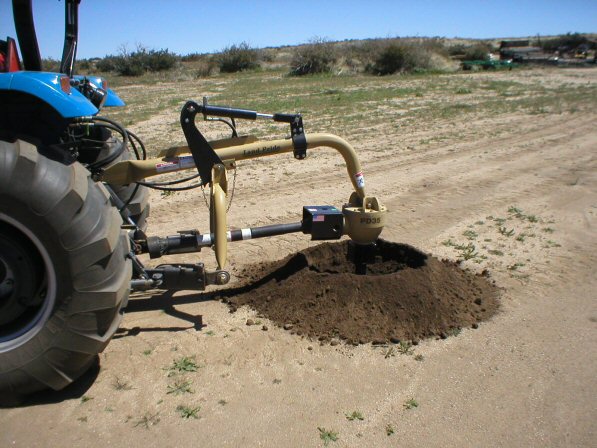

You can get a down pressure kit for a 3pt auger, hydraulic driven or PTO driven. You do not have to have the hydraulic bucket mounted auger to be able to have down pressure. ;)
