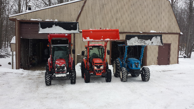

while i don't agree that the mx5100 is a CUT it's not a full size utility tractor either.
I don't know ... it's the same size as my LS R4047, & my Massey 1648...and my buddies Kubota L3540 is very close in size too.
Putting it next to the LS U5030 (next size up) I don't think much of a case exists to not still consider these compacts. Maybe it's pushing the envelope, but definitely not a utility tractor either.
Massey 1648, Kub L3540, LS R4047
