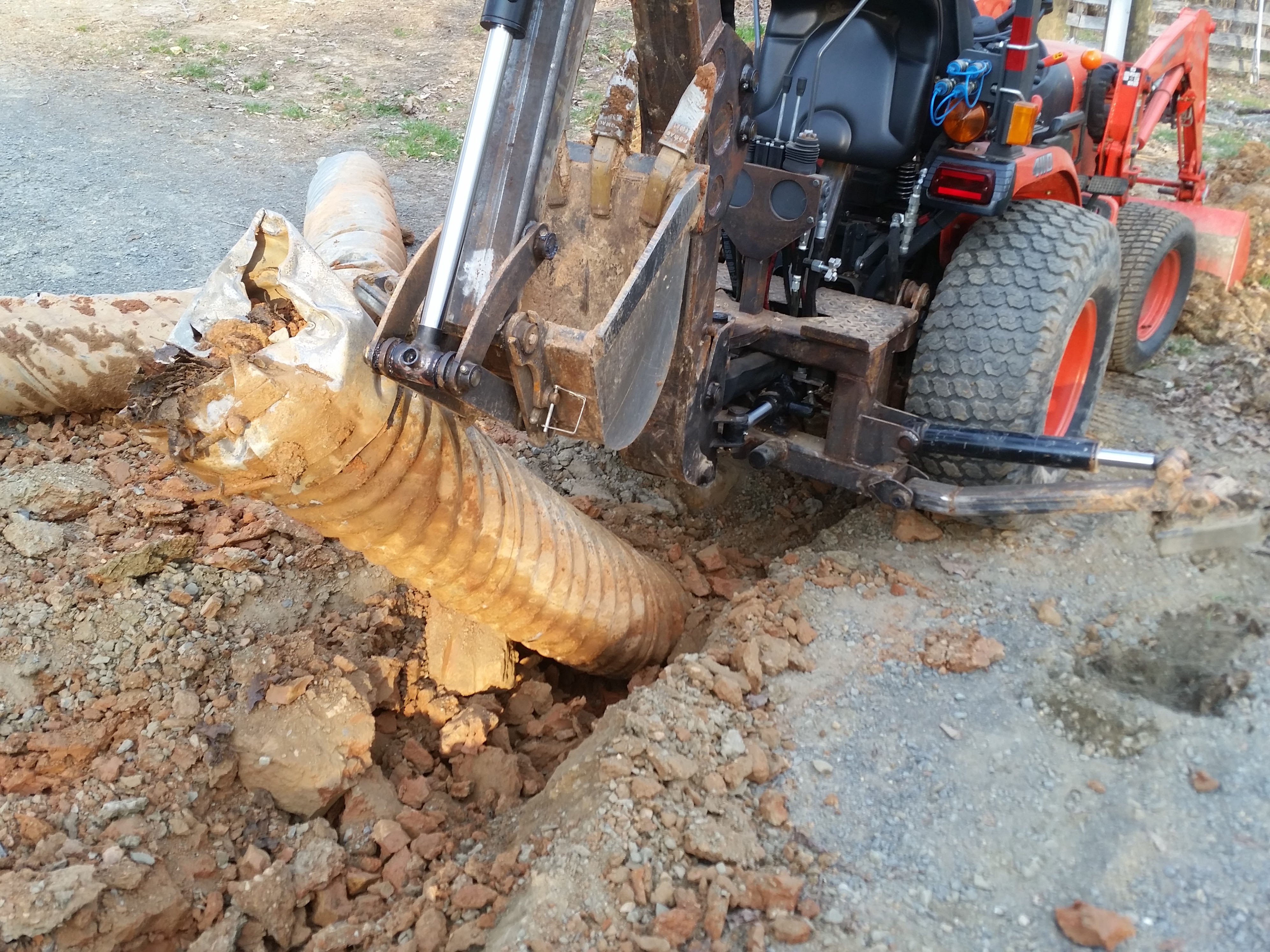

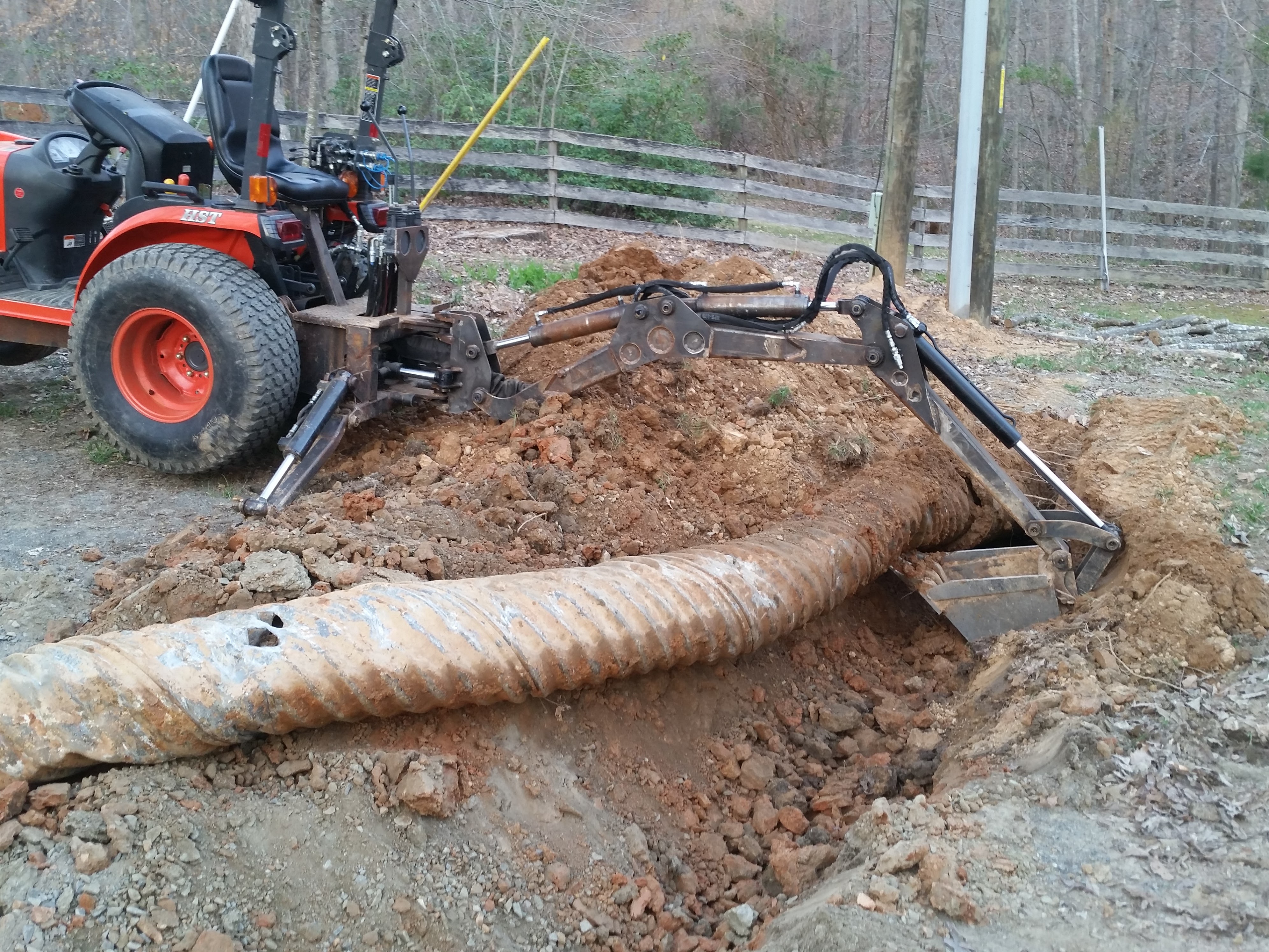

You'll want the larger diameter, I'm suprised they even still offer the smaller (22 and 31 od combo).
I have a b2620 that I bought with r4 and added turfs later, used, the fronts on mine are 23x9.50-12 so look a little wider but are an example of second option you listed.
   / Kubota turf tire choices; Goodyear, Kenda, Bridgestone? #4
Picture didn't attach. Couldn't find a good pic of the fronts on my phone.
