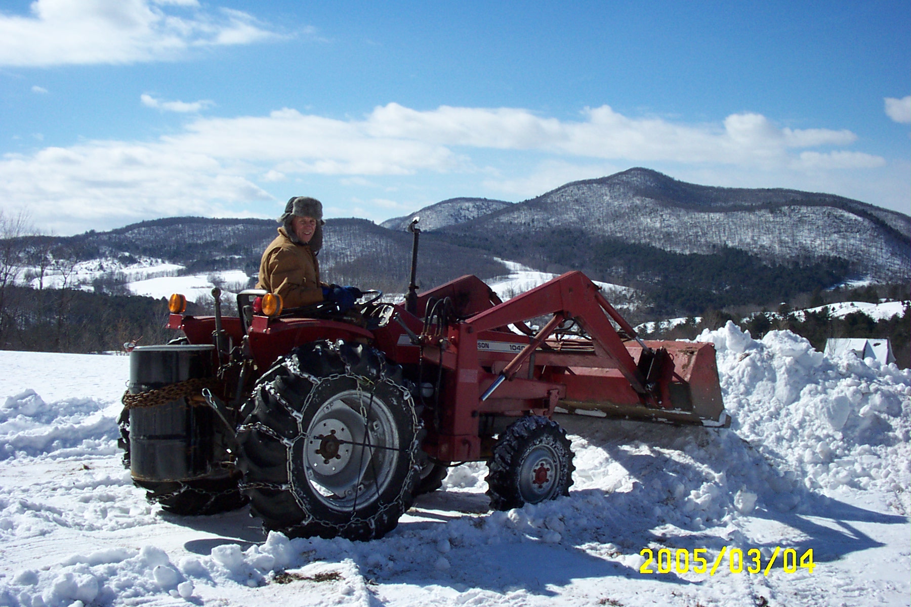

Hi Brian,
Great idea ! I wasnt so creative when I was lookin for a place for my 15ft length of 3/8" chain. I just wrapped it around the counter weight on the 3pt until I need it to drag a log or whatever. I like your idea better :)

Hoooo man, that looks COLD! I grew up in MI but moved to SC because my wife and I vowed we'd be where there's no snow before we died. We do get the ocassional dusting but nothing like THAT. Brrrr
Scott, how do you keep your counter weight from swinging without the top link hooked to it?:confused:
