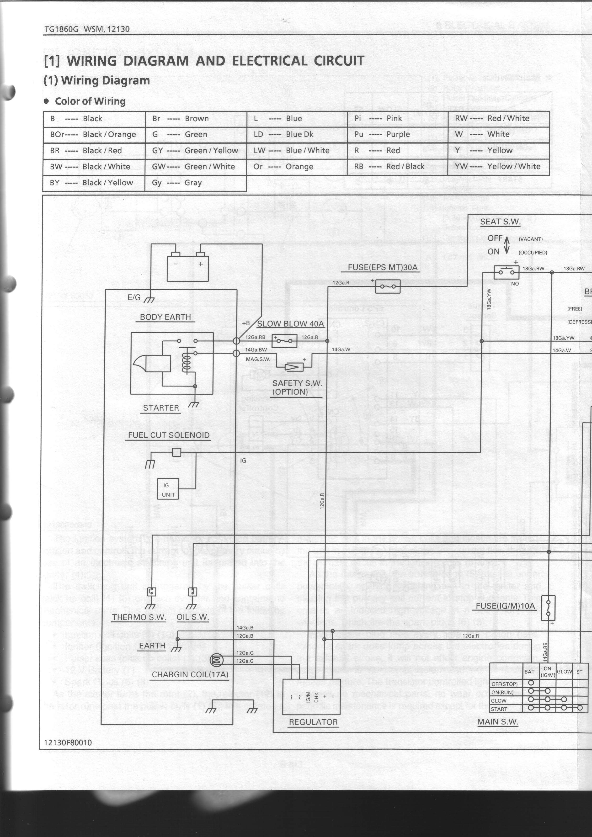

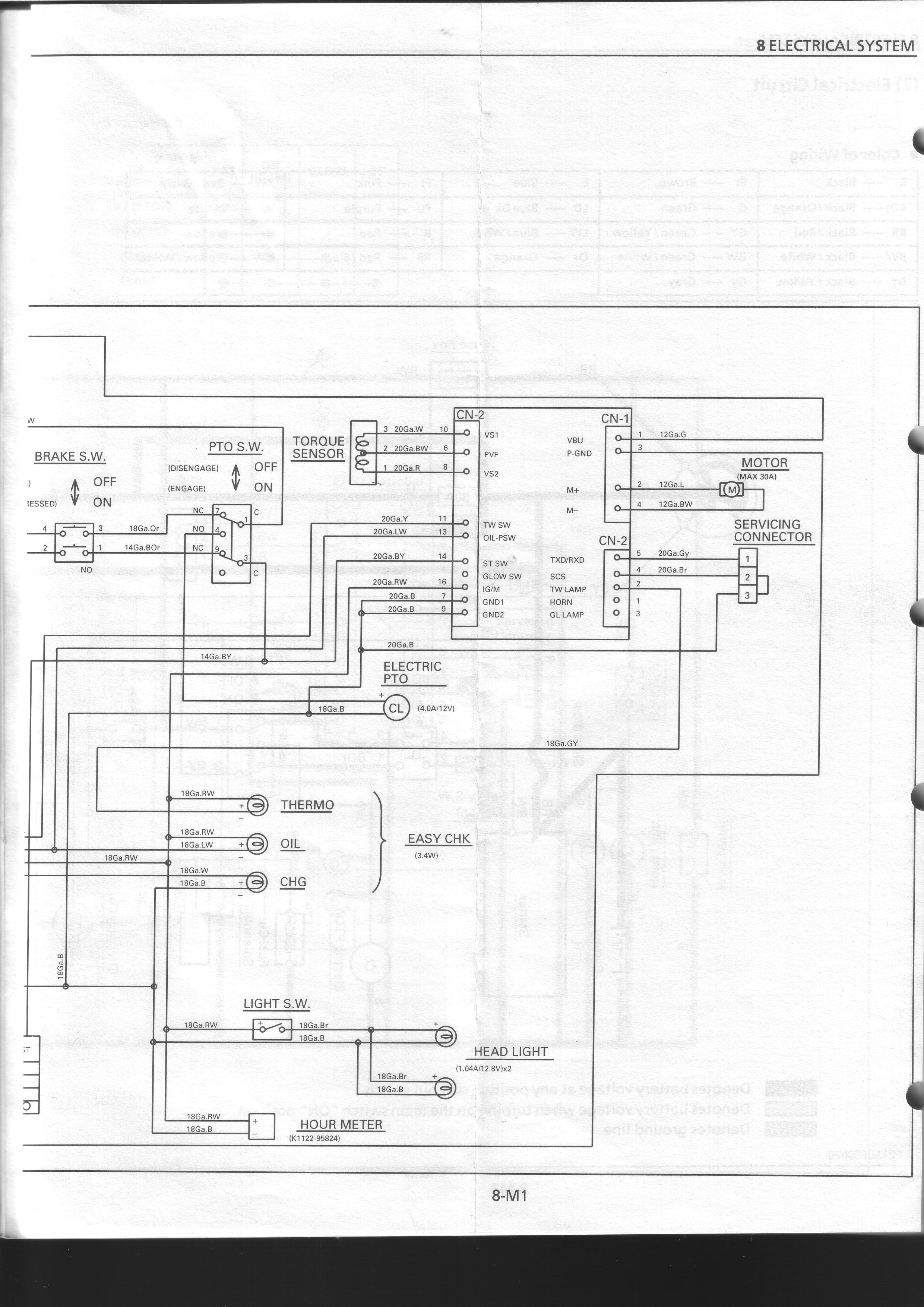

Kubota tg1860G
Does anyone have a wiring schematic for a Kubota TG1869G? I really need the wiring to the stater and relay.
Thanks
   / Kubota TG1860G wiring schematic #2
finally got your PM, Terry...
TG1860G-1.JPGTG1860G-2.jpgthe diagram is 11" by 17", so had to scan it in 2 passes, you'll have to splice it back togther.
hope this helps.
Pete
