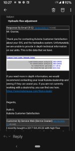

I recently picked up a 2018 SLV95-2S with high flow hydraulics and I’m a little confused as to how to adjust my flow and the operator’s manual is not very clear. The max flow with the HF is 40GPM but IR maxes out at 14 and IL maxes out at 9 so I’m not really clear on how to set my flow.
As an example, I’ve got a brush cutter that has 1/2 couplings to attach to the standard flow ports. It’s max safe flow is 20GPM. What do I set my IR and IL flows at to achieve that? My best guess is that each adjustment of IL increments by about 2.9GPM (40/14) so I should set that to 7. Is that correct? If I’ve got that correct, would it be the same for IL or is each adjustment there equal to about 4.4GPM (40/9)? In which case, I’d want to set IL to 5?
I’m lost here so any feedback you guys can offer is appreciated. I love the machine so far, I just wish they’d done a better job with the manual.
   / Kubota SVL95-2S hydraulic flow adjustment question
#2
I guess nobody else knows either, including Kubota. I ordered a hydraulic flow meter so I can figure it out myself. Screenshot_20200330-102718.jpg
