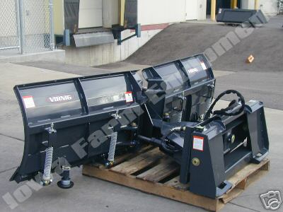

I`m looking for a snow plow to stick on the front of my M 5 9 tractor.
I'd like one to go on the FEL quick attachment not the bucket.
Where to look? Who makes them?
Can my tractor push an 84" plow up hill/gravel road?

You should be fine with a seven foot angle blade on the front of a M-59.
   / Kubota Snow Plow #5

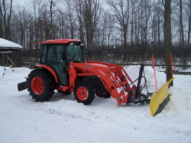

I adapted a Curtis 8ft. to my loader,QA plate,power angle,on my L4240 HSTC
along with a seven ft.rear blade,handles all my snow removeal(120in year average).Nice set-up,can put the bucket back on in a few minutes if needed.
Can pile snow ten feet high...don't have to look back for a rear mounted snow blower.Make sure the trip springs on the plow are in working order.I plow about two miles of drive-ways and woods roads.
