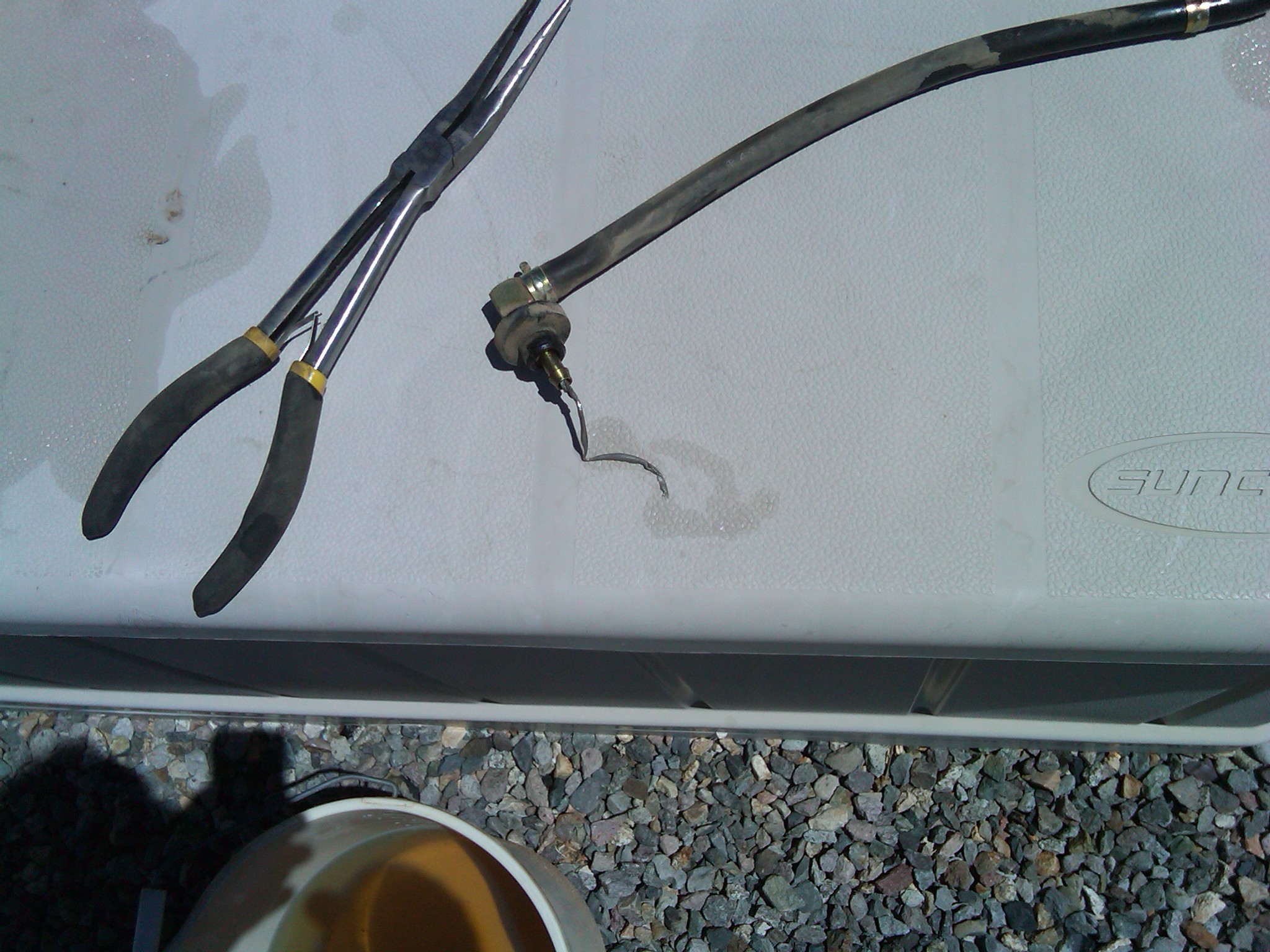

   / Kubota RTV900 stalling #10
Bought a used 2006 RTV 900 last year for light use on 5 acres. Ran retty good but would stall out/cough occasionally mainly on steep trails going downhill and most of the time run fine. Replaced fuel filter and fuel pump to no avail. Finally pulled the tank this weekend. Found abut a 3 inch piece of grey gasket cement in the pickup tube. Picture attached.
