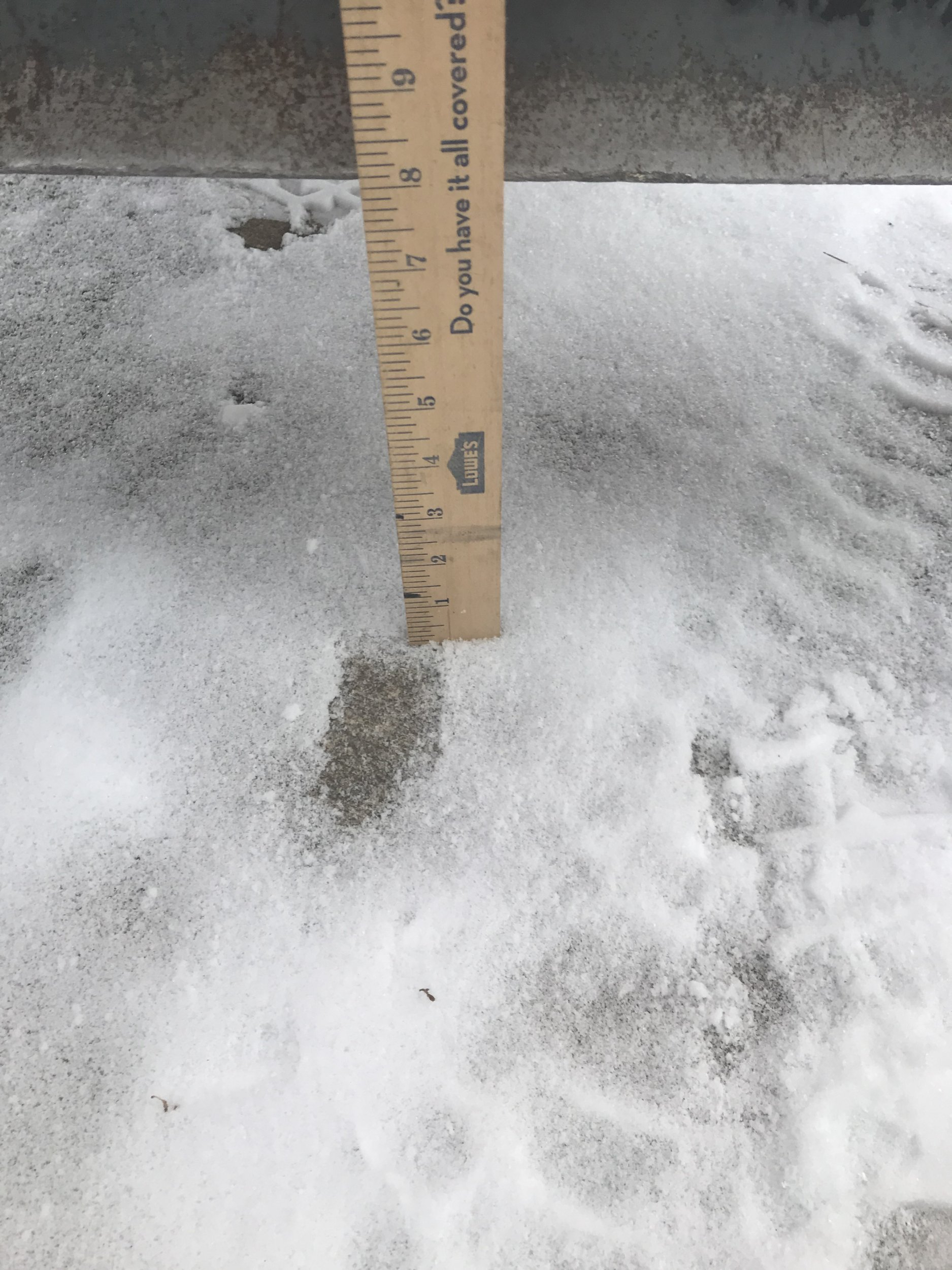

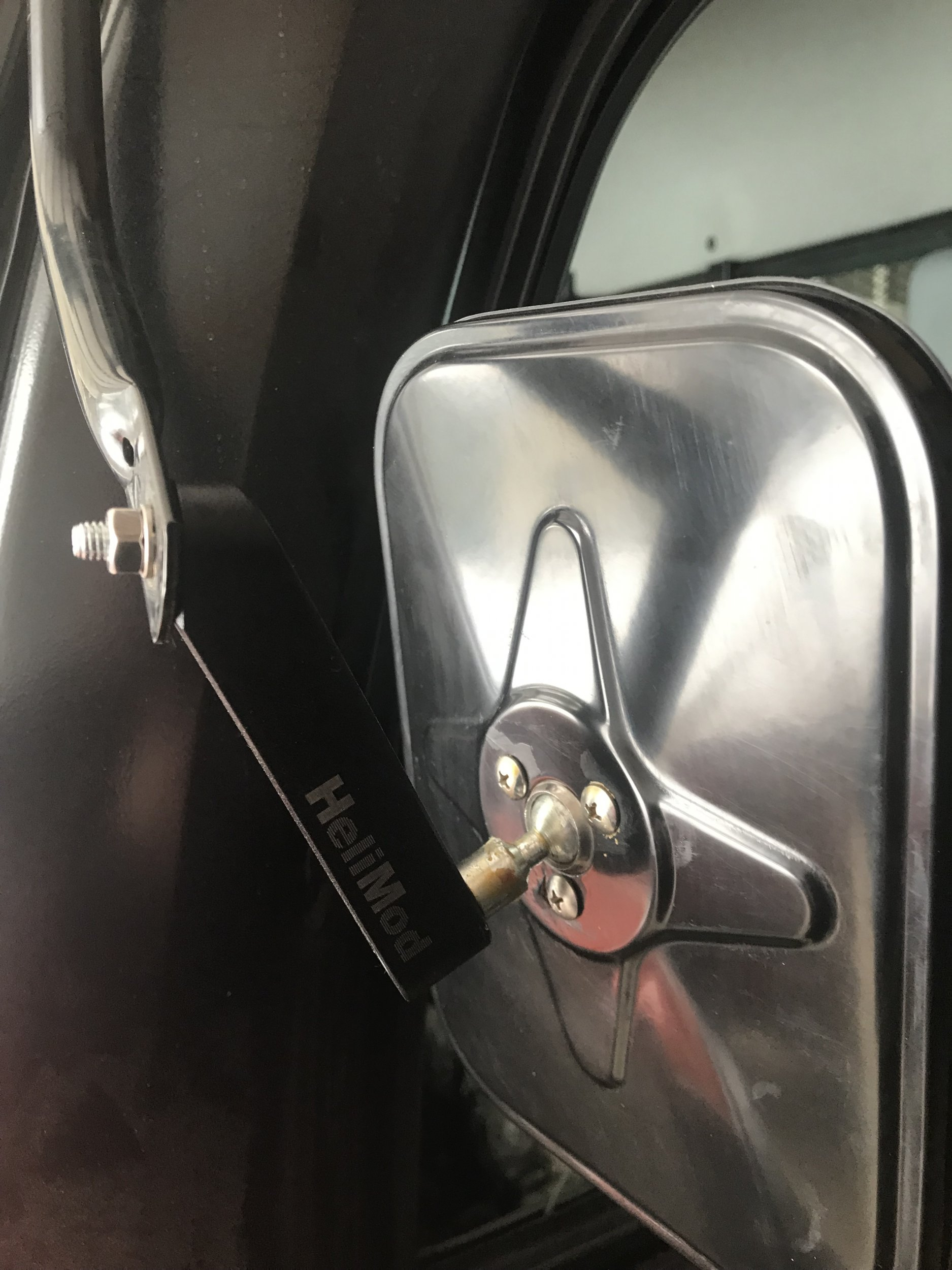

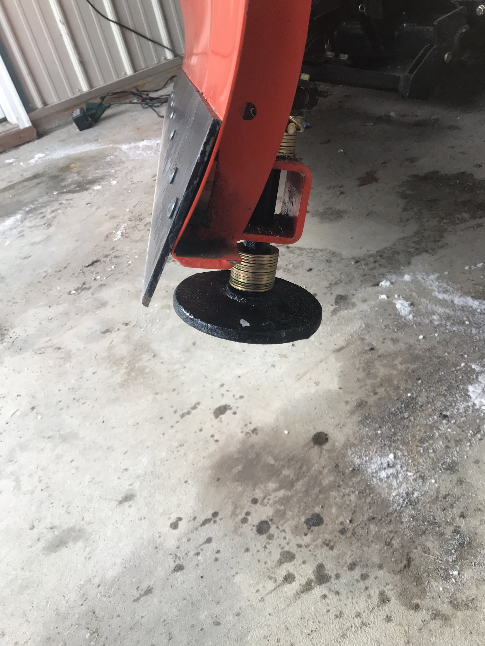

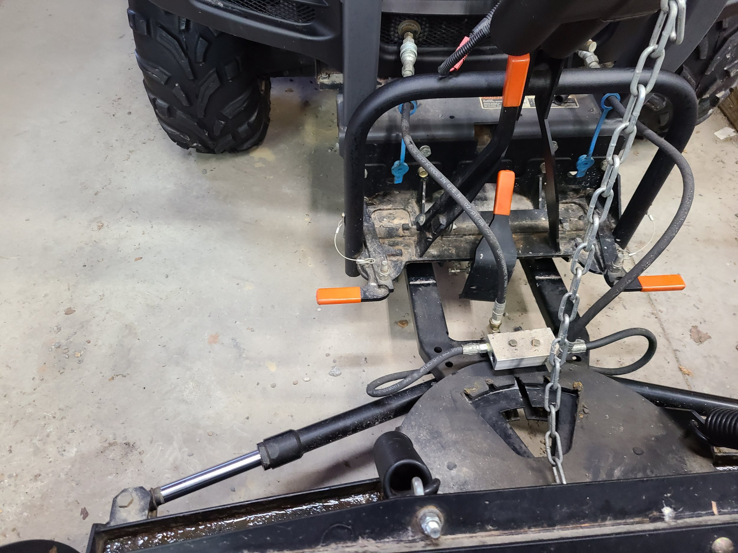

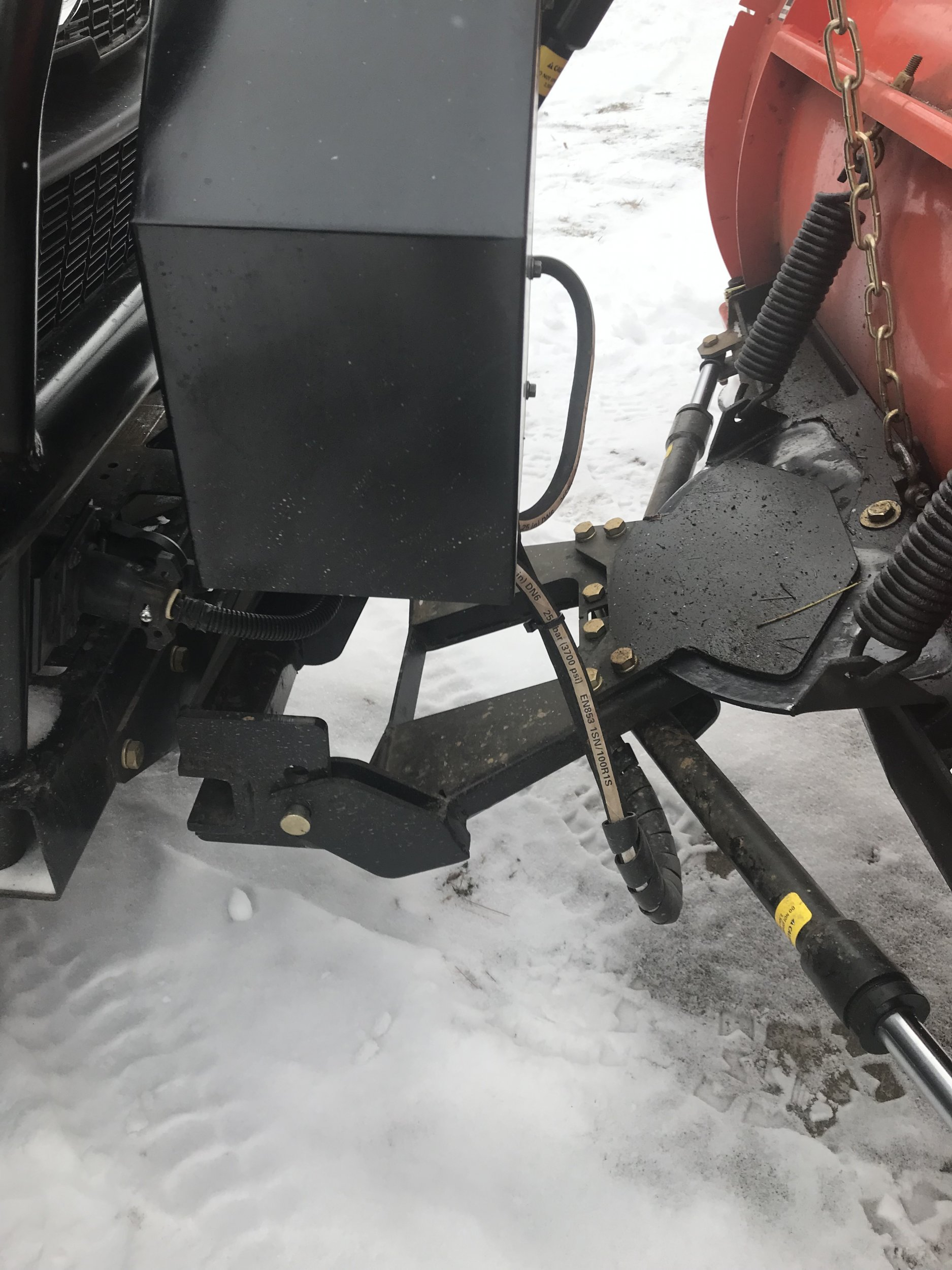

Did a few mods to my 2021 kubota RTV 1100c.Have to say the stock kubota/curtis snow plow skid shoes SUCK.The pic of the skid shoe worn off is after (1) snow plowing on a 1/8 gravel driveway.Next pic is of the new Myers skid shoes 100% better.The last pic is of the helimod mirror extensions on my grote mirrors to see better(move them further out away from the RTV.
   / Kubota RTV 1100c mods. #2
I like those mirrors. Gotta look them up for mine. Curious, how high does your plow lift? My 2009 can only go up around 6" or less and it hits on everything if I'm just driving around. I like the plow but that's a stupid design flaw.
Never used the shoes on mine, I pulled them all the way up and put a machine belt across the botom of the plow so I don't tear up gravel or scratch pavement. Works good.

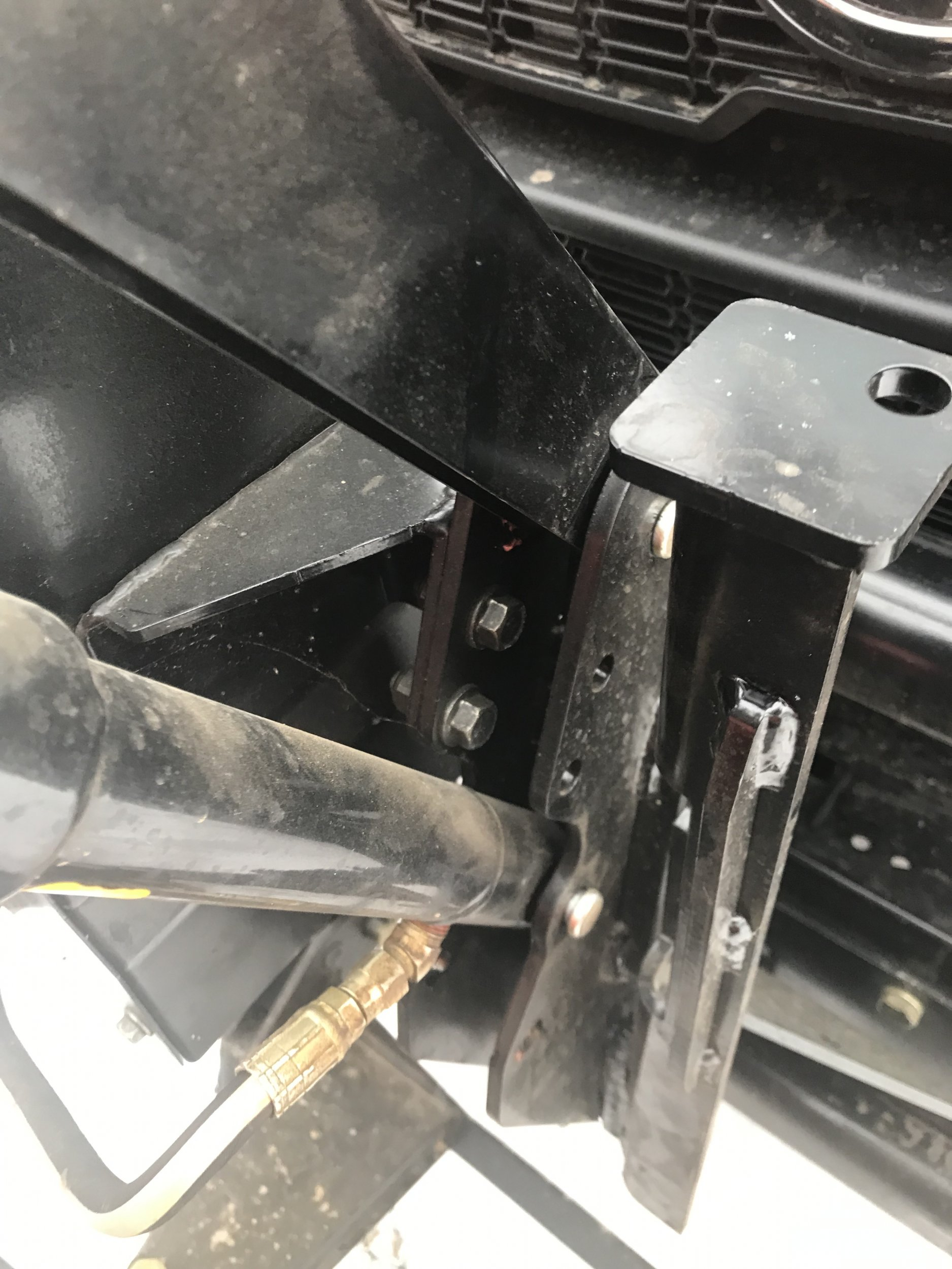

My plow goes up 6-8 inches there are 3 holes for lifting adjustments.
   / Kubota RTV 1100c mods. #4
I could probably live with that. Mine has no adjustments at all. The plow arms hit the mounting frame and that's it. I could block the headlights with my previous RTV500 if I needed to.

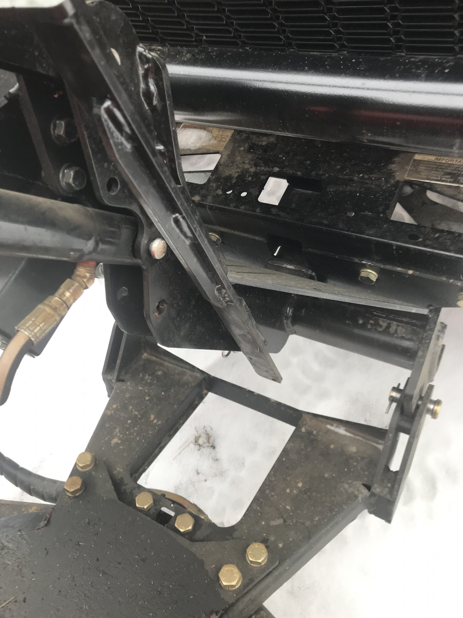

One of these days, can you take a pic behind the plow so I can see how the mounting looks on the new ones.
Yes I will. Around 12 degrees at the moment but will try tomorrow ..
Here are your pics.
   / Kubota RTV 1100c mods. #9
Thanks. Thats a much better design than mine.

They are quit a bit different for sure.
