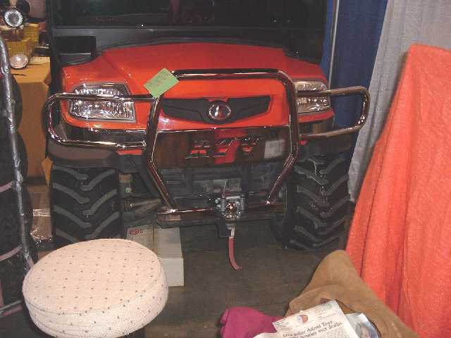

I have seen the RTV with a full set of the 26x12/12 ag tires for the BX and when I replace the tires on mine, I will be at the Kubota dealer pricing a set through whole goods.
Edit:
I knew I had a picture somewhere.
Edit:
I know this is an old thread, but will a 26x12-12 ag lug like a Deestone D405 fit on a stock X1120D rim or do they require different rims. I’m looking for a solution for my RTV X1120D. The machine is used on a farm in W. Michigan. We’ve got lots of mud. I need something that will be good in the mud, snow, and not tear up the grass.
