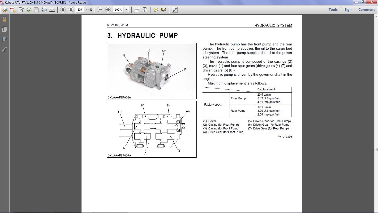

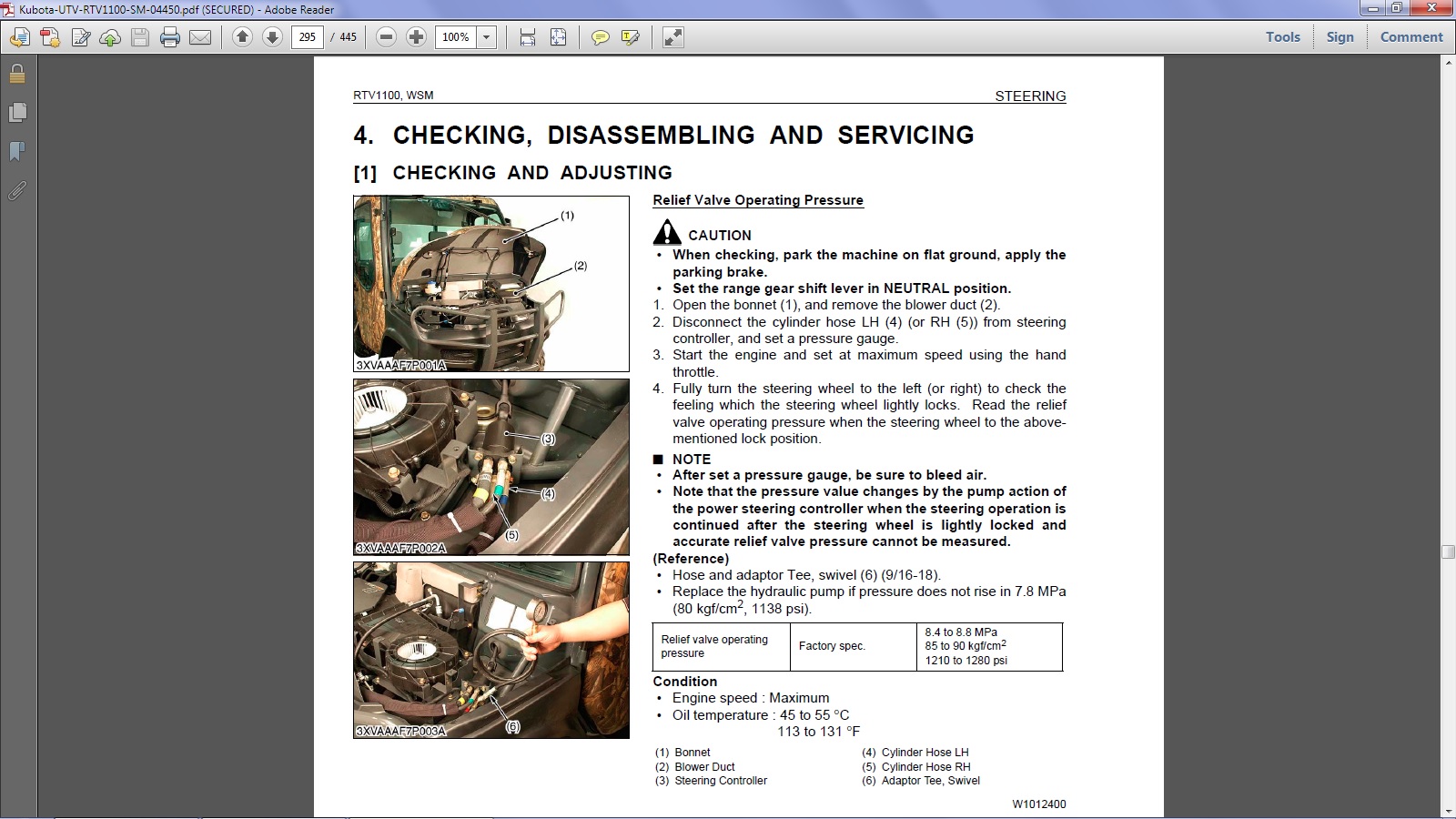

Not sure what year you have, probably doesn't matter in this case, but my 2009 RTV1100 worked well in 8 degree temps with a windchill that put it down even further.
First thoughts would be to change the fluid.
Sounds like weak pump pressure or perhaps bad steering box.
You need a manual to start checking for steering pump re-build options or pressure pump re-build.
One of the three, fluid/steering unit/pump, is bad, which one is the question.
Fluid change is the cheapest and quickest start.
Perhaps these will help.

Pump has two seperate sections, back half for steering and front half for lift each with different flow rates.
Read the specs in the jpg's I posted and you will see what I mean.
I think you don't have the good SUDT like John said above.
Try draining the steering tank first, replace with SUDT or SUDT2 and see if it improves.
Then do the dump tank if you are successful.
Right on with the temps John, damm cold!!!
