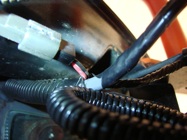

I have a B3000 with front and rear OEM work light kits.
Does anyone know what the Halogen Bulb "Wattage" is that is in those lights?
35Watt, 55Watt ?
Thanks !

I can confirm that the Kubota oem work lights are 35 watts each.
But my problem is the connector.
How did you make your connection from your new LED light to the existing Kubota wire connector?
I don't want to cut the wire connector off of the exiting work lights, so I need to match the connectors.
Any ideas where to find them? I went to my local Kubota dealer today and they said the lights come with the connectors already and they have no source for the connectors.

They look like bullet connectors. I'm use to the cheap ones that have the same crappy red/yellow/blue plastic insulators every other cheap crimp connector has. But the first hit Googling "bullet connector" Google Express looks like it has a decent insulator on it. Possibly like the soft UV resistant one Kubota uses.
I used the really nice Deutch connectors on my build. I need to keep an eye out for the OEM style though. They are on the lollipop hazard lights & the only ones that will fit through a hole the size of the shank on the lights. One of the lights just went out & I was contemplating replacing it with a LED fixture. Too spendy & i dont want to hassle with the connectors. Just going to use a standard 1156 bulb I expect as I have a pile from replacing all the ones in the camper with LED 1156s to conserve battery.
I had the same problem when I did my connection to the "work Light" connector provided by Kubota. I could not find it at any US provider so I looked in the Far East, Japan and China, and sure enough I found the exact ones. I ordered a pack of 25 which actually is 50 because the pack had 25 male and 25 female connectors. You have to look for "T Blade" connectors.

Unfortunately, those aren't the same connectors on my B3000.
The more posts I read about owners installing work lights, I realize that Kubota used many different connectors. It seems no two are the some from tractor to tractor.
Even on my B3000, the front and rear work lights have the connectors reversed. The male and female ends are reversed for the front set and rear set. The front lights have a male connector coming from the light, and the rear light has a female connector coming from the light.
It's so odd, and I can't understand why it's like that.
I thought it would be a pretty easy task to remove the old work lights and install the LED lights, but it's not.
