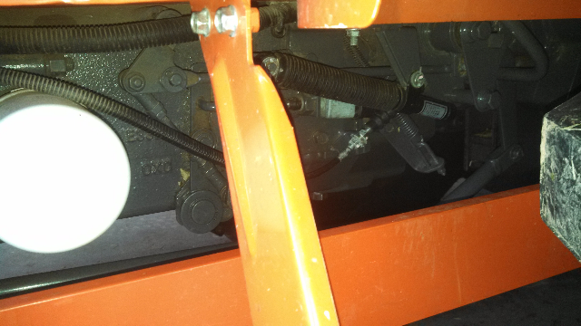

   / Kubota MX5100 engine cutting out issue #4
First pic is kinda showing you the location

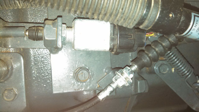

This pic is showing the actual place. You will adjust the silver nut on the left.
When I adjusted mine I turned the key to the on position and turned the nut unit I heard a click which is the safety switching to where it needs to be. It actually the HST pedal that is out of adjustment. any questions left me know

Can I assume it's the silver nut in front of the white thingy? I'll try this when I go get to the farm this week. Thanks a bunch.

I know this is an older thread, but I had this problem and have additional information. My MX5100 HST would cutoff when I got off the seat - when it should have continued to run. After reading this thread, I adjusted the switch (note that the switch should be depressed when the HST pedal is in the neutral position). The same problem started happening again. After crawling under the tractor to see what was going on, I discovered that the switch was separating from the metal housing. I removed the switch completely and took it to the workshop for inspection. I found that there are 2 indentations in the plastic part of the switch where the metal casing should be crimped into in order to hold the 2 parts (the metal housing and the plastic switch) together. I pushed the 2 pieces together completely and used a hammer and a punch to crimp the housing. I have no problems now. In my situation, adjusting the switch initially worked for a short time until the housing separated a little further and this would cause the problem to reoccur. Crimping the house should fix this forever

I just read your fix and it was exactly the problem. thank you. land baron
