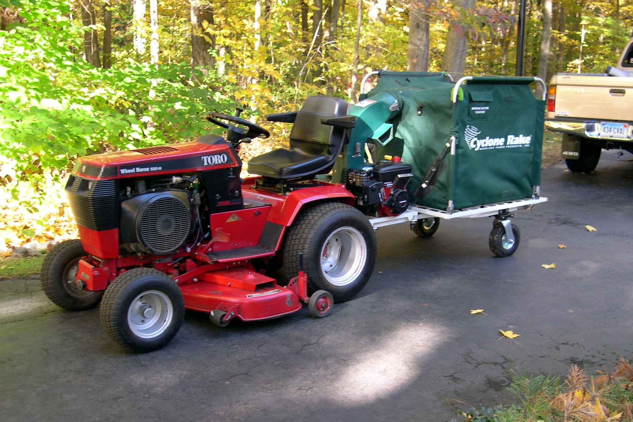

Dave, I don't think you're crazy at all for looking into a dedicated mower/leaf pick up machine. In fact, that's the basic set up I have with my 1993 Wheel Horse 520H and BX25. And, I have the mmm for the BX and even purchased the equipment to hook up my Cyclone Rake to my BX25 - didn't cost $500, maybe $200 but I don't recall the specific costs. I will warn that you will have some maintenance and repair issues from time to time with an older, heavy duty garden tractor, but fewer problems I'm sure than with your Craftsman. In fact, that's why I bought the hardware to hook my CR to the BX25. A few falls ago, my Wheel Horse fried a voltage regulator before I could complete the leaf clean up work, so I had to finish up with my BX. Now I have it as a back up should the WH go down for any reason. It's also great to finish up doing dirt work or other loader/BH work with the BX25, then jump on the Wheel Horse to mow the lawn. No need to mount/dismount a MMM on the BX.
Having owned a CR since 2004, I know that it can get very heavy when the leaves are damp and it's a lot of weight for any lawn tractor to pull even on a flat surface, never mind any kind of incline. I've always thought their ads showing low end tractors hooked up to a Cyclone Rake were a little misleading. I bet a lot of tractors pulling these rakes aren't rated for the weight once it's full of wet or even dry leaves.
I'll end by throwing in a plug for getting an older WH garden tractor. The rear ends are all cast iron/steel and they're very durable as a pulling tractor. Depending on where in the USA you are (don't know about MI), they're pretty plentiful, usually cheaper than a JD and just as tough. Parts are still readily available as far as I've seen, though Toro is starting to price things a bit dearly. On the downside, you probably won't see many with decks larger than 48", though they made a 60" for the top HP models.

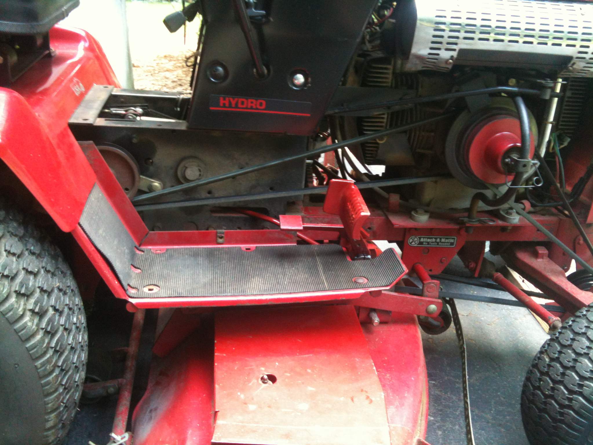

One mod I did recently to my WH was to add an aftermarket foot peddle for the HST. You may find tying up your right hand to run the HST lever annoying if you're use to a foot-controlled HST tractor. That's the way they all come now for good reason. Anyway, once upon a time, WH sold a kit to convert many of there lever controlled HST's to foot controlled. I found a guy near me in CT that reproduces the kit for a reasonable price. Here's a link for you to check it out. Maybe after you've used yours a while you can decide if the hand lever is good enough. I will say, this was the best mod I made to mine, though I haven't really made any other significant ones come to think of it. but mowing is much more enjoyable now with the foot control. Best of all, you can leave the hand lever connected too, with a small mod. I tend to use the foot pedal for forward and the lever for reverse.

By the way, here's a pic of my HST pedal on my WH

I may consider that pedal mod down the road. My BX is a foot pedal and the Craftsman is a hand lever so I'm used to both. The guy I'm buying the tractor from is a trained mechanic and from our conversations on the phone has kept up on all the maintenance items in the manuals for everything on the factory recommended schedules. Assuming all this is true, I should be getting a machine in pretty good condition. Picking it up tomorrow. Already cleared a space in the garage for it. ;-)
Nice pic on the pedal mod. Looks easy to use.
