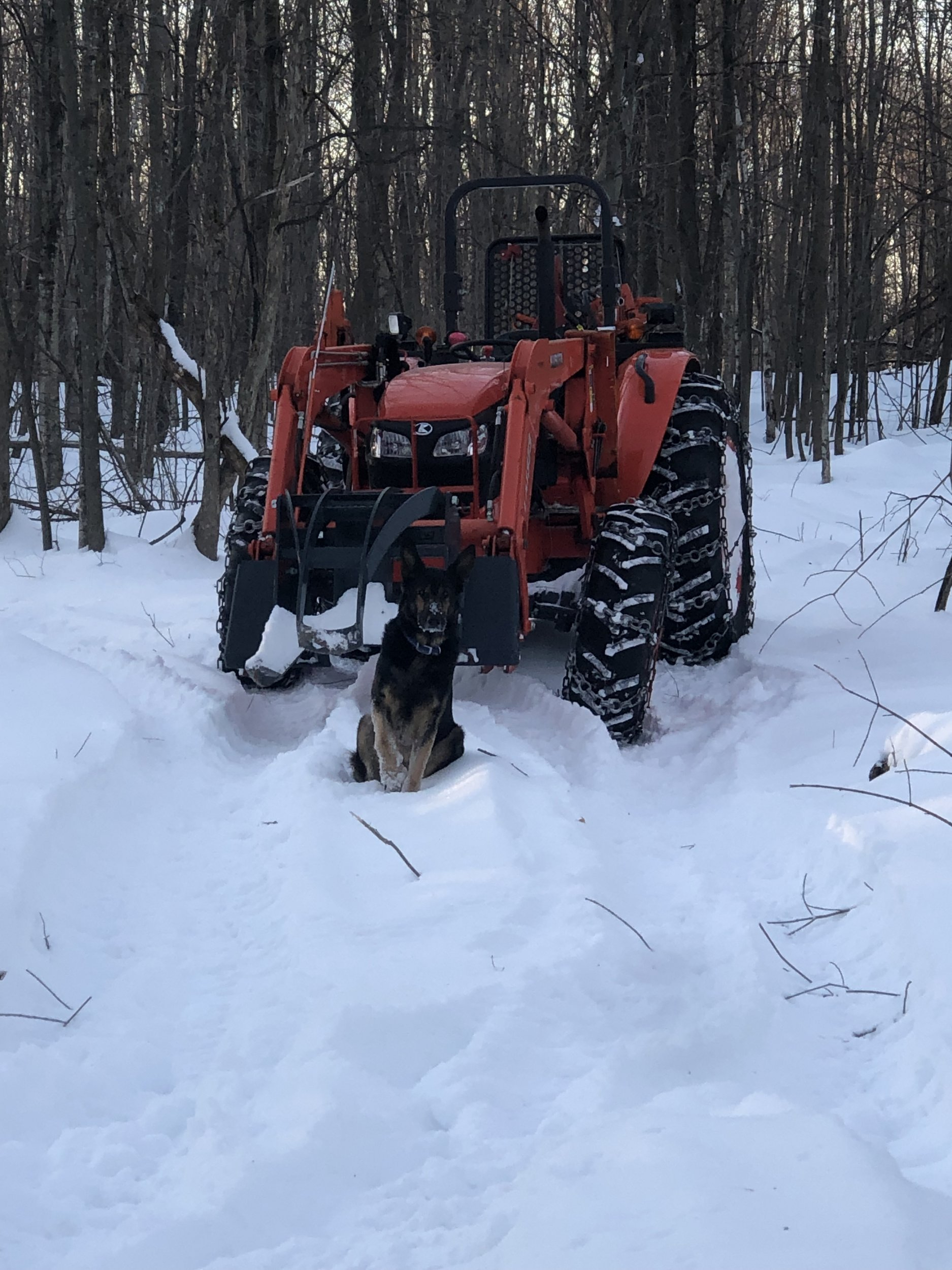

Having an issue with my m8560
There’s a loud chatter/hammering noise coming from the transmission I believe! Dealer has had it apart and found nothing. The noise can only be heard with the hyd shuttle in forward or reverse. If you activate any hydraulic function it magnifies the noise. Also does it with the transmission in neutral . Is there a way to download videos? Thanks

Is it the Rops rattling?! Or something in a tool box?! Sorry for not being helpful :). Nice grapple by the way! (And dog!)
