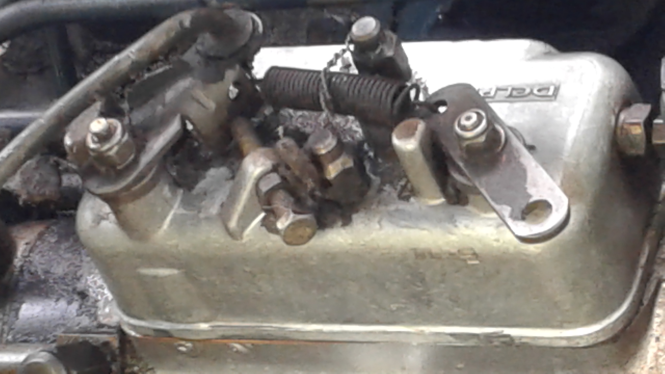

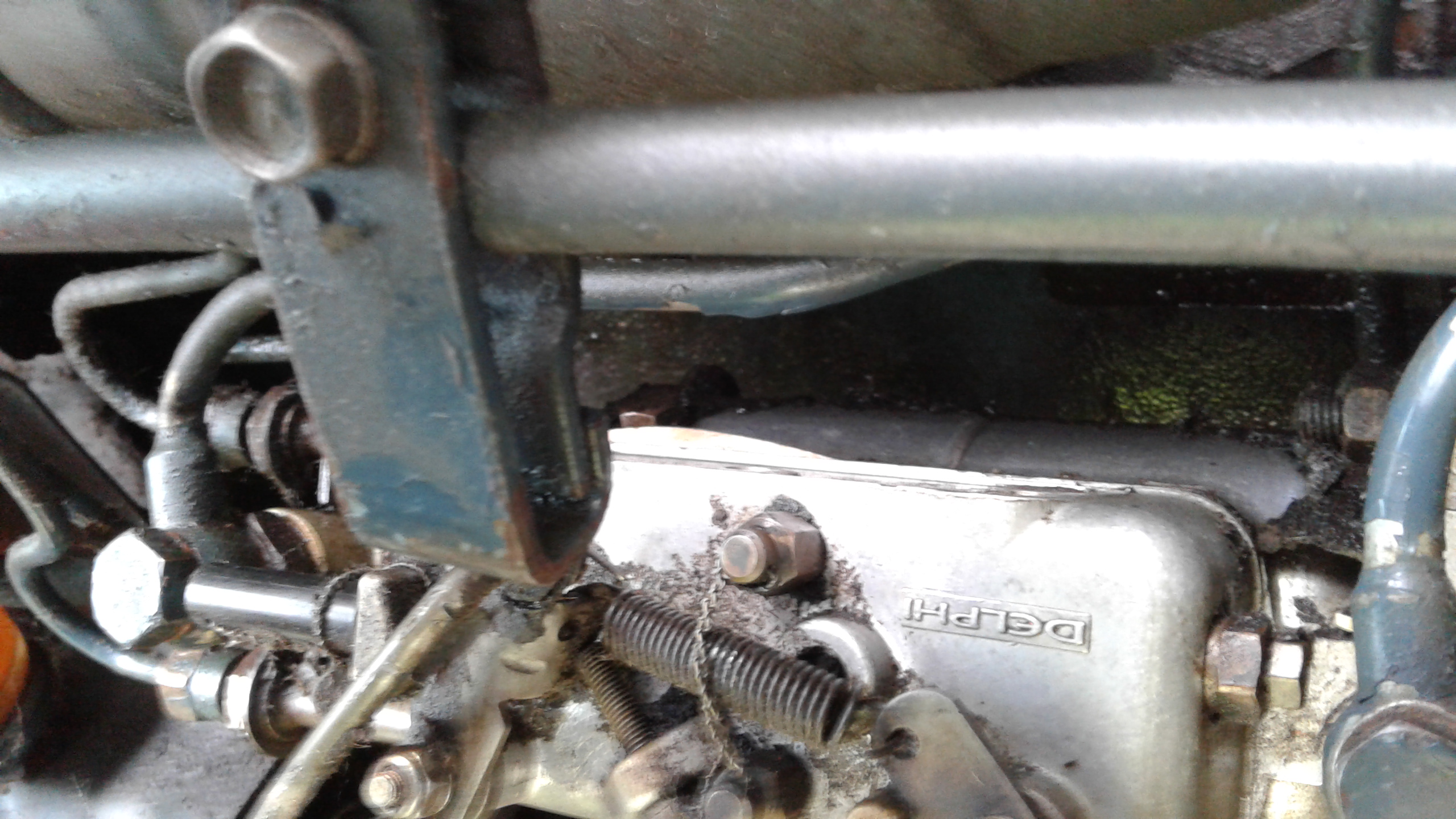

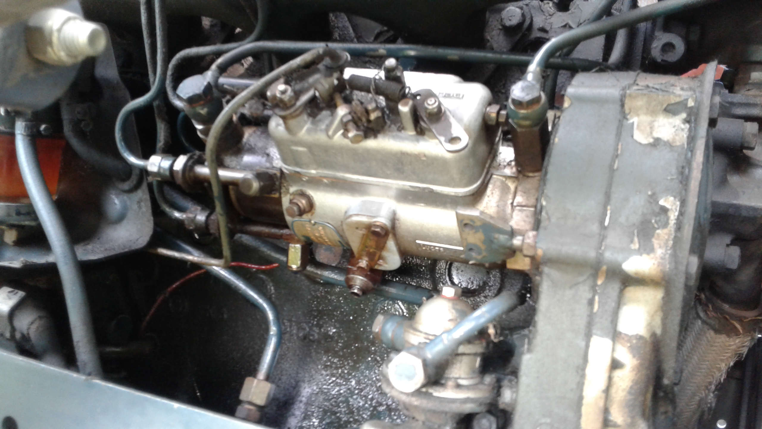

Neighbor has a Kubota M7950DT with fuel spraying out of what looks like a gasket on the right hand side of engine, to the rear. There is a shiny box with the word DELPHI embossed and in the upper left, a white gasket can be seen, (it has an un-even edge). Fuel sprays out at this gasket location. Has anyone any experience in changing this gasket? Is it something that needs a trained tech or is it pure and simple nut and bolt job? Any help is most appreciated.

Its a simple fix & less than 10.00.. Google CAV top cover leak & theres LOTS of videos on utube.. Delphi has bought out CAV..
The gasket # 7180-451
there ARE 2 FIBER WASHERS UNDER THE TOP COVER NUTS>5339-970
You may want to consider changing the 4 orings on the shafts too>7185-950
You might wanna check the return line going back to the tank and/or change the fuel filter.. it looks like a pressure build up problem..
GOOD LUCK & LET US KNOW HOW IT GOES..

Well, did the job today, stopped the fuel spraying out of top cover with the kit that came with gasket, four o-rings and two top cover nut/washers. I did it still fitted to the tractor and all went pretty good except for the hook lever trying to slip out of place. Ended up using some black thread looped around lever and out the top of block. When the cap was placed on and aligned,I pulled one end of thread until all came out the top. Seems to be working well. Thank You, again, for pointing me in the right direction, much appreciated. Bob
