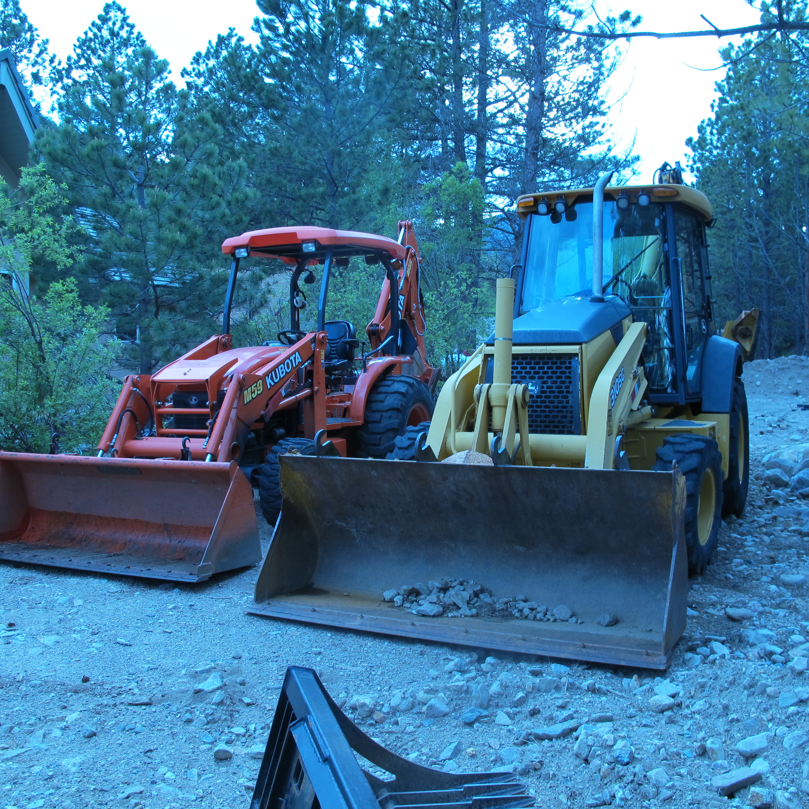

Hello lm, kicking out of gear is not a problem that I've heard of with the M59. In fact, the complaint is more often that the shifter on the M59 is difficult to move between ranges - possibly because the shifter detent mechanism is overly conservative. I know mine sure is hard to shift between ranges and all the others I've driven are too. But I can see what you mean about working on hillsides.....I hadn't thought about it, but when working on a slope I also depend on transmission braking to stay in control. So much so that I rarely use the brakes. And I never, ever shift ranges when moving or on a slope; that would be just asking for trouble. Probably most of us work the same way.
Back when the M59 first came out, Charles started a thread so that owners of this new species of Kubota could share thoughts. It finally went to 44 pages and is still going - although slowly now that M59s are more common. You might want to search on: M59 Discussion Thread and see if anyone has mentioned kicking out of gear. The thread is pretty good reading overall. Several of us live in mountainous country and one of the things that got us onto M59s is the slope stability.
I have had my M59 kick out of gear - but only once in 9 years. I remember it distinctly because it just happened last weekend. Here's what happened: I had been moving dirt on flat ground and stopped to shift from M into H range.....after the typical wrestling session with the lever I stepped on the go pedal just at the same instant that it flashed on my consciousness that the lever didn't feel like it had moved the right amount. We hadn't even started forward - the M59 was just sort of gathering itself - when there as a slight "pop" sound and all motion stopped. I glanced down, saw that the lever wasn't quite home in H and that the reason might have been because my leather glove had fallen against the back of the shifter lever. Anyway, after stowing the glove and shifting the lever properly into high we carried on. Nothing seemed damaged. So the only time it has happened to me I think it was operator error, no harm and no foul. My feeling is that one was on me and not on the tractor. And I feel good that it happened when shifting into H, not into Med. or Low. Because of the way the range shifter works I'm better at pushing it into L or M than pulling it into H. Frankly I'm kinda sloppy about shifting into High, maybe because that's the traveling gear rather than a working gear.
The key thing I take away from that is the tractor never really started to move before it kicked out of gear. And it reinforced that I'll never even be tempted to shift ranges while working on a slope. Now I will say that it it ever happens that it kicks out of gear after I've been working in a range for awhile then that would be a completely different situation. In that case I would be very concerned. At the least I'd be worried enough to take a serious look at the shifter mechanism. But so far I haven't seen or heard of that happening.
Please let us know how it turns out,
rScotty
