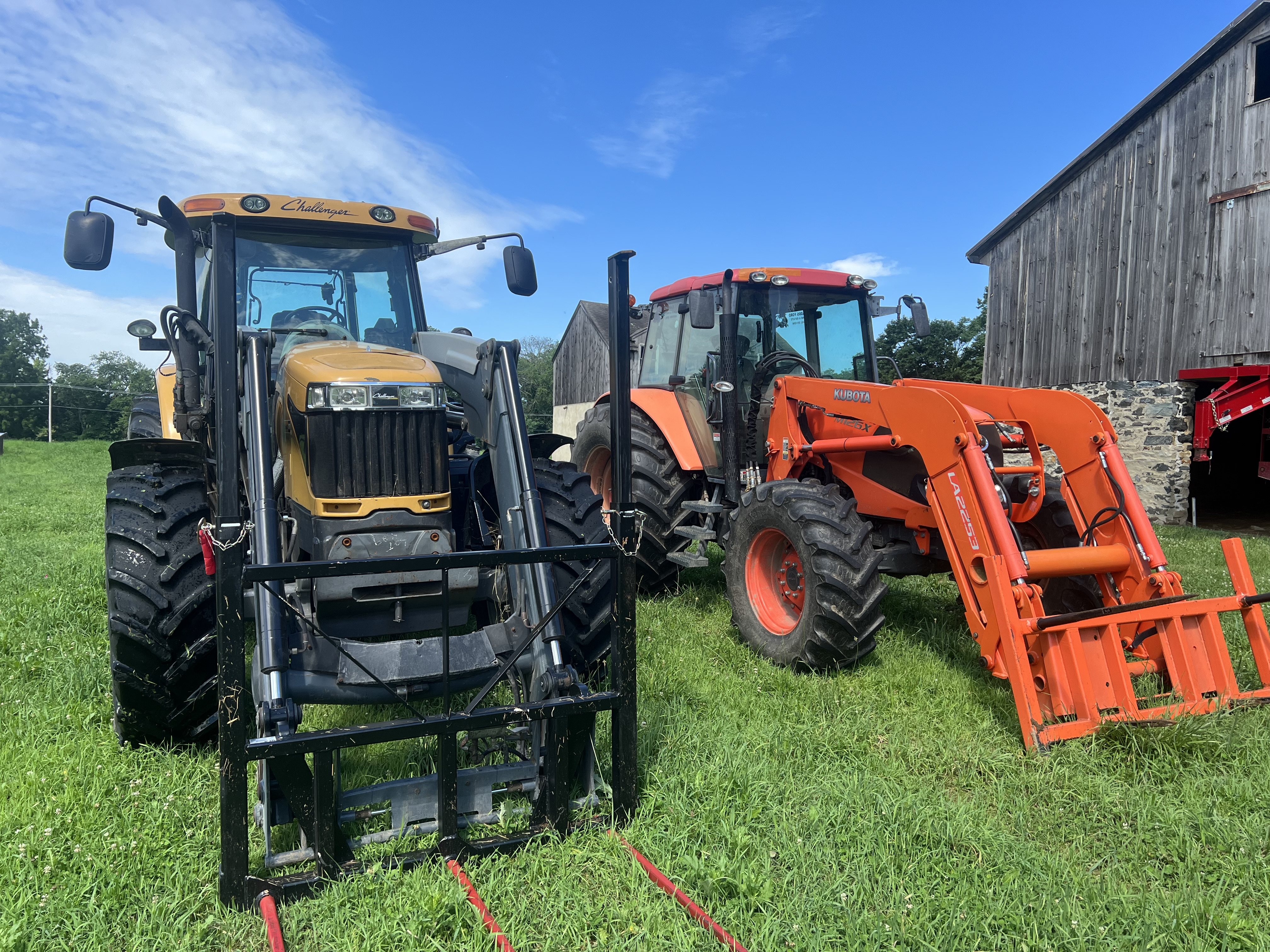

#14
I saw a Challenger but I didn't look at it cause I didn't know anything about them. Maybe I'll check back and look. I talked with the place that has the Ford for sale. It must be a one man show cause he just answered the phone, hello. I thought I was calling a place of business. He said he would have to see if his neighbor could get some videos of the tractor running to be able to send them to me....

Look at the weight and the drawbar HP. Make sure you have dealer backup from an AG dealer in your area. Kubota has a million dealers but few are AG. Most are commercial or hobby/ranch.
I like MF, Challenger, AGCO because I get a lot of CVT & Fendt drivetrain in them. Don't forget Deere. Lots of people hate on them, but they are very solid in 100+ HP
