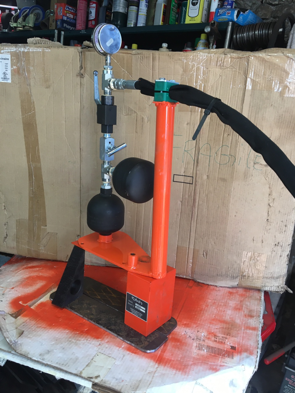

I took the cylinder elbow, accumulators, valves, pressure gauge and measurements for a new line to a good hydraulic shop. British threads on pipe and o-ring sealing has been a problem before. Bench assembled at their shop. The old guy took the opportunity to school the young pups. British straight and tapered are common on robotics. This particular shop caters to that industry so they stock everything.
If I recall on the M59 the cylinder fitting was British male taper and two jic#8 to the hoses. One hose OEM and other to accumulators.
Soft ride makes a remarkable difference doing loader work and highly recommended. Had the hose from the cylinder tee to the accumulators armored with a external spring for extra protection.

When I took the OEM elbow from the M59 FEL boom cylinder to match it had an O-ring above the obvious tapered threads. It was sealing nothing. The shop even asked what was the o-ring was for? It was not a surface sealing type of fitting. Just one of several oddities I’ve found.
I cannibalized some of the soft ride hardware to fit my application.
Modern tractors have done a better job of ergonomically isolating hydraulics from the operators in case of leaks or failures. I placed the majority of the soft ride components behind a OEM plexiglas window/shield for operator protection. Those accumulators store a lot of potential energy. Just something to consider. Bought some accumulators off eBay to use for a B26 loader soft ride system. One accumulator bulb might work for its’ size. Still pondering on how best to mount and shield.

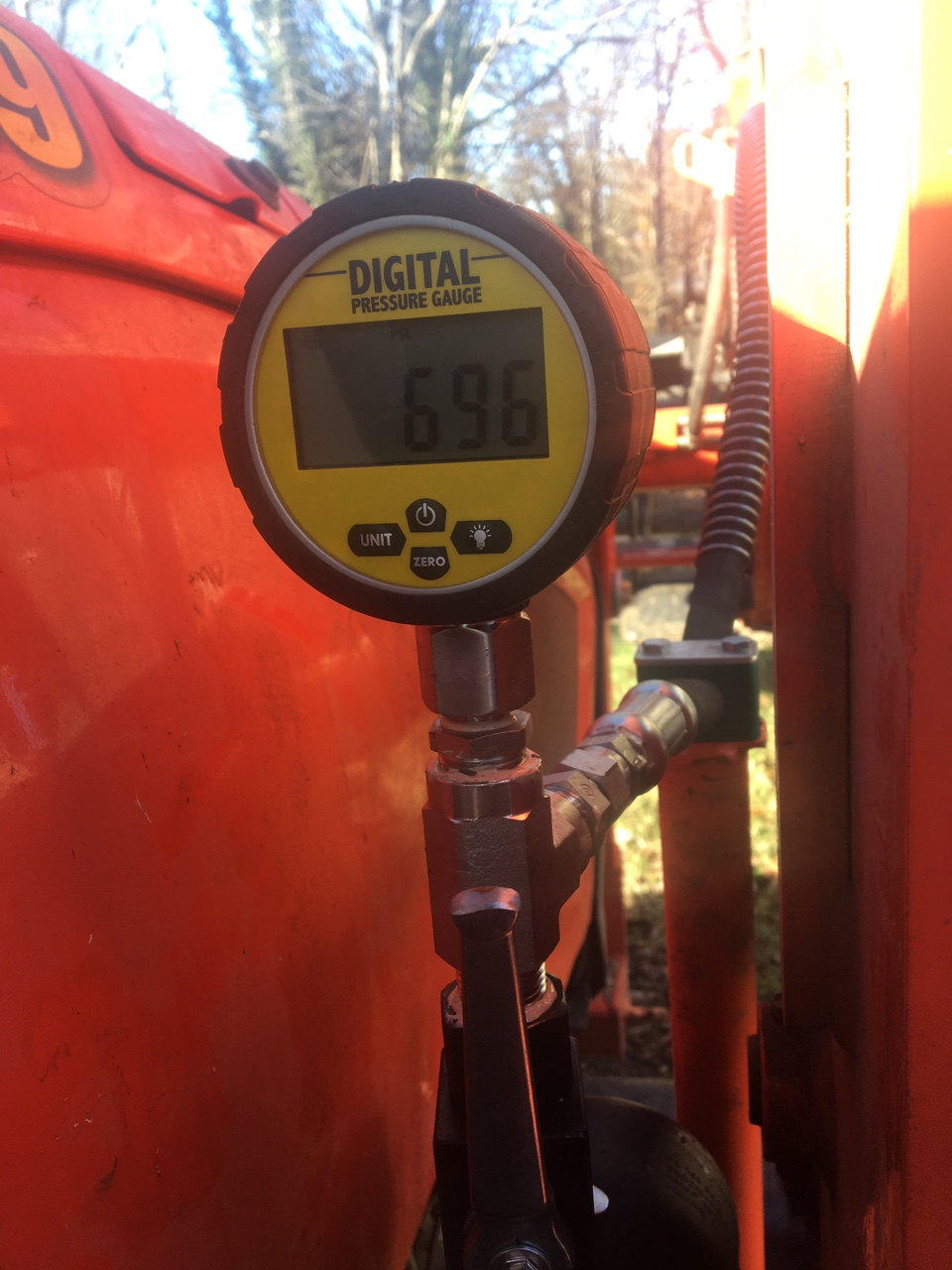

Smokey, did you have a thread somewhere else about your gauge? I remember someone doing something to measure the weight they were lifting.
I dunno how much difference would be between any of these accumulators, but my loader only has one bottle. (~2500#capacity)
Jon, I had a hard time measuring my threads with a pitch gauge, im sure the shop is good enough to tell easily!
