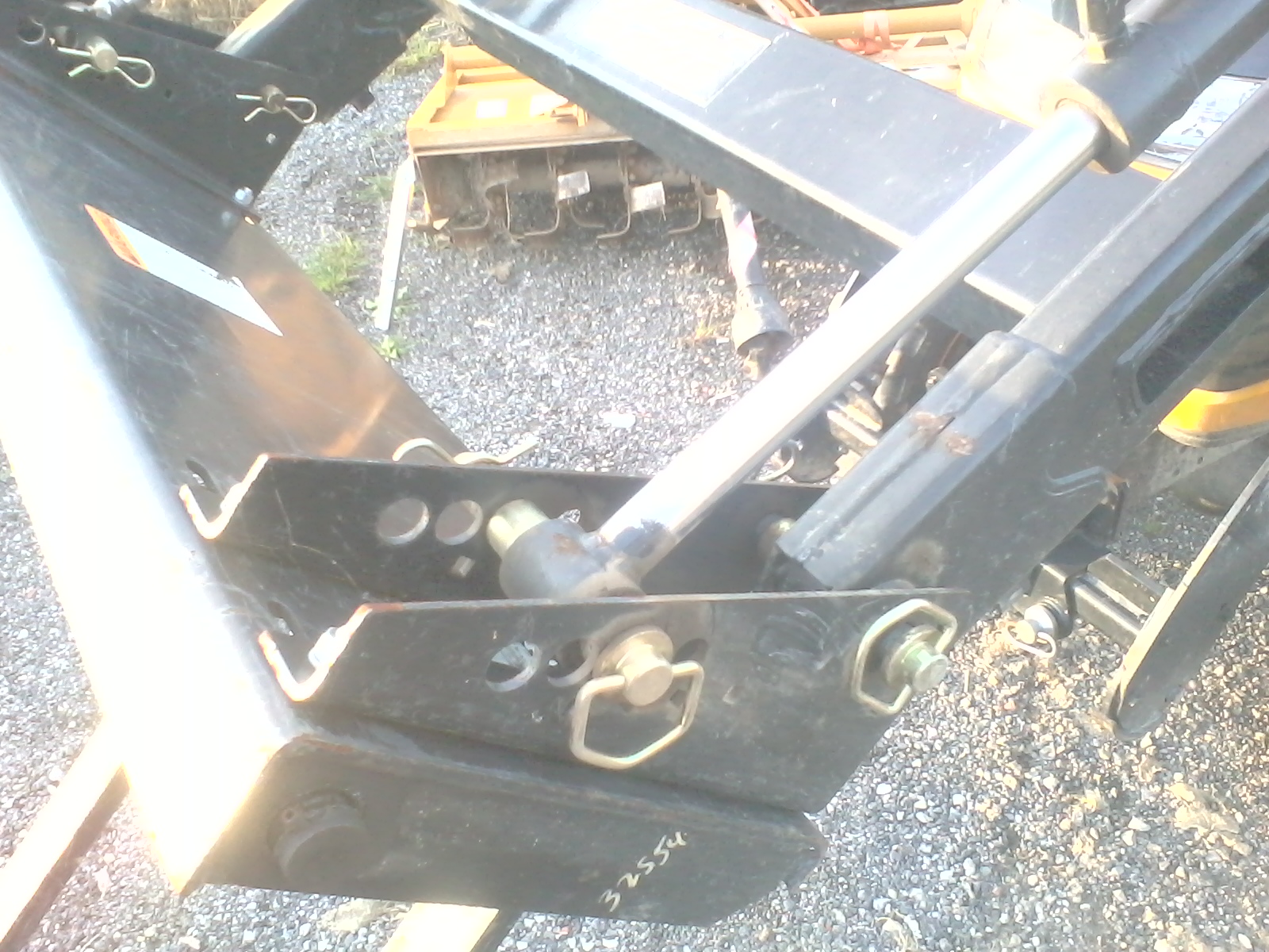

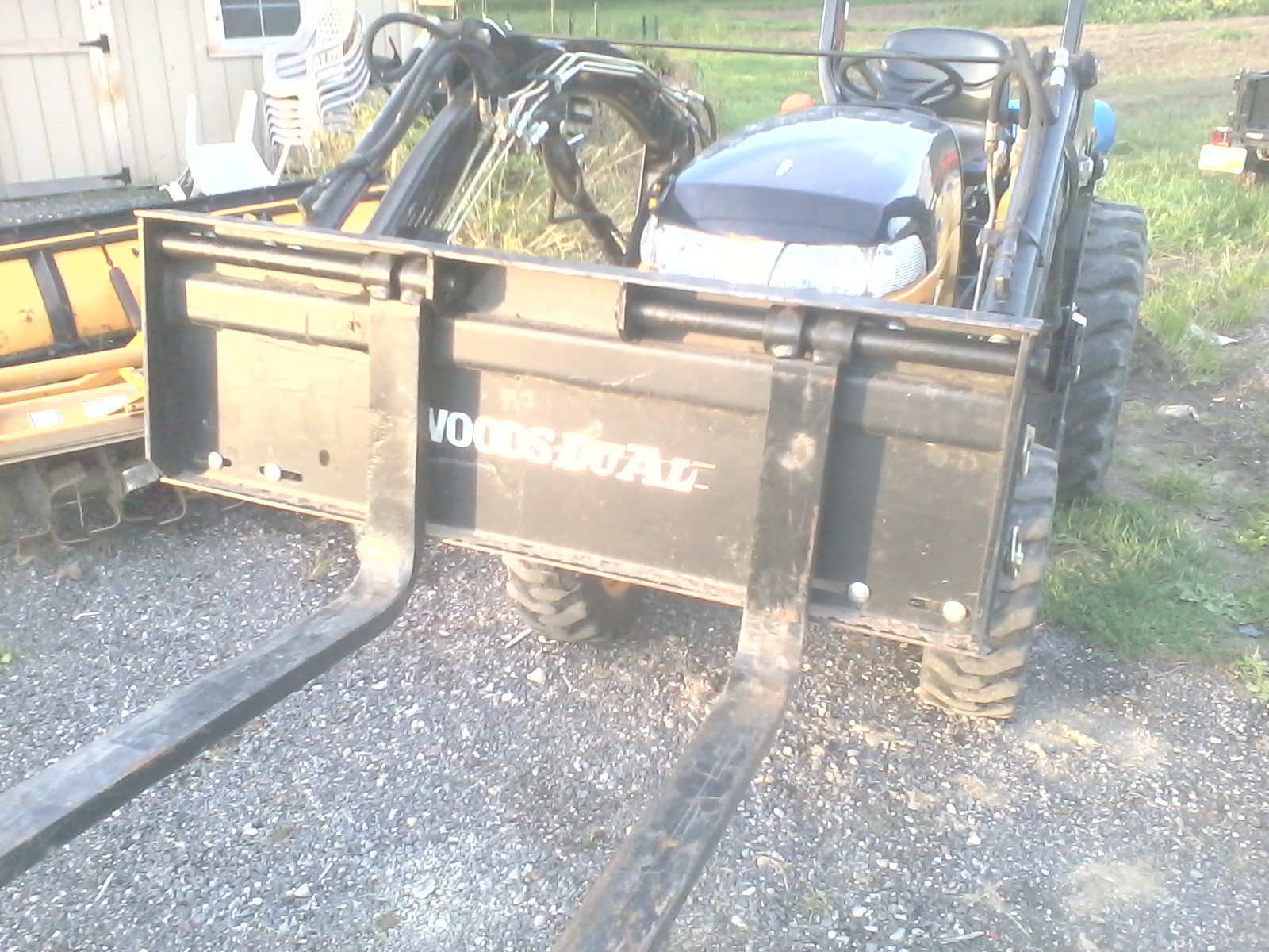

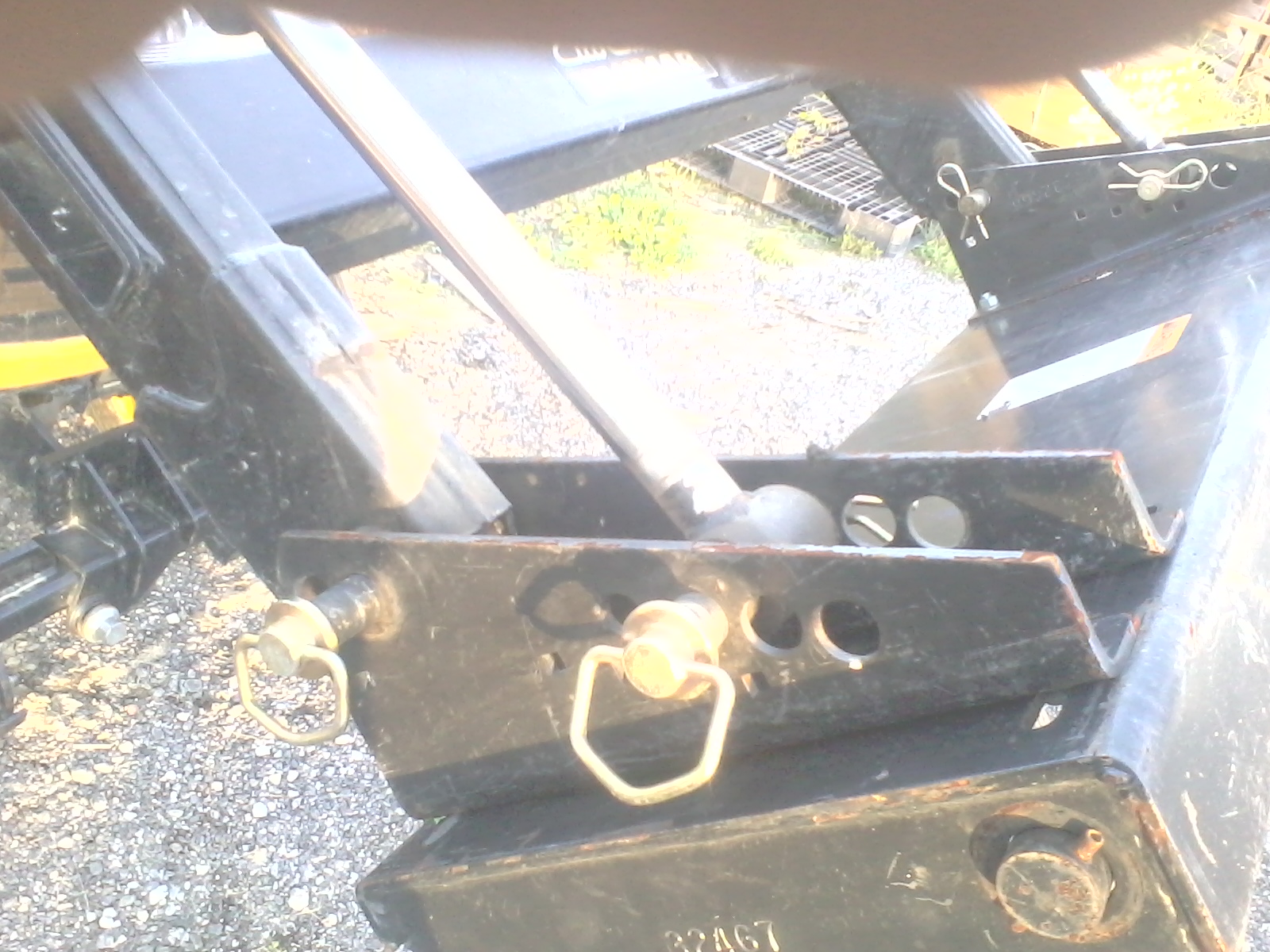

I think this is what you're looking for, this is a model 20 woods forks (no longer made) but look for MODEL 20A PALLET FORK ASSEMBLY (the next model) you can find parts drawings to help with your design. I bought pins and sleeves at TSC to mount on my cub yanmar.
