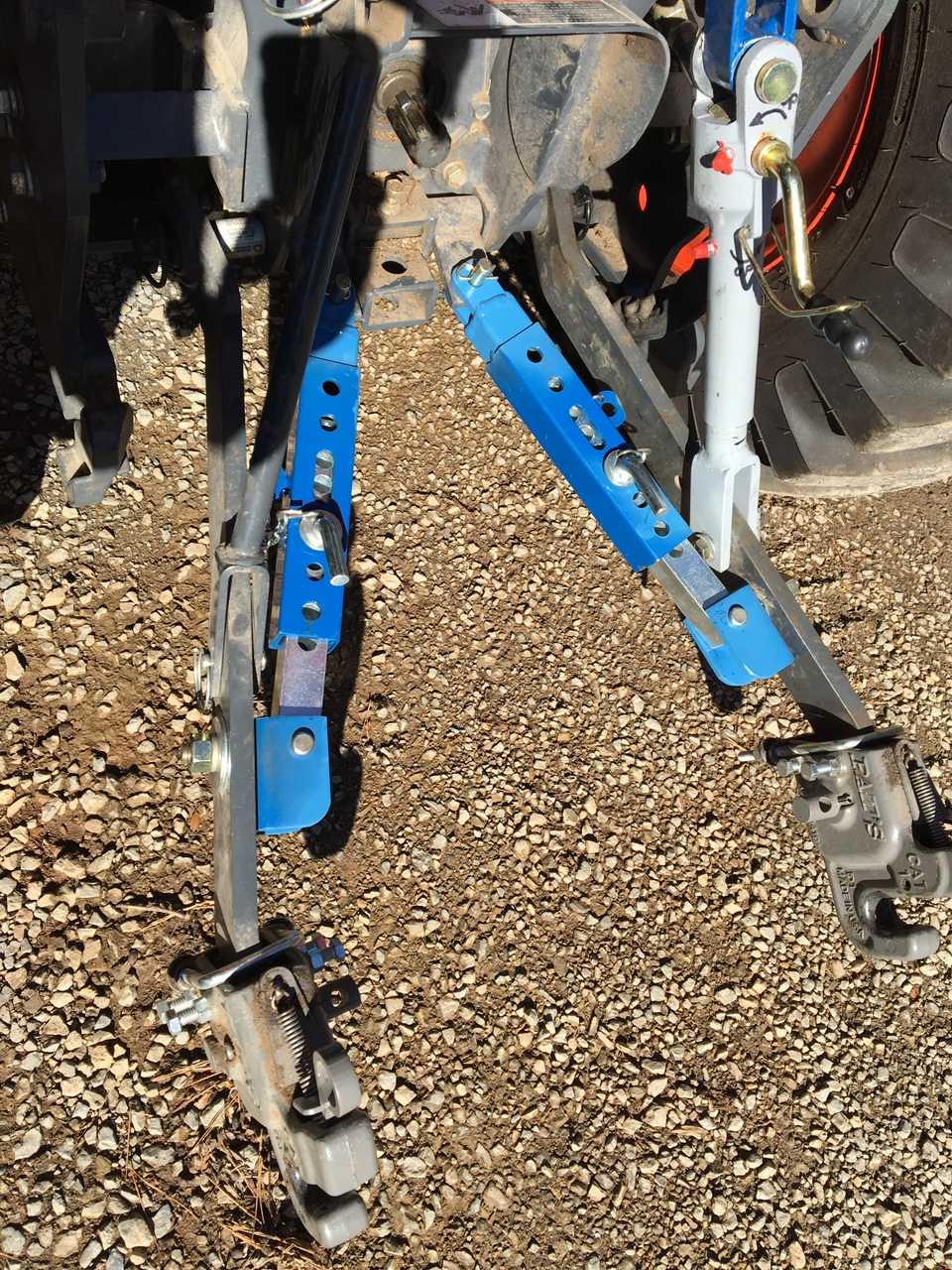

Kubota B26
Weaver’s tractor had several leveling box options. Giving good detail on specs on length and styles. Makes adjustment easy.
Note the blue U at top of level box. To fit my application required a left over piece from modifying the pin style sway control bars. They had those too.
   / Kubota Link Arms #8
Telescoping sway braces and extending drag links are the bomb. Add hydraulic lift and tilt and you got a dream machine ;)
