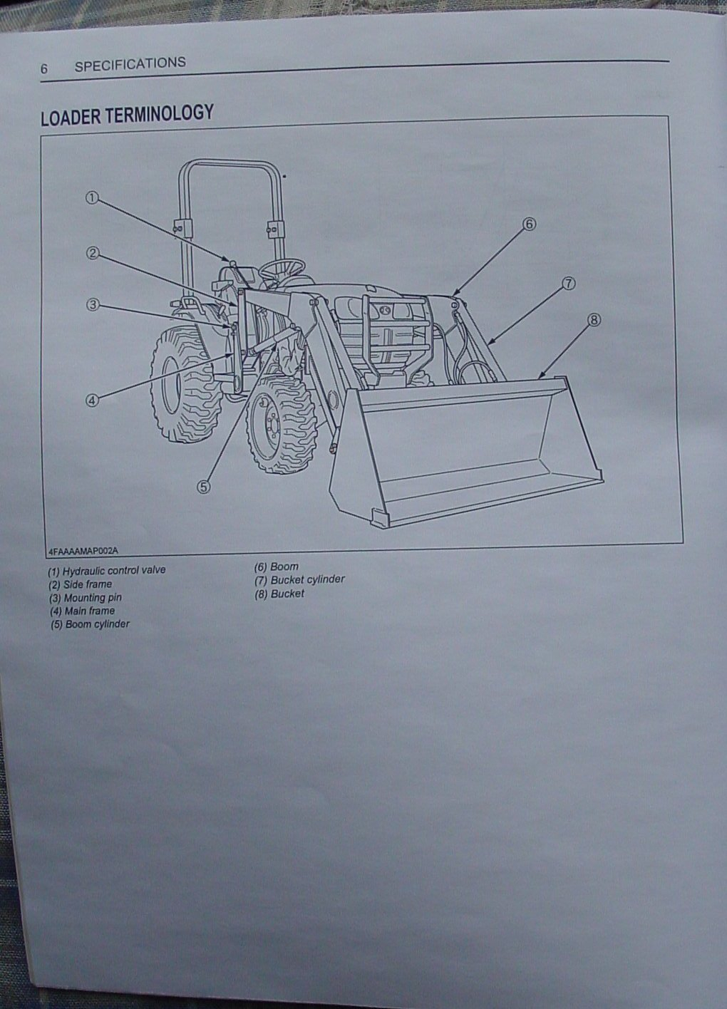

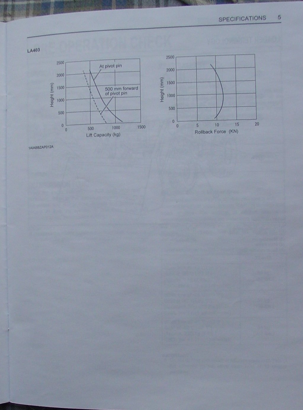

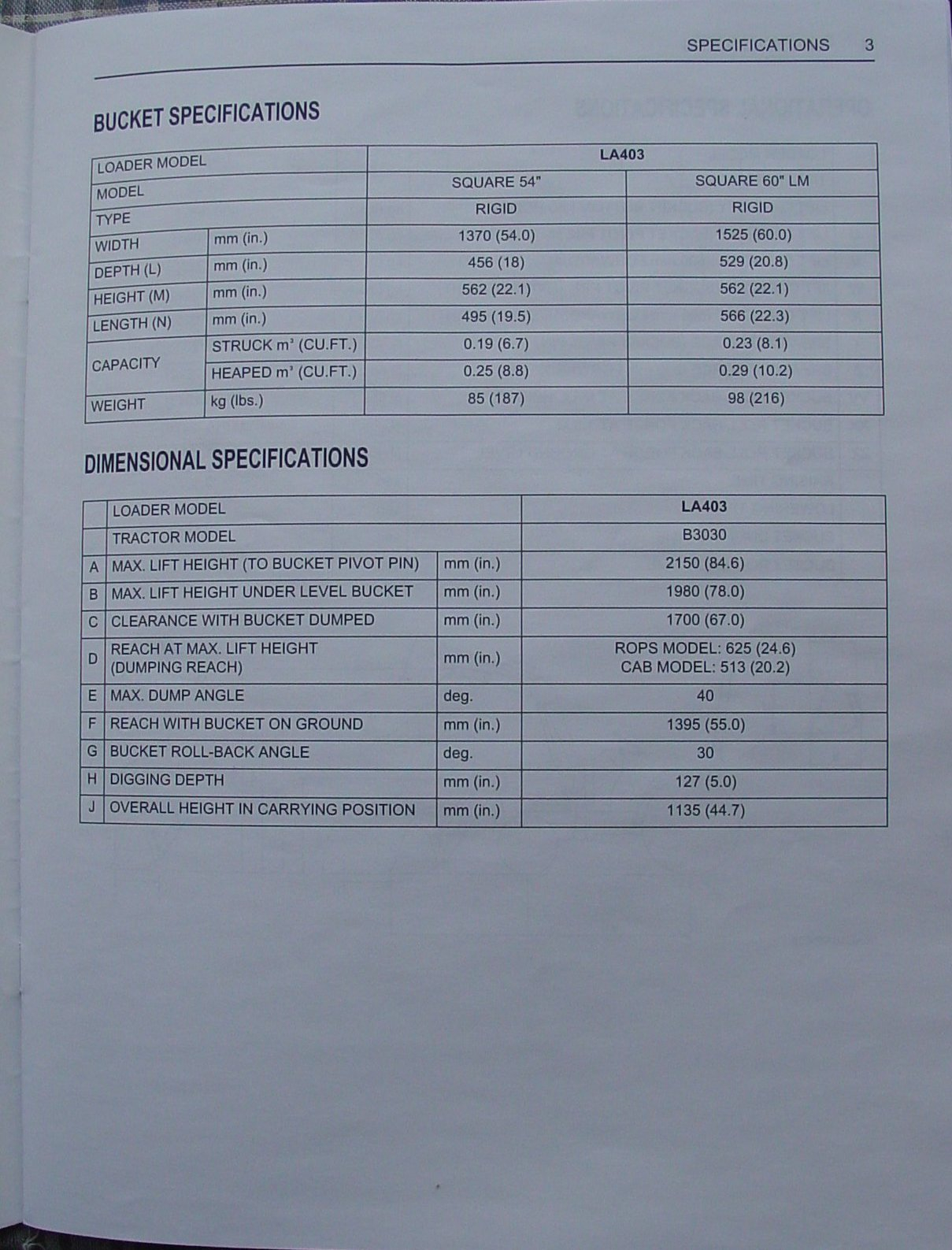

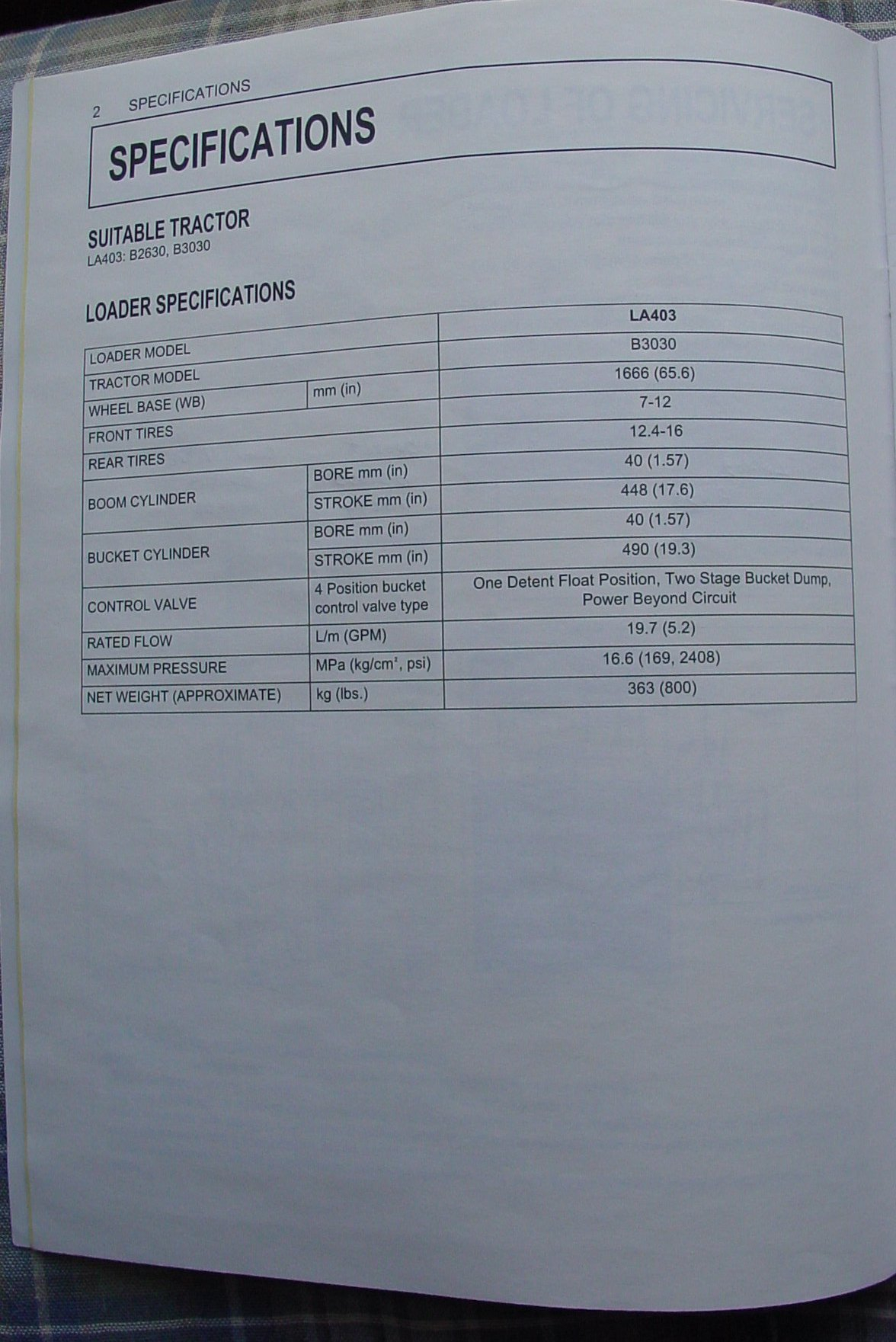

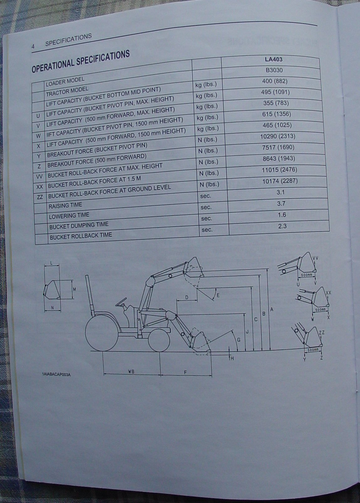

I am having trouble attaching images so I'll just try this and see what happens.
From LA403 Operator's manual

That tells the OP Nothing. He asked for dimensional drawings and Kubota won't supply them.
I needed the dimensional drawings for the radius links on my loader and Kubota would not provide them so what I did was order a new link (takes 4) and measured the dimensions and hole spacing on a new one and CNC plasma cut 3 more.

I think I can take the photo from the manual and scale it up to get the over all drawings for the geometry of the loader. Would be simple to draw the width up by pictures on the internet. I will post a 3D model when I get close so everyone can tell me what they think or what needs to changed.

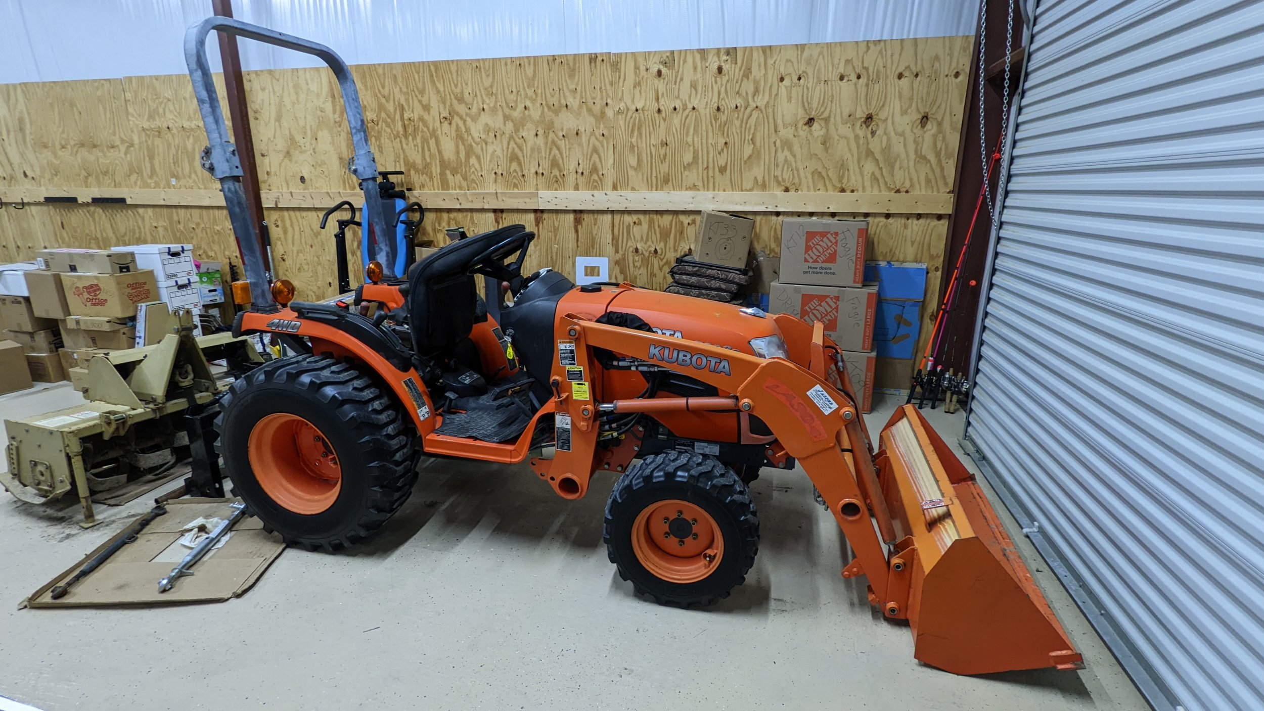

I have a 2009 B2320HST with the LA304 factory-installed Front End Loader.
Let me know what pictures you need.
