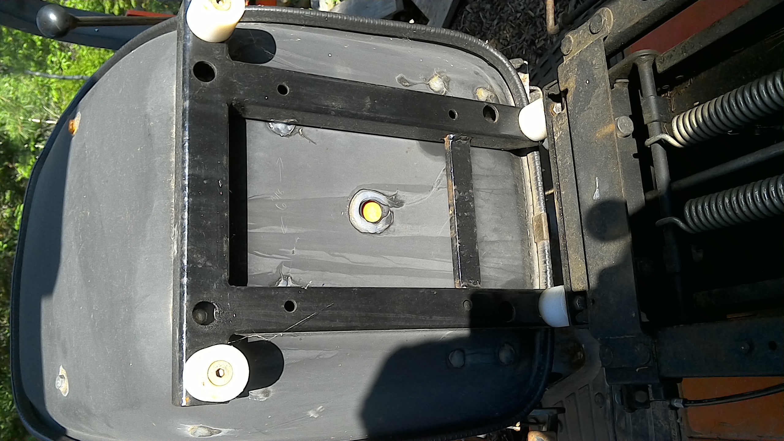

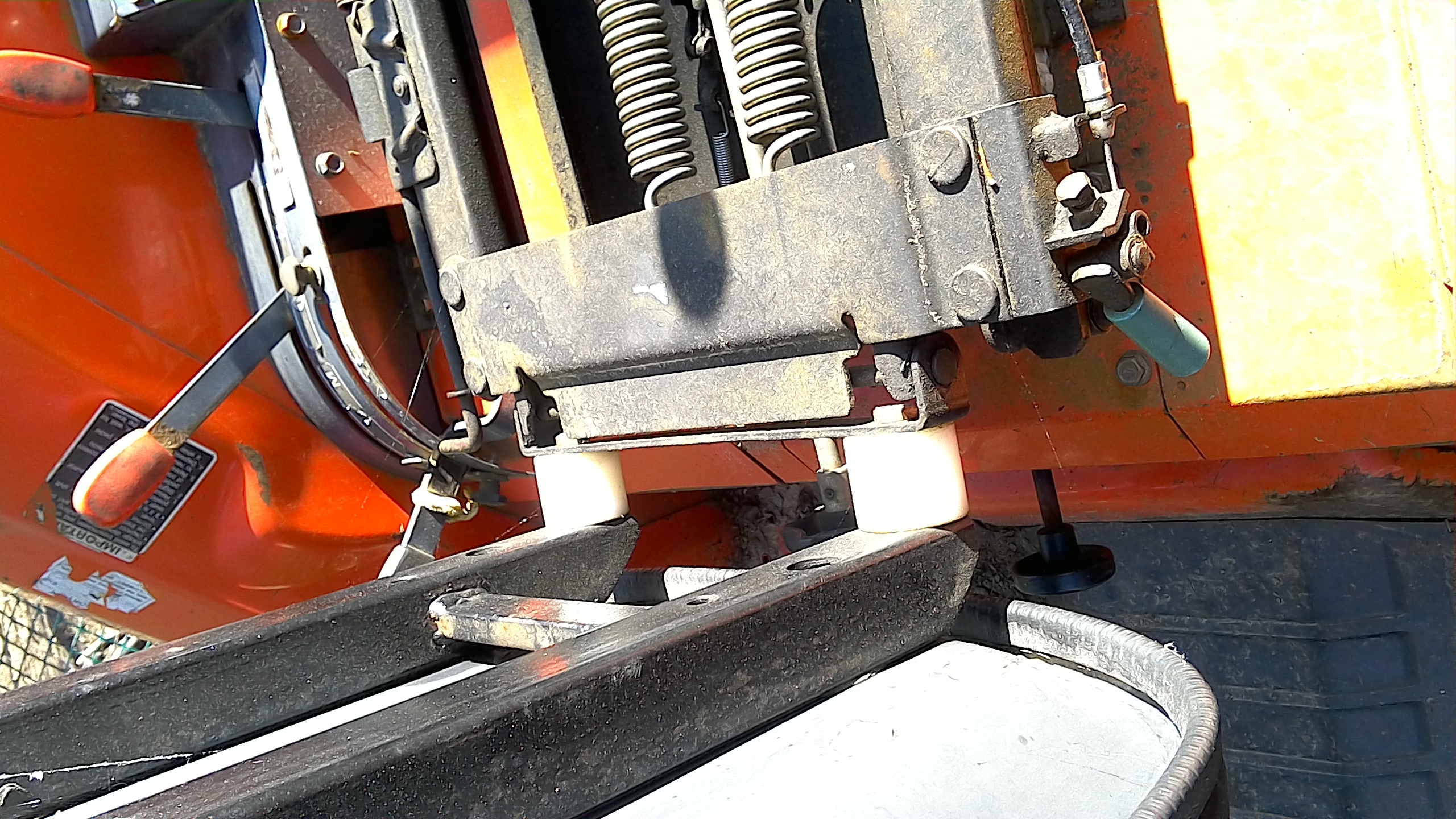

I replaced mine a year ago with one from Princess Auto (Canadian Harbour Freight). I think it was only about $60 on sale. The bolt pattern wasn't a concern, as I had in mind to make a riser/adapter plate anyway. The pictures explain it a lot better but because I'm 6'3" I needed to make things a little more ergonomic! I used 1-1/4" square tube, mounted the front hinge bracket, then drilled and counter bored the holes to match the seat pattern. I purposely drilled them about 2-3" further back than the previous seat to gain more leg room. I was impressed by the room I had gained but needed a little more, so I added the plastic spacers to gain a bit more height. This is so much better now, especially using my heal on the reverse pedal.
If you don't need to gain height, the easier option is to use a 1/4"steel plate. Drill as required and bolt up your favourite seat! If your not that handy working with steel, then head to the local machine shop or welding shop.
Hope this helps!
