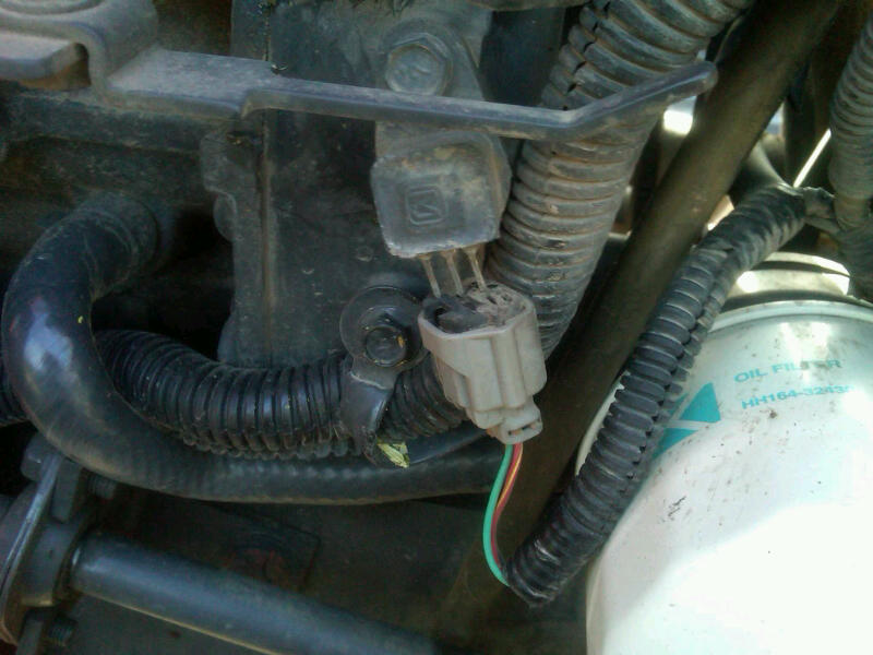

My tractor is showing Error Code 87. Everything seems to be working fine. Anyone know what this code is? Thanks.

Engine rpm sensor has a fault. Likely stall guard will not function.

Could it be the tachometer cable became disconnected or broke? Does it even have have a tachometer cable? Where is the sensor located?

No tach cable. All electric. I will have to look at mine but I think the tach sensor is on the front of the injection pump. Check for loose connectors.

Thanks for the help! Post a picture if possible if you don't mind. Thanks again.

Yes that is were it is, but by the parts list it looks like it goes into the block.

Is it item 50 or 90 in this drawing?
Item: 50
Part Number: T1060-32270 SENSOR,REVOLUTION
Item: 90
Part Number: T1060-18660 SENSOR,REVOLUTION
Or is it shown in this drawing?

You are right. It goes in the block just ahead of the IP.:)
