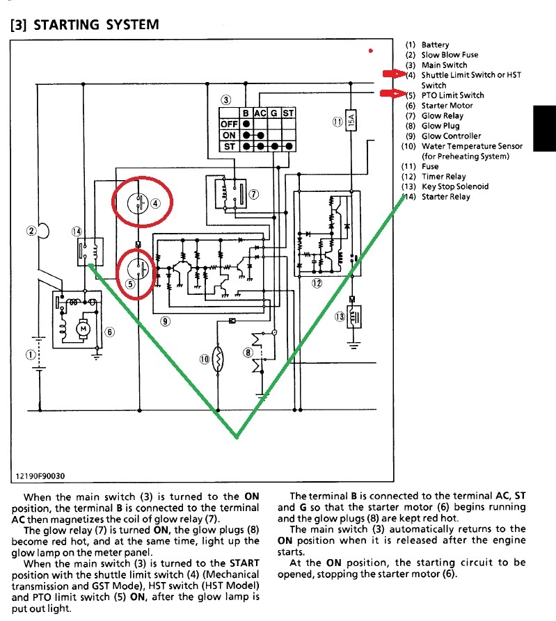

I have a Kubota L4610. I’m an idiot and messed with the wiring on the back of my ignition switch. Now the tractor will not turn off when I turn the key off, forcing me to use the manual fuel shutoff. I cannot find a wiring diagram anywhere that gives me the wire colors for each post on the back off the ignition switch.

Can you tell use what you did with the wires and why?
What year of manufacture is your tractor?
And which of these variants do you have?

Here is the diagram for the start/stop, switch and fuel solenoid.
Go here, you can down load the service maual for free:
   / Kubota L4610 ignition switch #4
The full wiring diagram is buried in there also, with wire colors beginning at page 9M1 for the L10 series tractors.
   / Kubota L4610 ignition switch #5
The fuel solenoid is normally open allowing fuel flow. The way the shut down works is when you turn off the key a timer relay starts that engergizes the fuel shut off solenoid for about 10 seconds starving the engine and shutting it down. Which is not happening apparently. Make sure you didn't blow a fuse.
