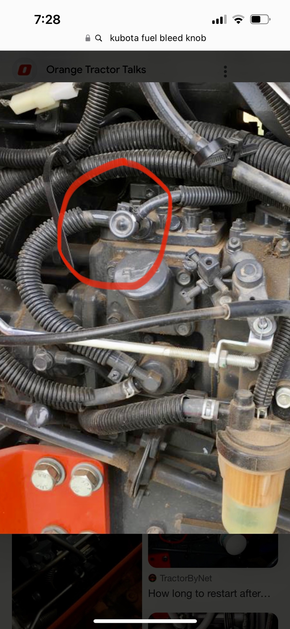

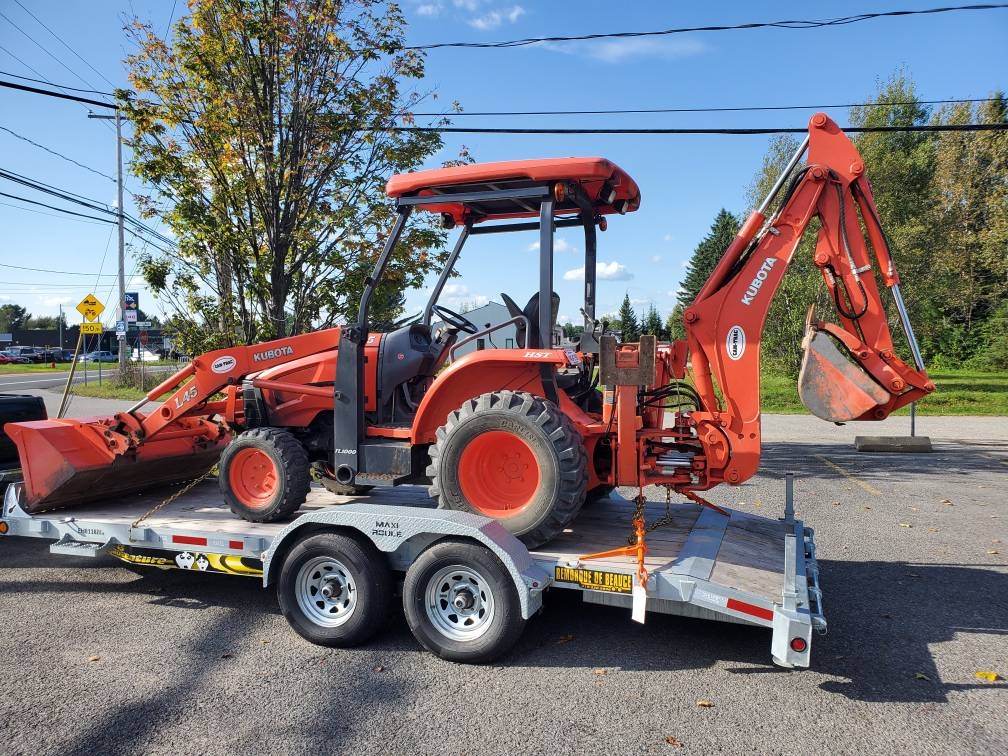

Somebody know how to bleed fuel système when engine stop after an empty fuel tank
   / Kubota L45 #2
There’s a knob on the top side of the injection pump that you can loosen. It’s usually enough by itself without having to loosen injector lines.
