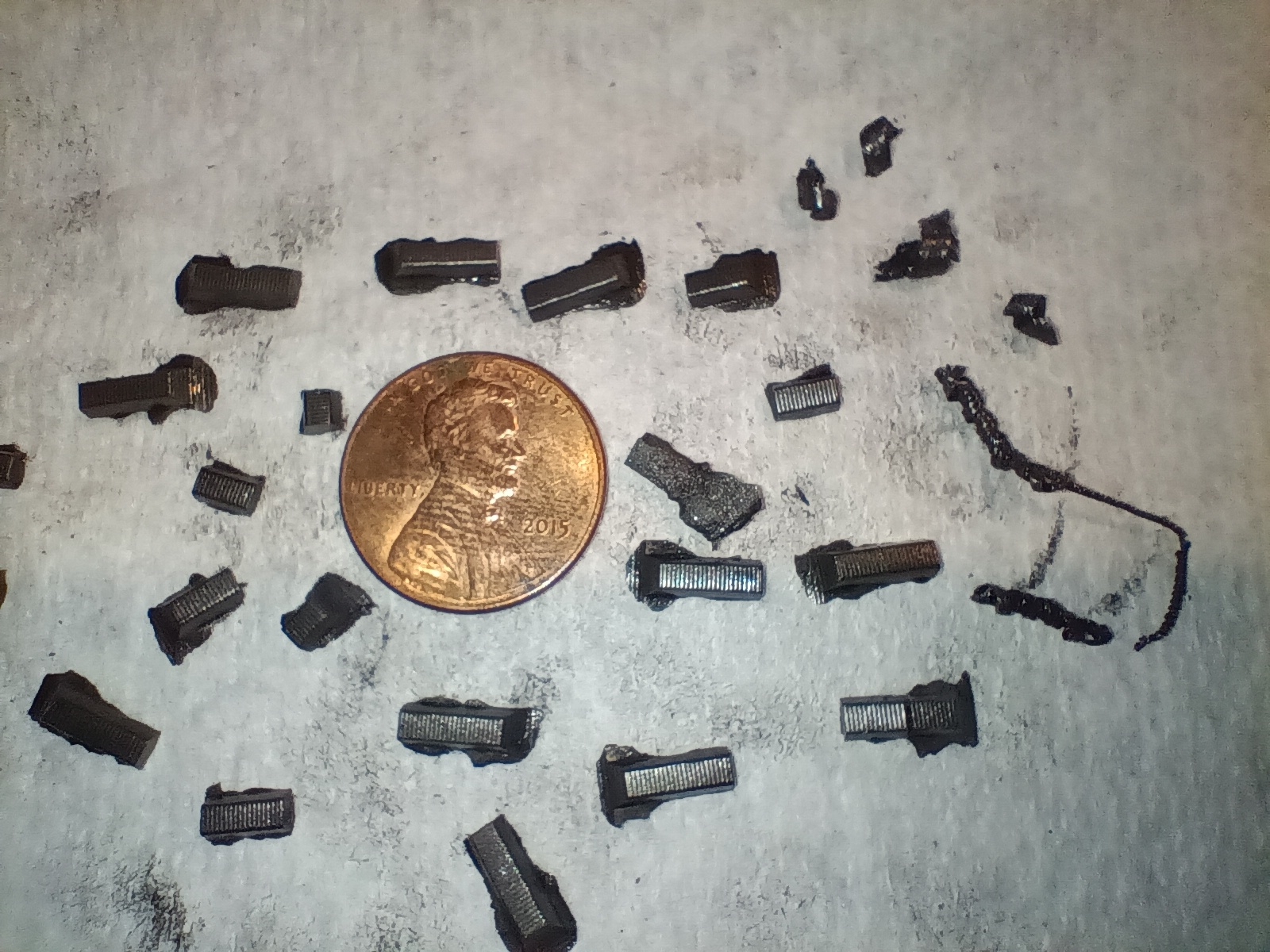

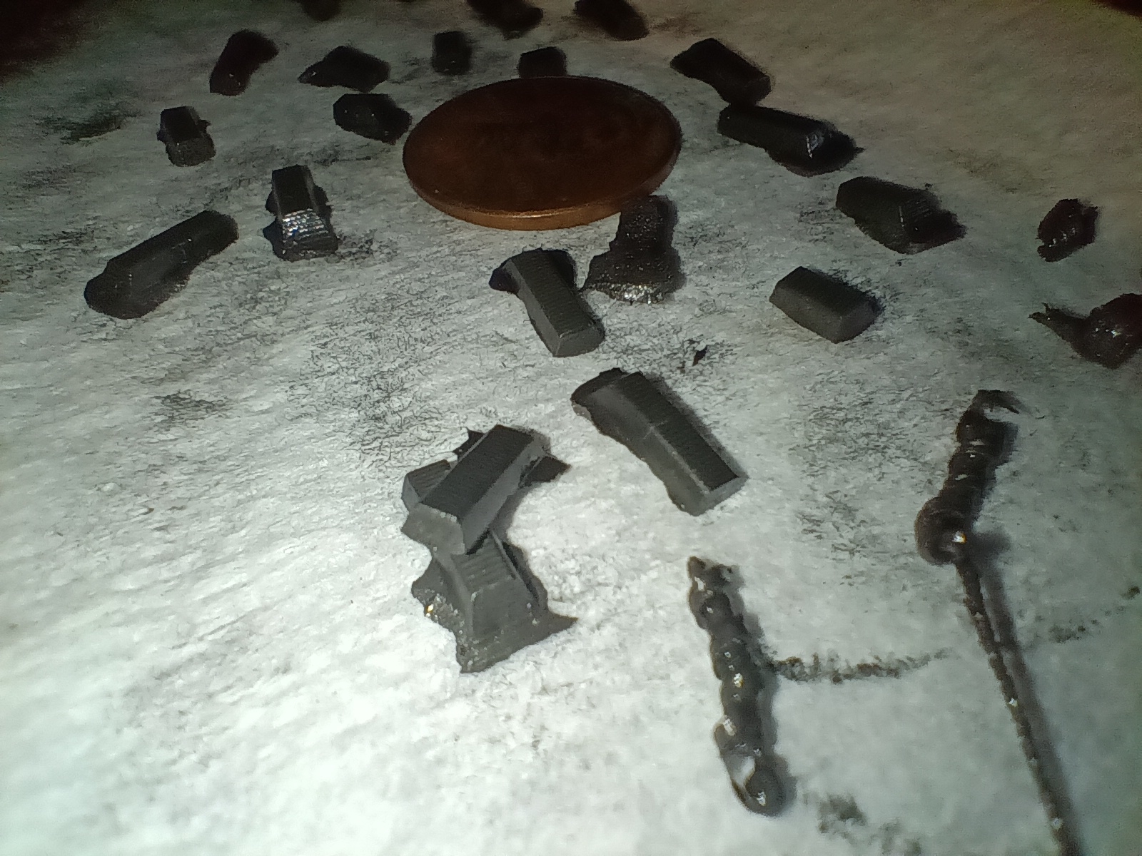

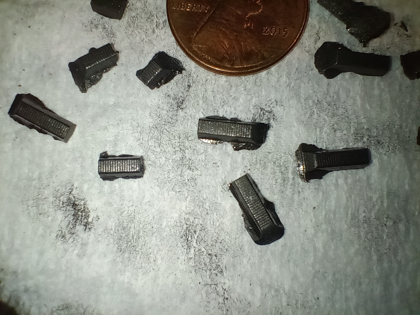

I was changing out the hydraulic filter on my 1999 Kubota L4310 today and it appears that I have gear teeth on the filter magnet. Anyone have any idea what or where these came from? Any help would be greatly appreciated.

Is everything still working? What transmission do you have, it looks like three were available.

To me, that looks more like splines rather than gear teeth. Looking at how the material looks and broke, makes me think it's cast iron.
At first, I was thinking diff lock, but checking the parts catalog and some pictures of the actual parts and it doesn't even have splines there.

I’m not sure how that one is plumed. I’m inclined to want to confine it. I would want to think a good possibility might be the hydraulic pump
Since we bought it used a couple years back, it has always seemed like the hydraulic pressure was not strong enough. It usually needs the rpms raised to lift the bucket loader at what I would consider a normal speed. Not sure if that's normal or not. Other than that we haven't noticed anything not working or having issues. It has the FST transmission.
That was one of the thoughts I had also, as the diff lock has definitely taken some abuse and pops loud when disengaging. Not sure if that's normal or not. Thanks for your help.

That model had optional creeper gears. Does yours have the option and, if so, have you tried using it?

If everything works I woulnt go tearing stuff appart just to find where they came from. A bit clue on where they came from may be where the fluid comes from to get into that filter. Usualy it's on the suction side of the pump.

Yikes! Scary to find that in your fluid. I'd certainly keep a close eye on things, but as long as everything is working ...................? I'd sure take a look at that filter magnet again after a little use.
