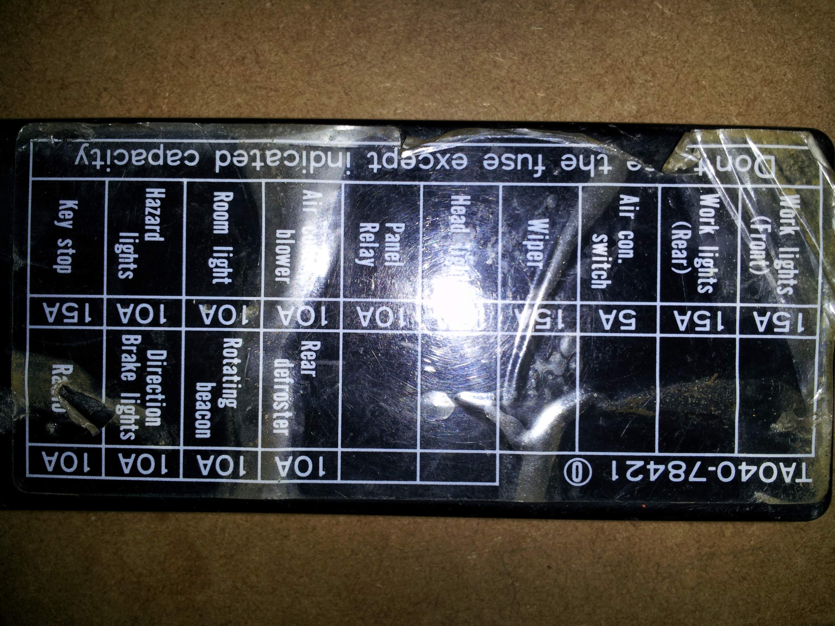

My L4200 has no fuse box cover and the service manual doesn't show whats what
for the fuses.
If anyone would be so kind, when time permits,,
as to take a picture of their fuse box cover, so I can see what fuse does what,
I would appreciate it.

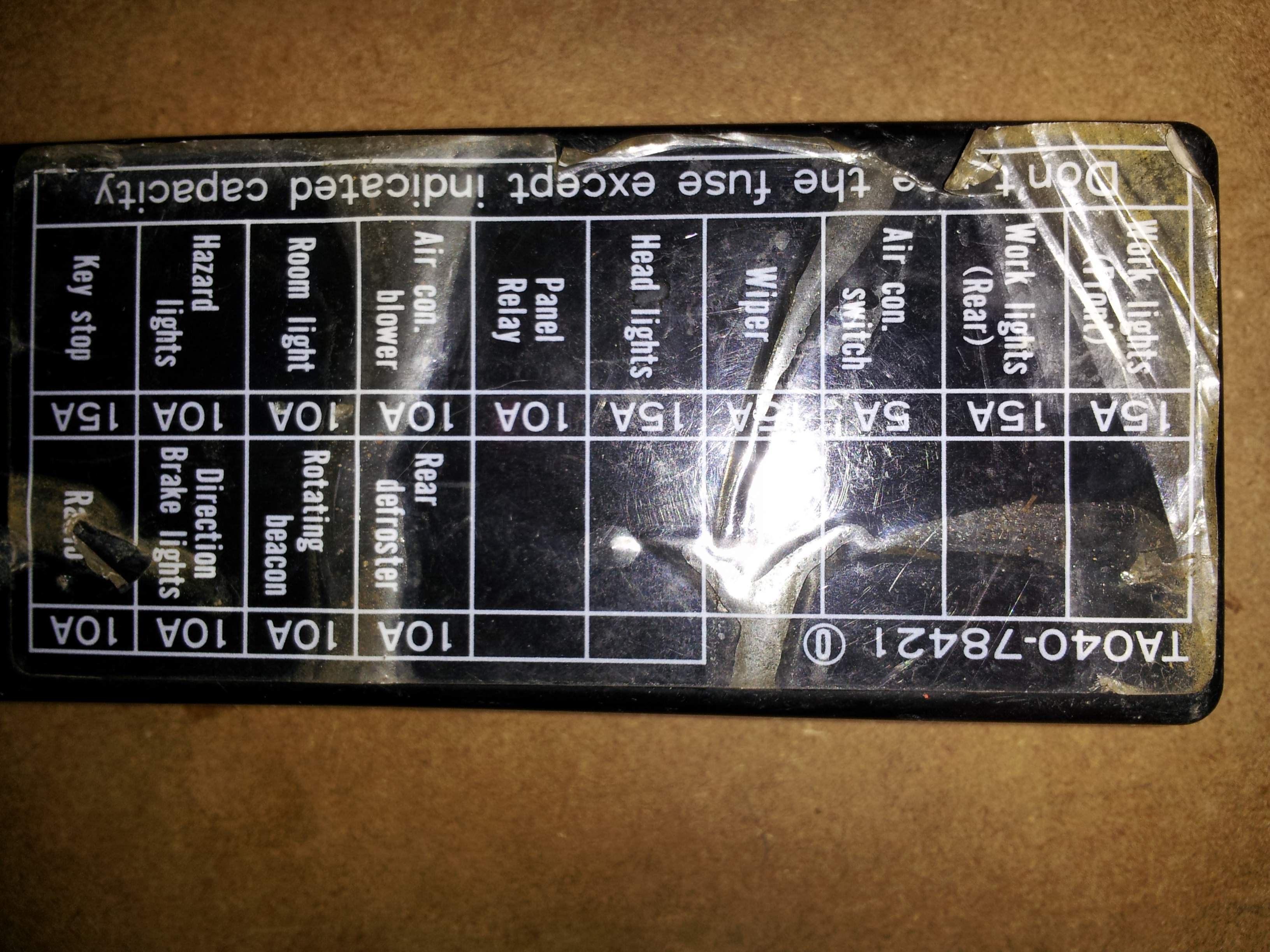

   / Kubota L4200, Fuse box cover, photo needed #4
Here is a pair of pictures of the fuse cover, Little glare on it but if you cant read, let me know I will type locations, fuse size .... KennyV
Perfect, thank you so much, Kenny.:thumbsup:
much appreciated, Rick.
